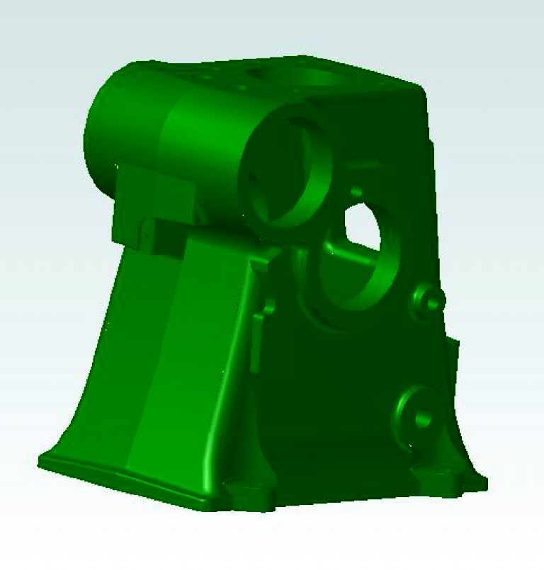

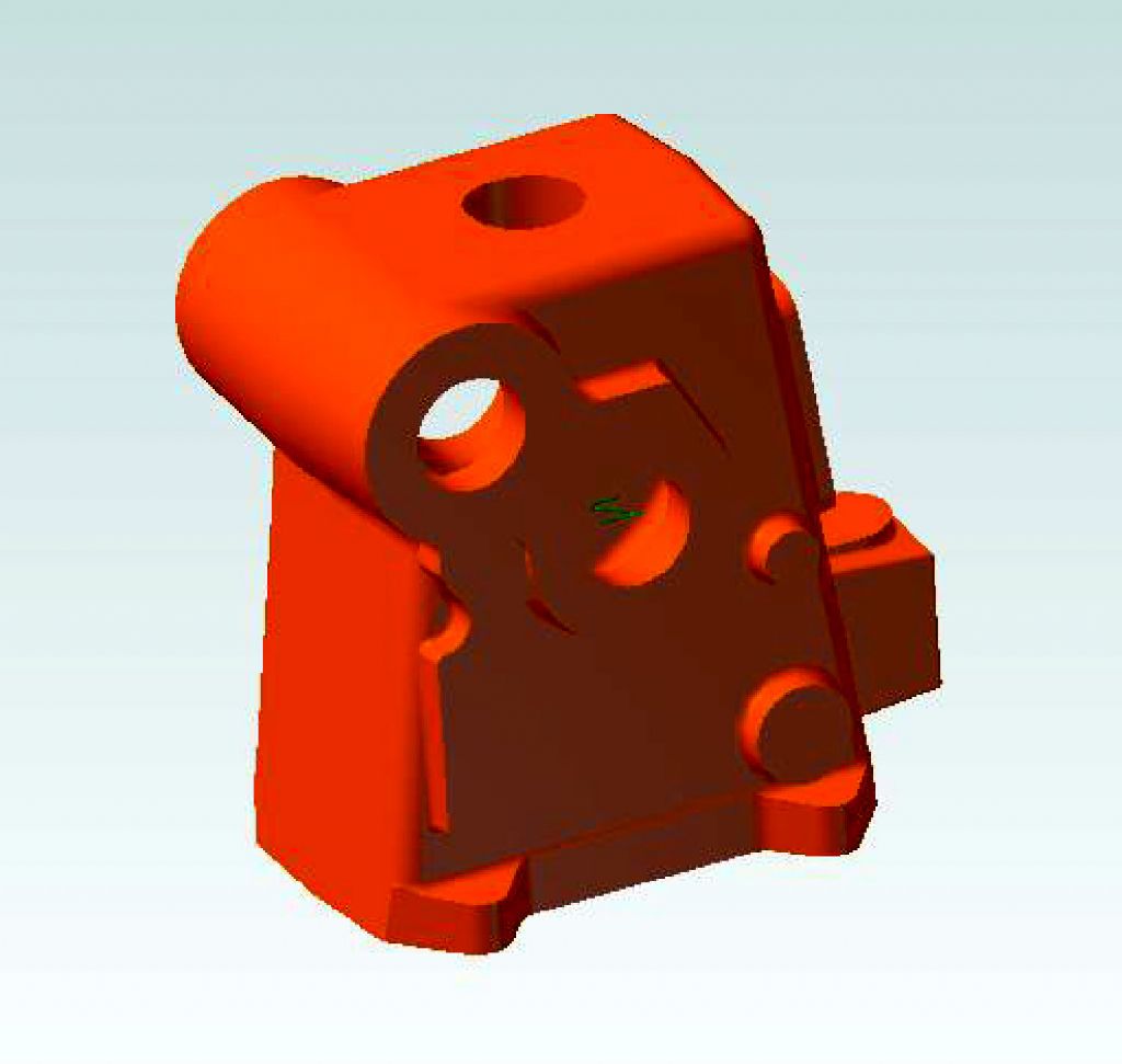

      This is my design for the Lister Diesel Engine Crankcase Casting from Vol. 210 No. 4448 – 25 January – 7 February 2013. I intend to manufacture the patterns and core boxes using my CNC equipment,crankcase 1.jpg

        #111379
          Nice rendering and judging by your other photos a very nice pattern should follow.
          Bit hard to tell from the above but have you added machining allowance to the surfaces that need it or will you produce another version with them included before it goes into the CNC?
          Do you also do your own castings and if so what metals can your furnace handle.
          Look forward to some pictures of teh pattern being made.
          J
          #111383
          Ennech
            @ennech
            Thanks for the compliments!.
            Yes I have included machining allowance of 3mm on machined faces.
            I use the basic model as shown and develop the pattern from it scaling up for shrinkage and adding core prints etc., and then feeding that into another program that works out cutter paths.
            I intend to make both aluminium and grey iron castings as I think that iron was the chosen material for the original.
            I don't cast them myself, I have a good small foundry in my locality.

              Just out of curiousity what scale are you building it to and what model, I collect full size Lister's and my L type has the same crankcase base.
              Martin P
              #111393
              Ennech
                @ennech
                I have designed it to the dimensions given in Model Engineer, ie 1/6 scale

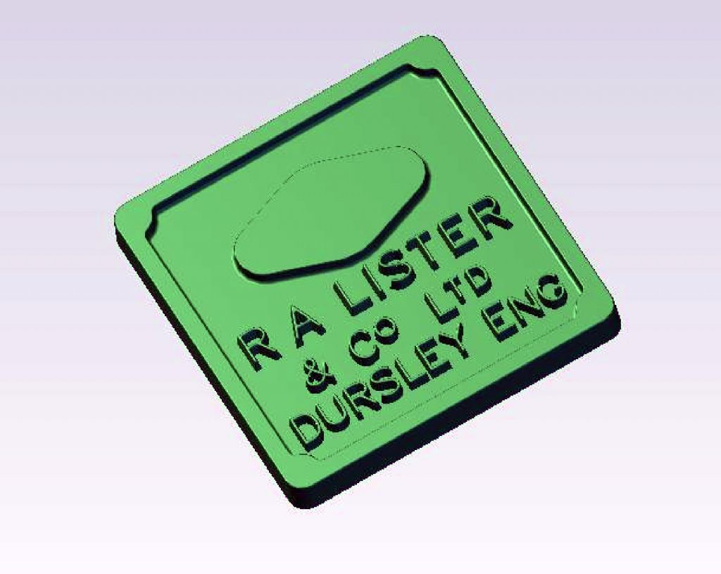

                  #115886
                  HobbyNut
                    @hobbynut
                    I sure would be interested in 1 of those cover plates.
                    #115892
                    Ennech
                      @ennech
                      I have not yet produced the pattern. I am thining that the best option will be to make the pattern by 3D printing. I will let you know how it proceeds. Eric

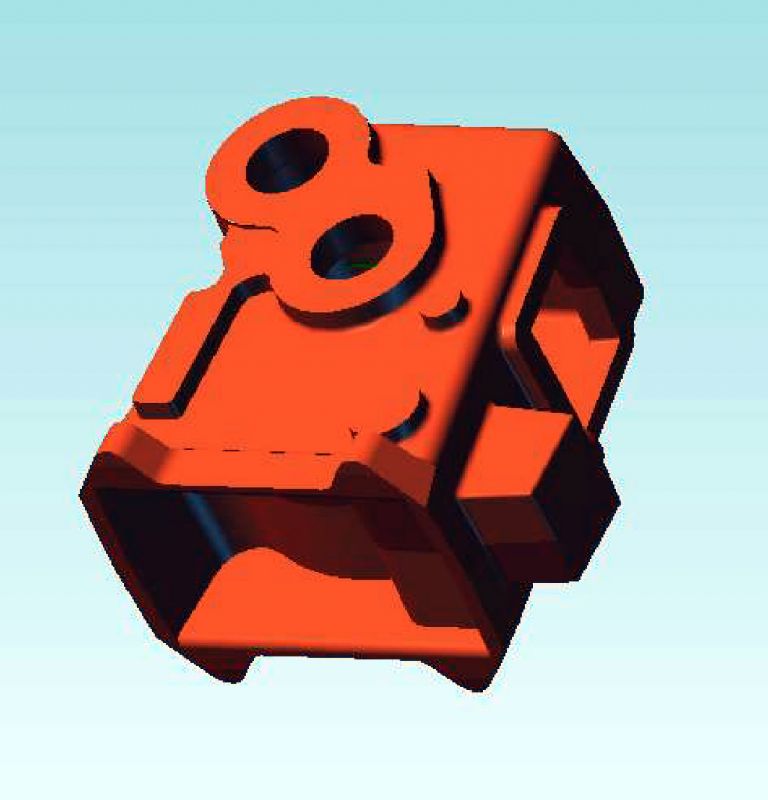

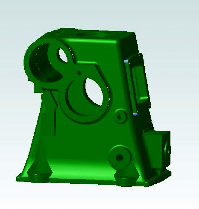

                          crankcase f2.jpgI have modified the casting design to flare out the base to be a truer representation of the full size Lister CS 6-1 engine.
                          I have also increased the vertical distance from the base to the crank centre to give clearance for the flywheel.crankcase fl 1.jpg

                          Jeff Dayman
                            @jeffdayman43397
                            So what is the base to crank centre dimension on your revised casting design?
                            #117780
                            Ennech
                              @ennech
                              Hi Jeff. The height from the machined base to the crank centre on my design is 80mm.
                              In the original design according to Jason's thread was 77.13 which results in an interference of 0.87 with the OD of the flywheel.
                              Eric

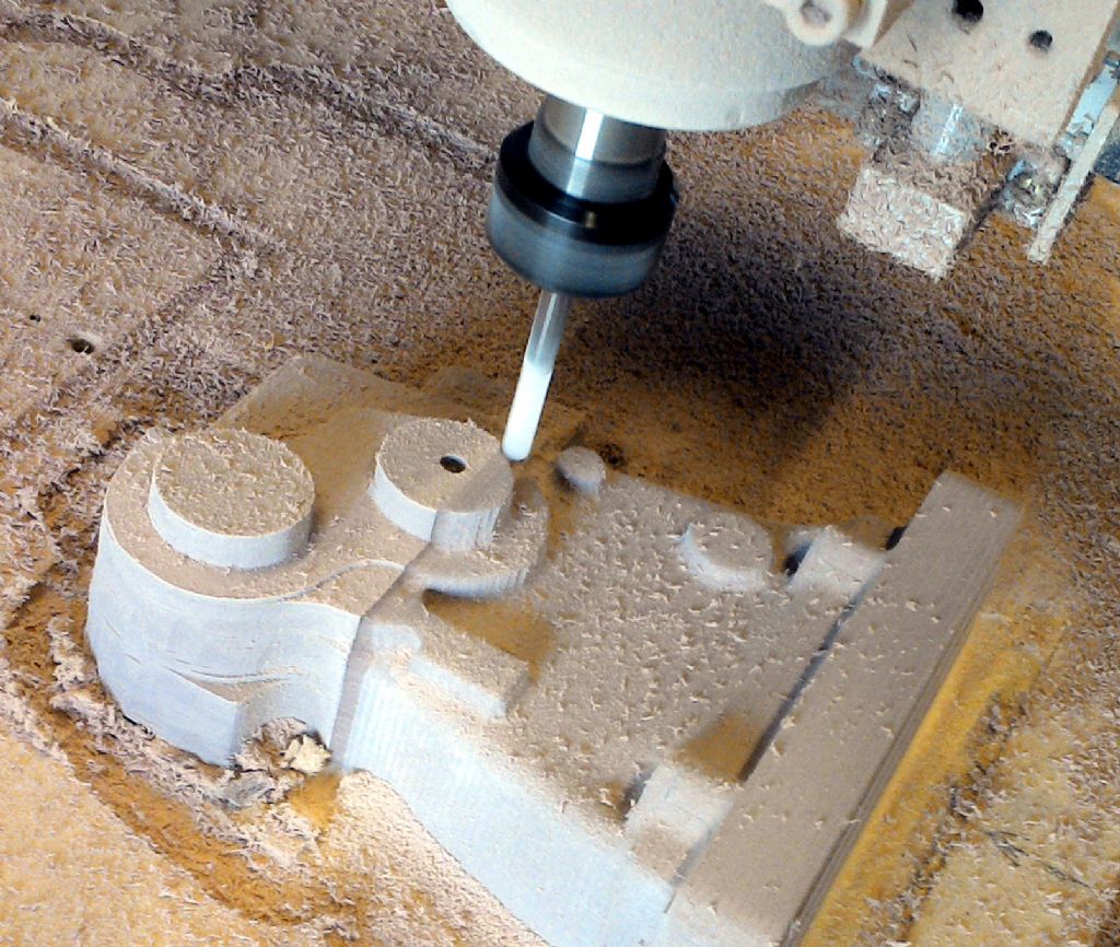

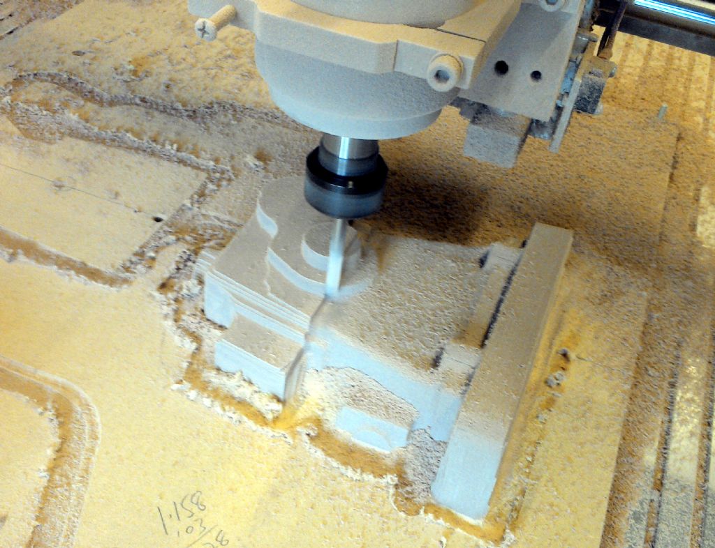

                                  Machining the back half of the crankcase pattern
                                  #118550
                                  Ennech
                                    @ennech
                                    Machining the pattern front half.

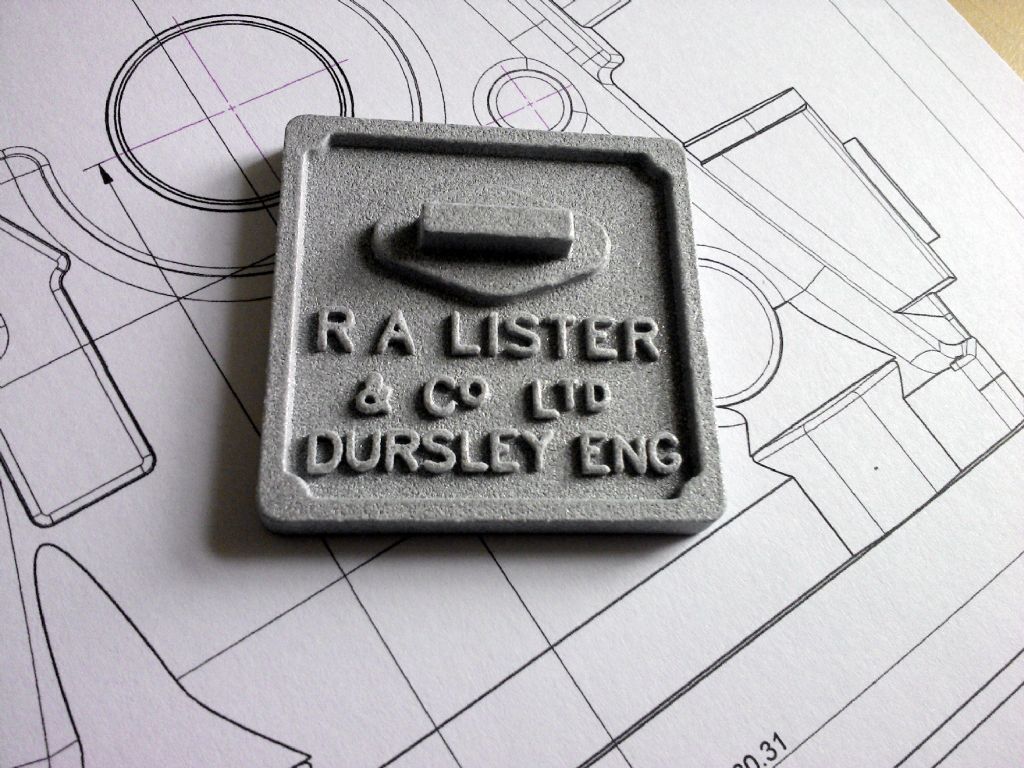

                                      Just arrived the 3D printed pattern for the nameplate. I have added the chucking boss to facilitate machining the back of the casting. Now to see how well it casts!nameplate patt1.jpg

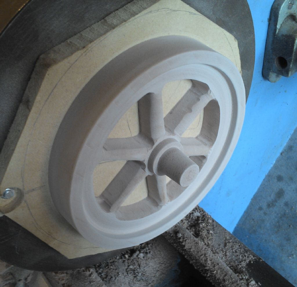

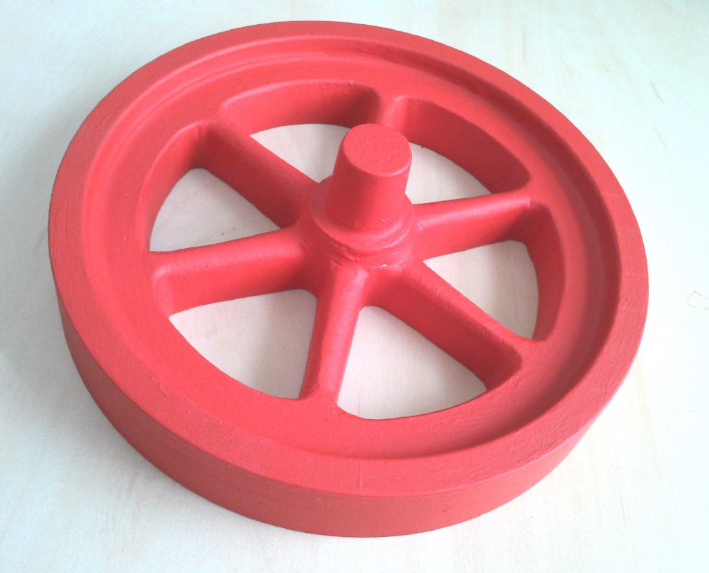

                                        Truing the flywheel pattern on the lathe after the CNC router. I have included a chucking boss.flywheel patt.jpg

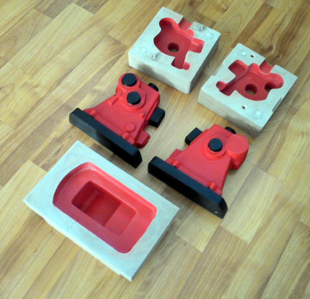

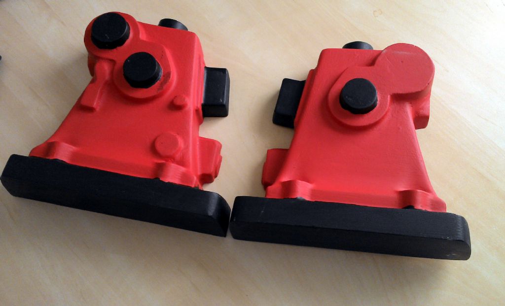

                                          Crankcase pattern halves finished
                                          Crankcase pattern and core boxes
                                          Flywheel pattern
                                          #120206
                                            Eric is that half of the flywheel pattern as itf it is it looks like you will get some very oval spokes when they should be almost round to oval in the opposite direction
                                            I'm also not sure about those scallops above the feet as I've not seen them on full size engines such as this
                                            Lister6/1
                                            #120207
                                            Ennech
                                              @ennech
                                              It is the full pattern. I decided that if I attempted a half pattern approach there could be mis-match on the spokes which apart from looking bad would weaken the casting. The flywheel is designed to be recessed at the other side by machining.
                                              The scollops are there to enable me to flare the casting bottom and still be in scale for the feet dimensions. I decided the scale by comparing the OD of the flywheel with that of the full size Lister CS and decided it was a scale of 1/4. The feet spacing on the original is 13" and so that the spacing on my casting is 3.25"
                                              Eric

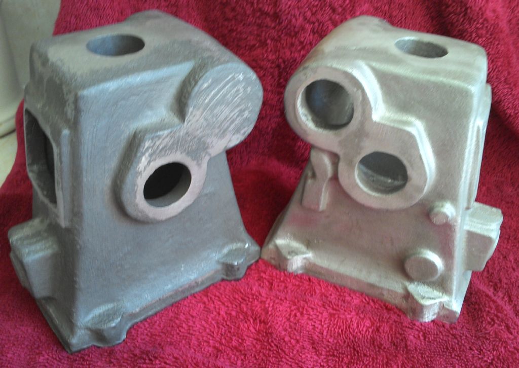

                                              Ennech
                                                @ennech

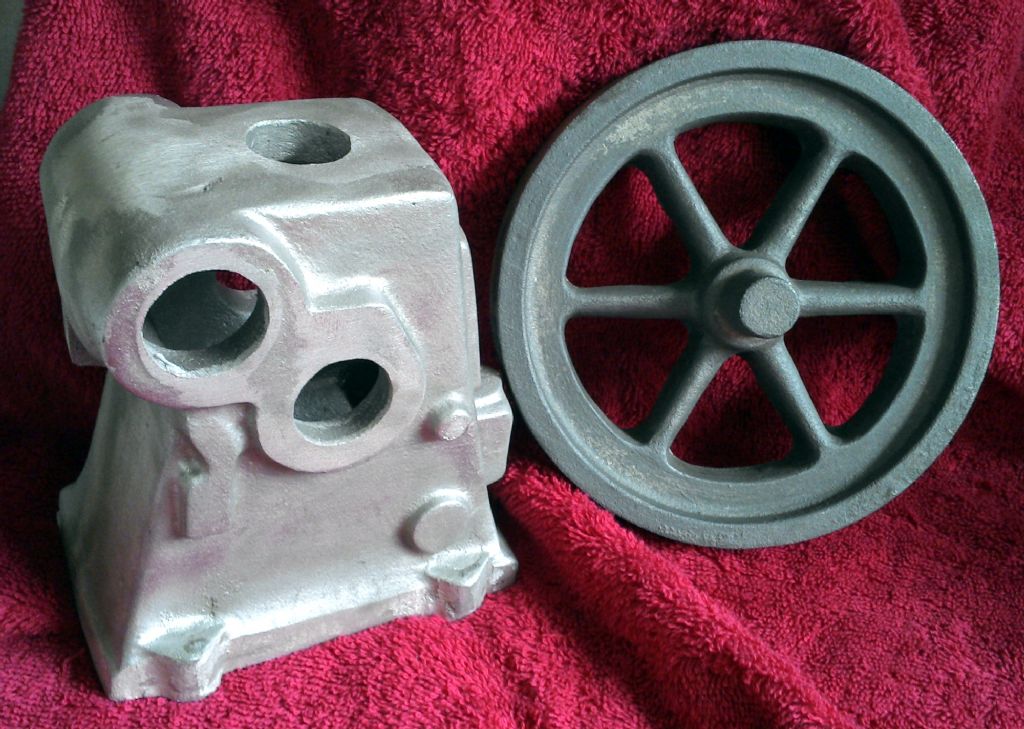

                                                Crankcases direct from the foundry in iron and aluminium
                                                Pair of cast iron flywheels
                                                Crankcase and flywheel
                                                #120502
                                                  They have come out nicely, infact you can hardly spot those scallops above the feet now, probably they caught the light on the 3D renderings.
                                                  J
                                                  #120503
                                                  Ennech
                                                    @ennech
                                                    Thanks Jason, yes the scallops blend in nicely. The foundry did a good job on them and very quick too.
