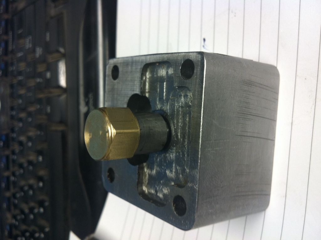

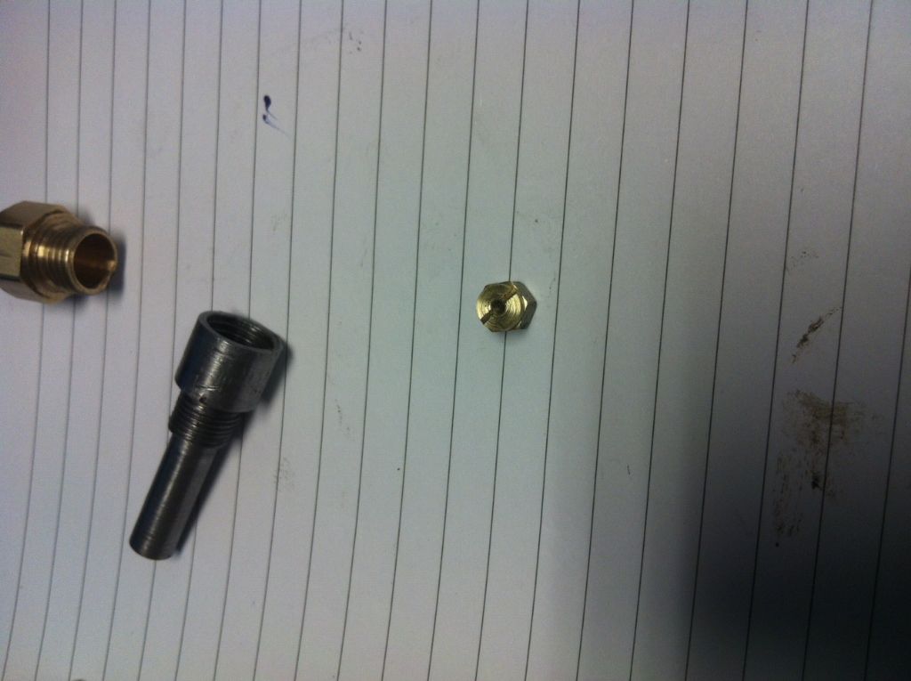

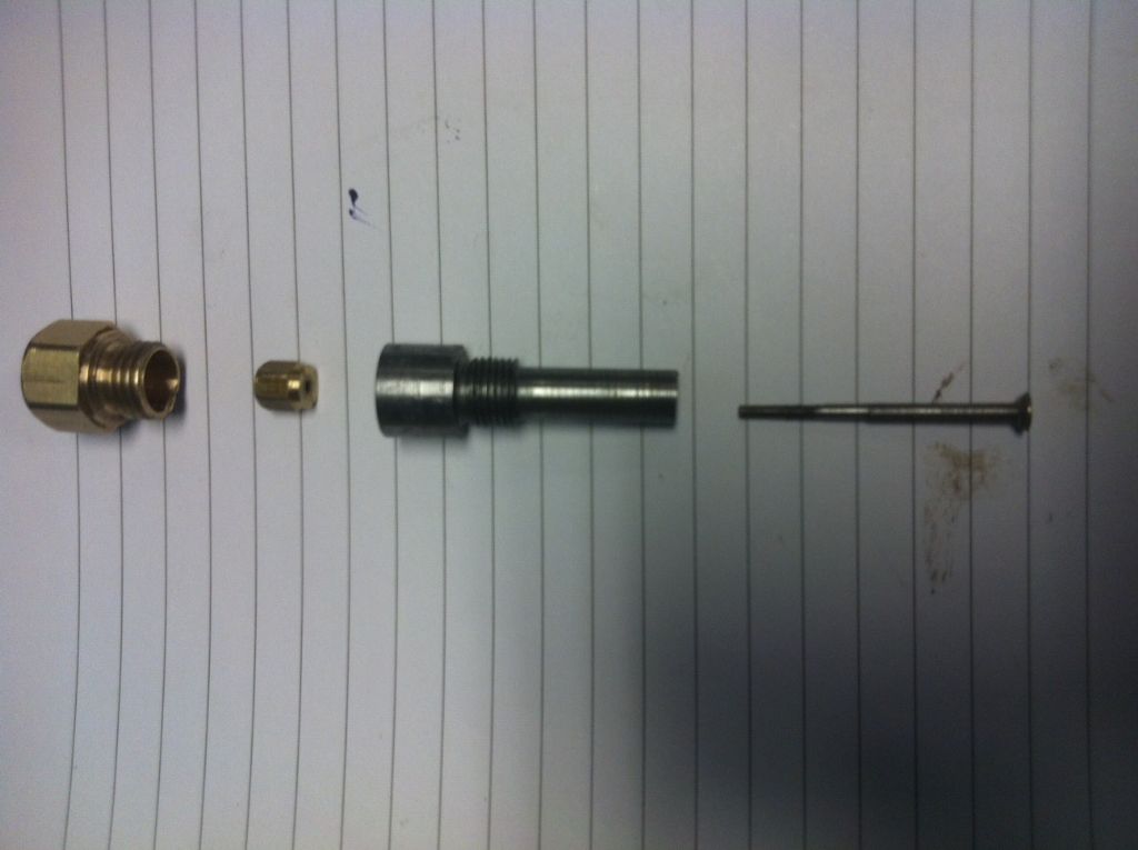

      The "DUX" injector is a simple thing. it has no moving parts, and is basically a valve in a body. The valve face is lapped into the seat, and then a "scratch" is made across the valve surface to create a "leak". This scratch becomes the orifice. Because of its minute size, it apparently does not affect the compression any appreciable amount. I have made this from Silver steel, threaded it into the head, and the valve is Silver steel with a .188" dia head, a 2mm dia stem and 2mm-.4 thread at the top. The nut is 3/16 hex.
      The theory of operation is that the fuel makes its way down the stem and out the scratch at each pump stroke. The valve body is drilled 2.1mm dia. and I filed 2 small slots into the u/s of the nut.
      Pics soon.
      #129063
      HobbyNut
        @hobbynut
        injector in head.jpginj nut us.jpginjector parts.jpgThe pics I just uploaded.
        #130032
        HobbyNut
          @hobbynut
          Tested the pump tonight….it puts out 344Kpa, 50psi, 3.44Bar. Is it enough? only time will tell..
