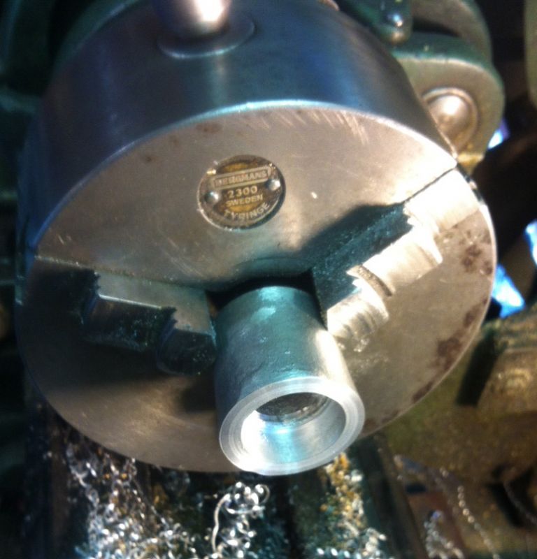

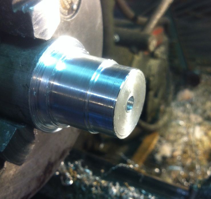

      I was sent a casting for a Lister piston by Ennech. He also emailed me the machining details.
      I set it in the lathe and made the internal bore to size, so that I could set it on a mandrel.
      I then took a piece of Alum bar and machined a mandrel
      #31027
      HobbyNut
        @hobbynut
        #128267
        HobbyNut
          @hobbynut

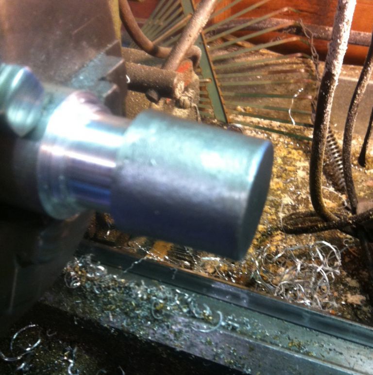

          The piston was then locktited onto the mandrel

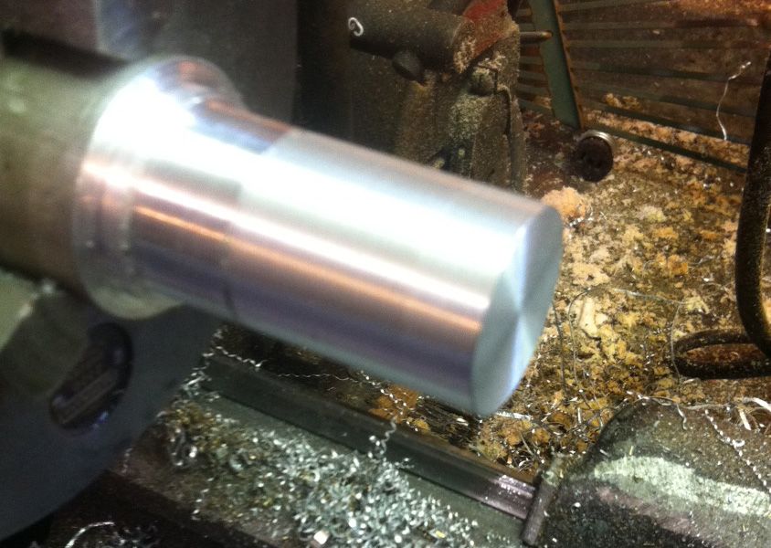

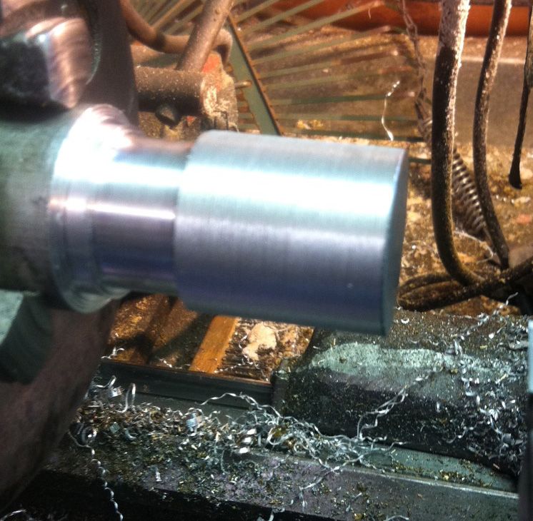

          Then a cut was taken, and machined down to 28mm dia.

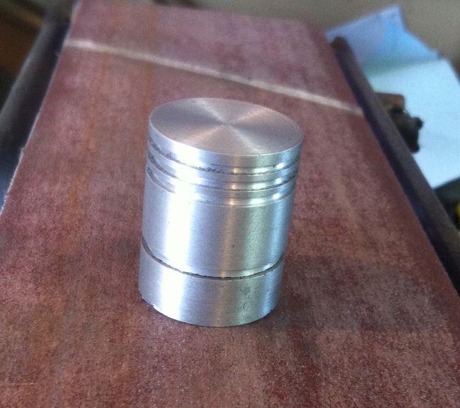

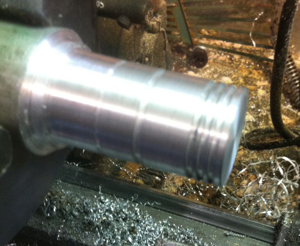

            The ring grooves were then machined, and the OD polished with some 240 W&D.

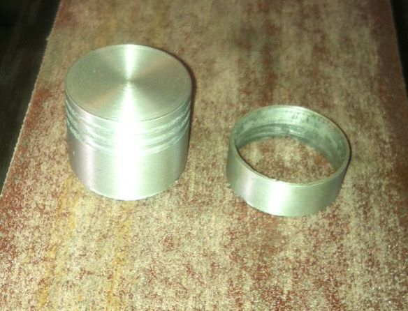

              Unfortunately this did not end well. When I heated the skirt with my pencil torch to break it free, the piston and skirt parted ways at the lower ring groove. On inspection, I had gone 1 mm too deep on the id from the base of the piston, making that area too thin.
              The casting was not at fault, I was, and the piston was a joy to machine, with only a few very small pinhole air pockets in the casting.
              Oh well, I tried.

                The final pics.

                  After all that good work on the piston, why not have the only Lister fitted with a Slipper Piston.wink
                  Stick.
                  #128285
                  Ian S C
                    @iansc
                    Been there, done that, with the labyrinth grooves on a hot air engine piston, made the grooves .020" deep, instead of .010", I make the skirts of my pistons usually no thicker than .040", and if possible a little thinner. Just part of the job! Ian S C

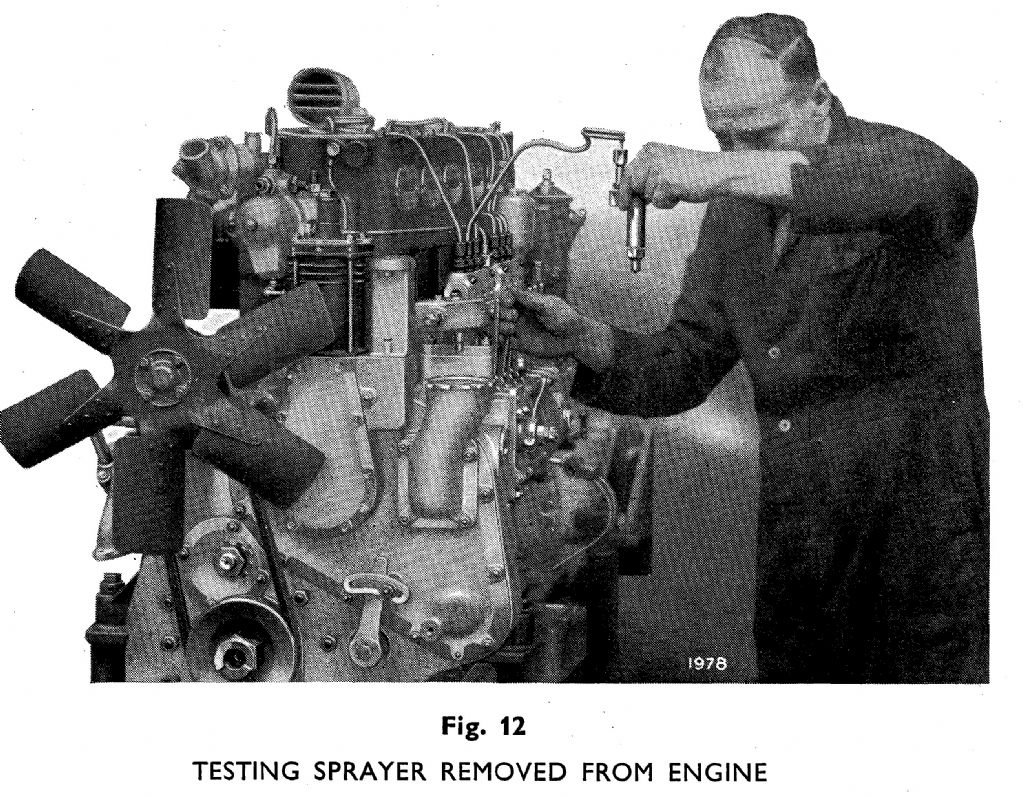

                                            How are you seeing what the spray pattern is like as you need to see whats comming out at the pressure inside the combustion chamber. Pumping into open air will not show how the injector works inside the engine.
                                            J
                                            #129012
                                            Ennech
                                              @ennech
                                              Picture from Gardner LW Instruction Manual (don't do this at home)
                                              #129014
                                                That really only shows that there is no blockage in the lines.
                                                Without testing the injector under pressure you won't know if the pump is producing more pressure than the engine compression or what the spray pattern is like.
                                                J
                                                #129025
                                                Gordon Wass
                                                  @gordonwass
                                                  Testing the injector spray pattern outside the engine is standard full size practice ,in my house anyway. True it will not be the same under pressure but it's a good start. I don't know what sort of pump / injector you have made, can't imagine it even, but the relative bore sizes should give a good idea of press. differences, similar to a steam injector ?

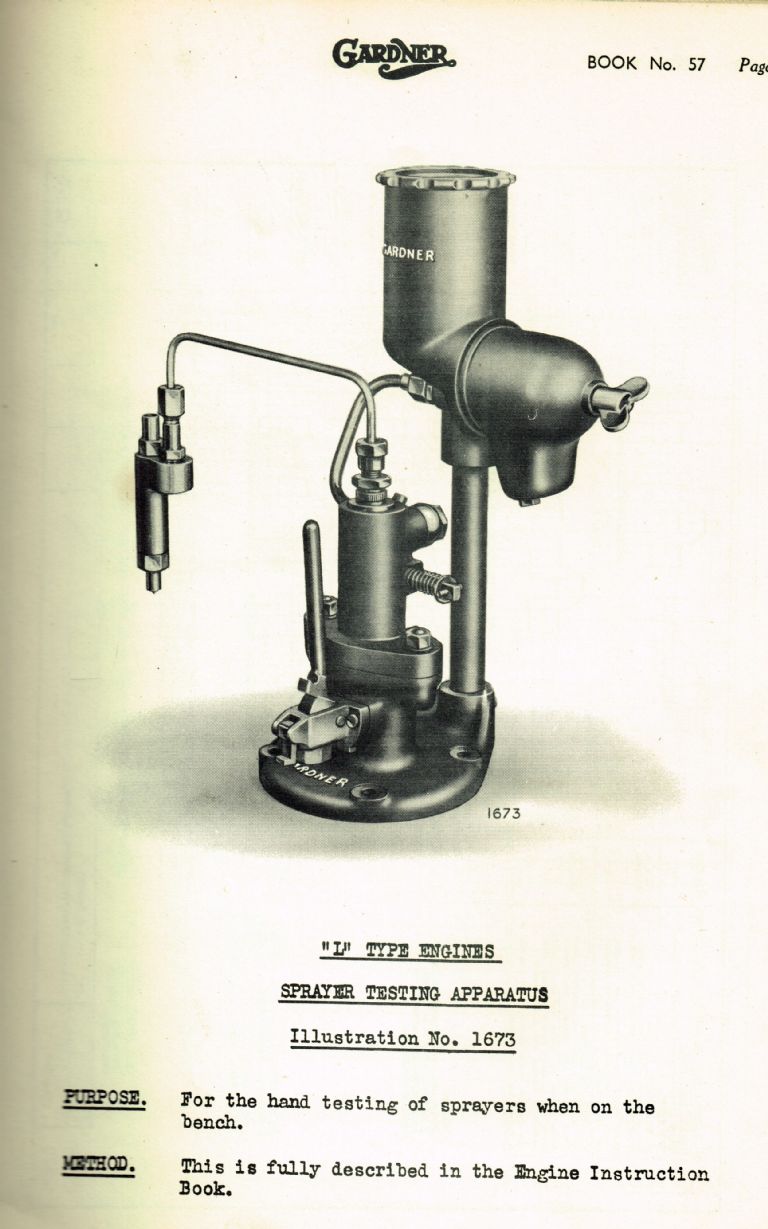

                                                  #129026
                                                  Ennech
                                                    @ennech
                                                    You could easily rig up a test rig by using a brake master cylinder and pressure gauge you will get away with it for a short time before the seals swell.
                                                    #129030
                                                    Ennech
                                                      @ennech
                                                      The Gardner LW injector (sprayer) operates at between 1935 1md 1960 psi when new.
