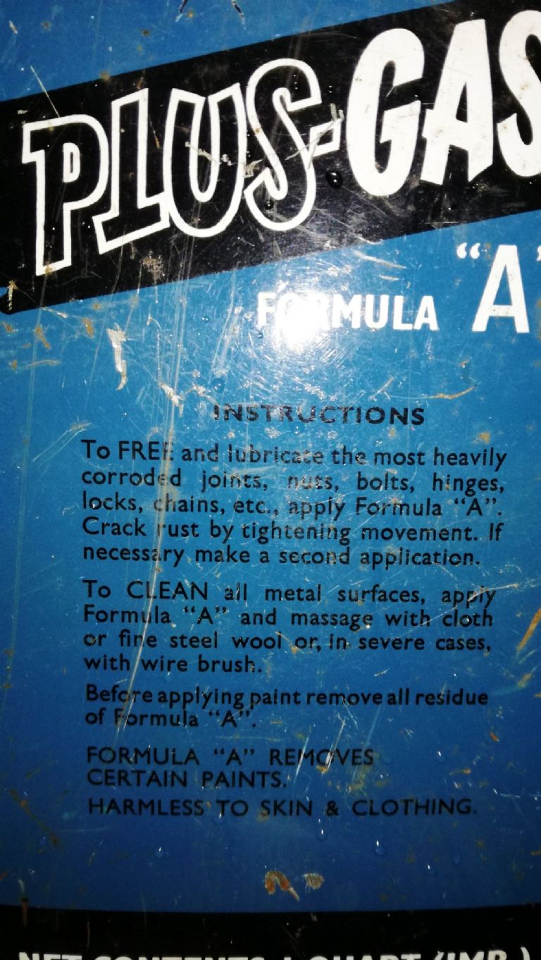

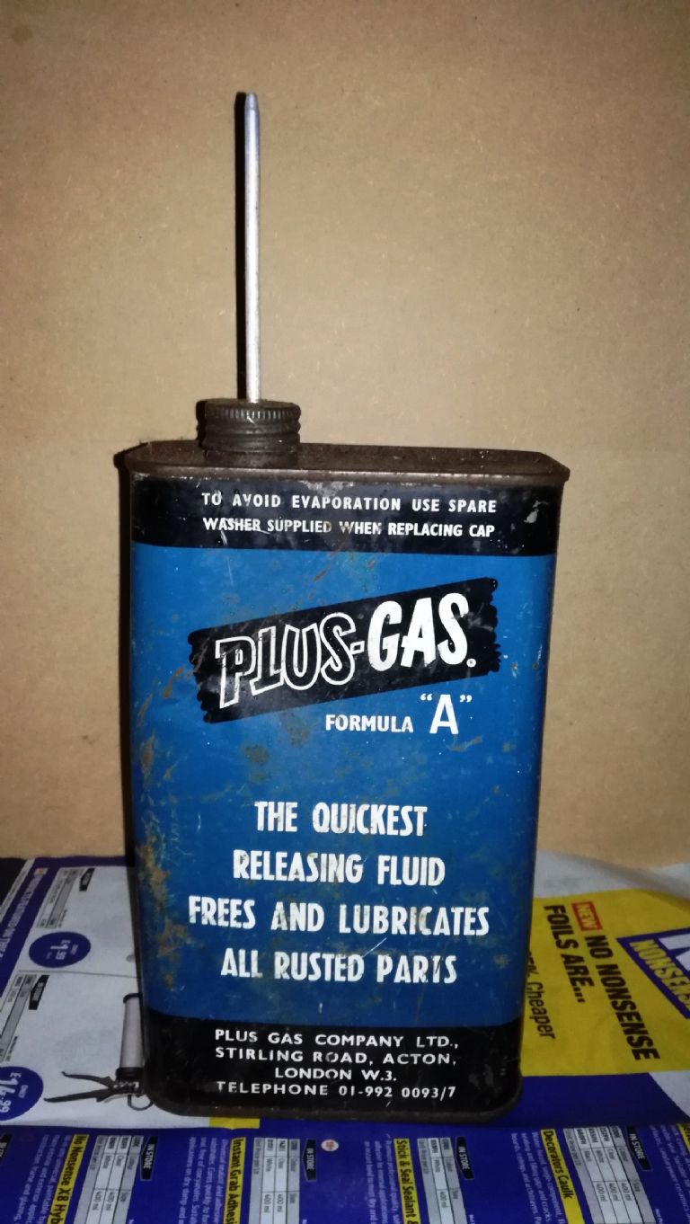

                                                  Nicholas Farr
                                                    @nicholasfarr14254
                                                    Posted by Mark Rand on 30/03/2022 13:53:43:
                                                    Screwfix's web site only shows the aerosols at the moment…
                                                    snip
                                                    The tins just aren't out there at the moment. maybe they are waiting for a container load of plastic spouts from China!
                                                    Wot!! quality downhill, used to have it at the company I worked for years ago and although they did have a few quart size tins with the ally spout that you turned upside down into the tin and held in place with a sealing washer and the screw on cap, but they mostly had a drum in the stores which the storeman would fill your own container, which for most blokes was a tubular washing up squeezy bottle, which often had the name Fairy on it.
                                                    Regards Nick.
