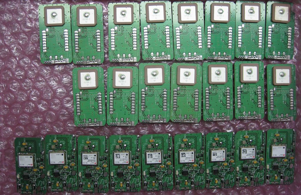

      GPS Tags
      IRIDIUM SAT Tags

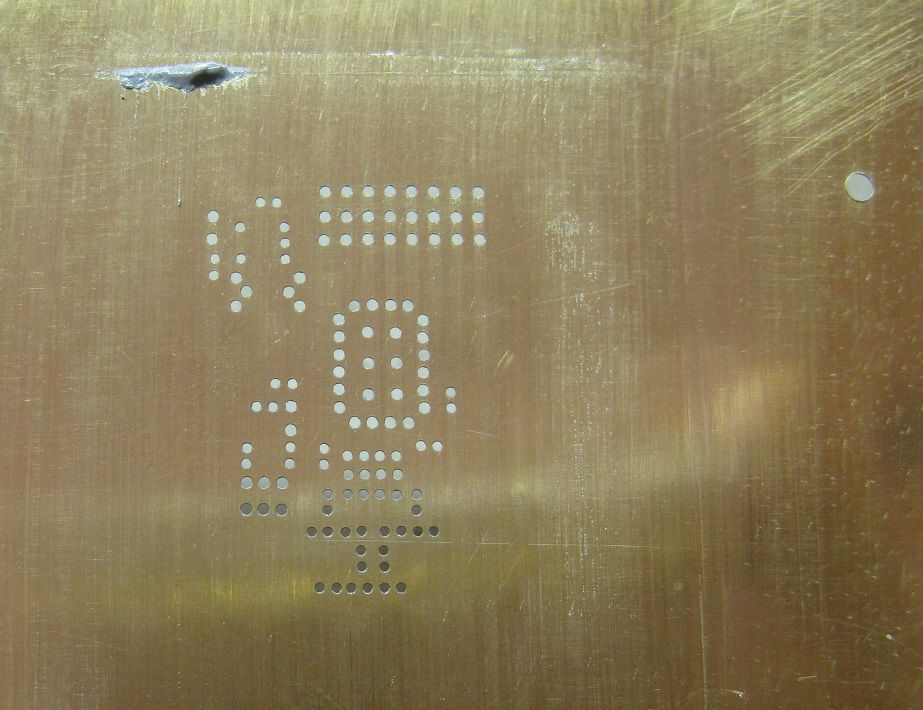

      Solder Paste Stencil – Brass shimstock

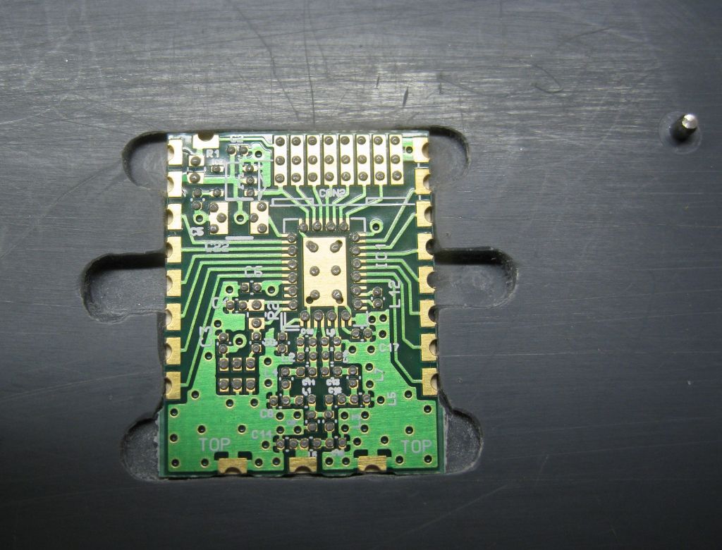

      Paste applied to RF Tranceiver module, ready to place tiny electronic parts!

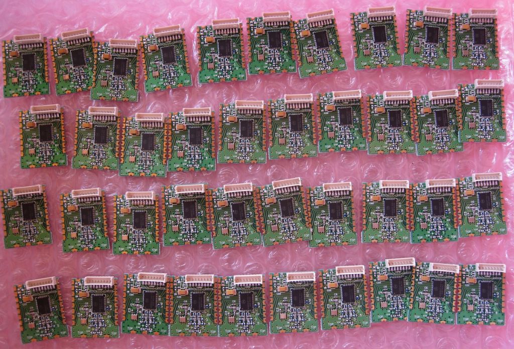

      Many RF Transceiver modules assembled..

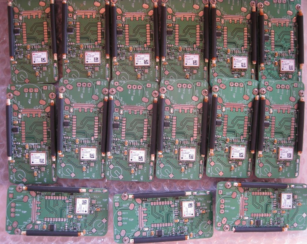

      Many collars in progress..
