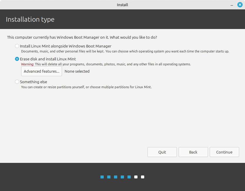

      #779073
      Journeyman
        @journeyman
        The installation process should be straightforward, no need to partition the disk before installation the install program will do all that for you.
        1. Download fresh copy of Mint there are three versions Cinnamon, Mate and Xfce. Cinnamon is most like Windows current version is 22.1 (xia)
        2. Make the downloaded .iso file bootable using balenaEtcher or Rufus
        3. Make sure that the PC will boot from usb, may need to go into the BIOS to set this up
        4. Turn the PC off, insert USB drive and restart PC (There should be no black screens or flashing menus) should boot straight into a running version of MINT
        5. You can explore Linux Mint or to see if you like it. If you decide to go ahead there is an Install Icon on the desktop
        6. Click on the install and the machine will go through a series of menus for the usual Location, Timezone, Connect to WiFi and then it will arrive at the options screen.
        7. install
        8.  Select Install alongside Windows . This will partition the disc and set the space for Linux and leave sufficient space for Windows. If you want it to do anything special choose the 3rd option -Something Else
        9. Wait while it installs 20minutes or so.
        10. It will tell you when to reboot and remove the USB. When it starts up you should be offered the choice between Windows and Linux.
        Hope all goes well if not try the Linux Installation Guide
        #779075
          Hi Hans,
          I think the mistake was creating L:
          That’s a partition allocated to Windows, not free for Linux, and it may have confused the installer.  You don’t need to create an L: Better to let the installer organise the disc, no need to do it yourself.
          I can’t remember exactly how, but with a partition tool in Windows delete L: and allocate the space to C:  Then boot Windows and conform C: is full size.  The disc needs to be fixed – no L:
          With L: gone run the USB Linux installer again.  What it does is scan C: to find how much of the space available is consumed already by Windows, and then it offers to repartition the disc.   So if it said C: was 100Gb used of a 500Gb disc, you might tell the installer to partition the disc at 250Gb.  It’s very simple.
          Now the installer knows there’s a partition with Windows in it, and there’s an empty one into which it can instal Linux.  The partition containing Windows isn’t touched.
          Having copied Linux into the new partition, the installer changes the disc’s boot partition to do a dual boot.  When rebooted the computer displays a menu listing the operating systems available and the operator can choose either Windows or Linux.
          Disc partitioning is a hardware feature, not controlled by Windows or Linux.  Unless told, they don’t know how a disc is partitioned.  They only need to know how much space is available to them.

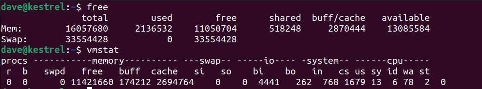

                                      #779383
                                      Ian P
                                        @ianp
                                        This is what the first two tools produce (formatting is all to c-ck, but it is in terminal anyway)
                                        ian@ian-EB1007P:~$ free
                                        total          used            free          shared buff/cache available
                                        Mem:         2004840     1009620      119924      112336 1174228      995220
                                        Swap:        6199292      432664     5766628
                                        ian@ian-EB1007P:~$ vmstat
                                        procs ———–memory———- —swap– —–io—- -system———cpu——-
                                        r  b   swpd   free   buff  cache   si   so    bi    bo   in   cs us sy id wa st gu
                                        2  0 432664 119924  16532 1153552   25   65   748   785  444    3 10 7 79  5  0  0
                                        ian@ian-EB1007P:~$
                                        Does it confirm this Asus box is unsuitable?
                                        Ian P
                                        #779419
                                        Andy Stopford
                                          @andystopford50521
                                          Well, there’s a substantial amount of memory free (though the swap use might be  excessive), so it should be OK from that point of view.
                                          Assuming there’s nothing actually wrong, and that it’s just that your machine isn’t up to the job, you could try one of the special lightweight Linux distros. Have a look on this page:
                                          https://www.techradar.com/news/best-lightweight-linux-distro
                                          Some of them look promising – I noticed that there’s one that only needs 500 MB RAM, and another that’s designed to run from USB without an actual install. I should avoid anything that seems super-lightweight and minimalist – they’re aimed at hard core geeks.
                                                      ian@ian-EB1007P:~$
                                                      Ian P
                                                      That’s not good!  It shows Mint is having to swap RAM to and from the laptop’s hard drive, and that the swap space is small too.  The bottleneck is insufficient RAM.  Swapping slows everything down, and it depends on how fast the physical disc is.
                                                      If I remember correctly, the Atom was designed to provide good battery life on a inexpensive laptop, and inexpensive means all the components are likely to be on the slow side.   Relatively slow CPU, RAM, IO, graphics, maths, network, and disc.
                                                      Here’s what good looks like.  A middle-aged, not cheap, Dell XPS with 16Gb RAM:
                                                      vmstat
                                                      free and vmstat show my Dell isn’t using swap at all.  Ian’s Asus is doing 25 swaps in per second, and 65 swaps out per second, which is a lot of data going between RAM and disc just to make space.  Everything crawls on the Asus because memory has to be continuously moved and reorganised.  In contrast, my Dell has 16Gb of RAM and won’t need to swap ever unless I load the machine very heavily.   And then, it swaps to a fast SSD, not a slow hard-drive, so performance will still be reasonably unless I really hammer it.  If it started to swap, I think the Dell can be upgraded to 32Gb…
                                                      Asus cure then is more RAM, assuming it can be fitted.  To save a few pennies very cheap computers have the RAM soldered in.  But if if the Asus has sockets, additional RAM is quite cheap.
                                                      As Linux distros go, Mint is heavyweight.  It’s in the W11 class, and likes lots of RAM.  If a lightweight distro is acceptable, the Asus will fly: whether or not lightweight is fit for purpose depends on what the user wants.
