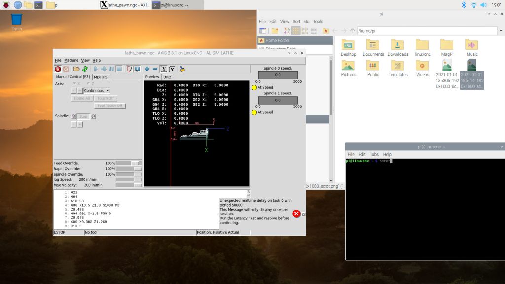

Well, no problem so far. I used Ubuntu, but Windows can create a bootable SD-Card in much the same way.
Went to http://www.linuxcnc.org and downloaded ‘LinuxCNC RaspberryPi OS based on Debian10 Buster’
Got linuxcnc-2.8.0-pi4.zip (1.3Gb)
Extracted linuxcnc-2.8.0-pi4.img
Followed Getting Started Guide at **LINK**
Checksum check failed (different image) – ignored. (This just checks the download wasn't corrupted.)
Installed Imager_1.5.amd64.deb for Ubuntu. (A program for copying a bootable img on to an SD-Card)
Plugged card reader with 8Gb SDCard into USB port on my Ubuntu computer.
Ran Imager
From ‘Choose OS’ selected ‘linuxcnc-2.8.0-pi4.img’ via ‘use custom’ option
From ‘Choose SD’ selected my SDCard (the only one plugged in)
Pressed WRITE button. Copied file for about 5 minutes, and finished OK
Removed card & inserted into switched-off Pi4B with keyboard, screen, and PSU ready to go.
Powered up and got missing kvn missing CPU0 error, lots of boot messages (not errors), then the usual ‘first time install’ rigmarole asking for US or UK keyboard & wifi password details etc.
Then the pi4 updated itself: I guess the linuxCNC image is out-of-date because this took about 30 minutes. Nothing abnormal, and I ended up with a typical raspberryPi graphics screen and the usual invitation to restart to apply changes. Did that, got the kvm error again, otherwise clean start.
All apparently normal except the Raspberry menu list includes a CNC group offering:
Documentation
G-Code Quick Reference
Latency Test

Clicking LinuxCNC started the application and asked me to select a machine configuration. (Sorry about the primitive screenshots!)
I chose multi-spindle lathe, which is a simulated machine. I was asked if I wanted to copy the configuration so it could be customised for a real lathe. That done, Linux CNC presents a control screen:
No hardware connected, but the software seems to be working.

I created a Boot stick using Rufus, with LCNC Ver2.7.15 , which appears to be Debian 7 Wheezy – and is 32bit!
(Actually was Ver2.7.14 on the download page, and once installed, it updated to 2.4.15)
I booted on the small ITZ Mini-PC and it booted fully! In Applications LinuxCNC is there with all its bits.
So I took the next step – did a full install, overwriting the Win-XP that was on the disk – install was successful, it boots from the hard disk – I ran the latency test, setup a mill config (Stepconf) and all went well – could not run my setup as there appears to be a driver problem with the Par port card…
