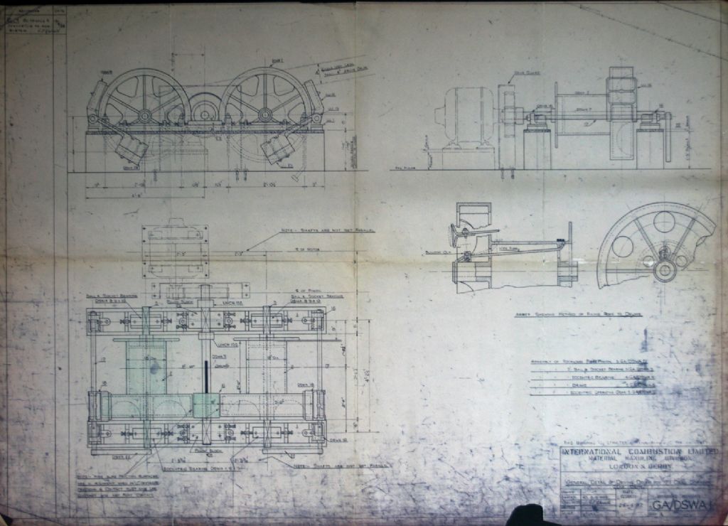

                Hi, I've given my drawing that I've shown earlier a go with my Canon 400D with 18-55mm lens, set at about 31mm. While it took a decent picture, I think a studio level lighting would be a lot better, mine is done with daylight coming in through two windows, which are at right angles to each other, and a certain amount of washout can be seen from the light on the right hand side window.
                I think I prefer scanning, as even this quick way of doing it, took longer to set up, but if one is doing a lot of them, I guess one would have a dedicated set-up.

                    The linen drawings, some older than 100 years, are in excellent condition. Two have been copied for someone out there. Photography did not really work but a flat bed scanner produced very good prints.
                    Thanks to all
