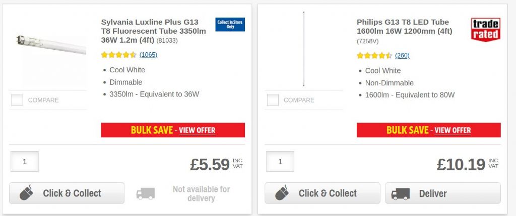

                                      Err, 3500 lumens from 36W is 97,2 lumens per watt, and 2200 lumens from 22W is 100lm/W.
                                      it's an interesting comparison though – this screensot is from a well-known supplier whom I dare not name (Screwfix):
                                      Says a 3350 lumen fluorescent is equivalent to 36W and a 1600lm LED to 80W. Hmmmm.
                                      Meanwhile, this site says LEDs win hands down.
                                      One confusion may be that fluorescents radiate in all directions, wasting light, whilst LEDs are directional – the light goes where it's aimed.
                                      Any lighting experts out there – I'm confused
