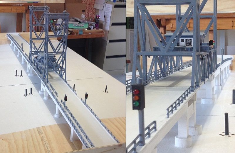

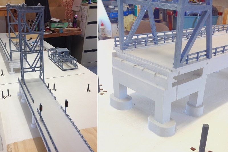

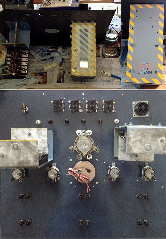

      Then I had the fiddly job of painting the railings.
      I do not plan to paint the bridge to appear weathered, but as if brand new and unpolluted. It is something I learnt to appreciate from doing some architectural rendering in my youth. So, I gave the rest of the bridge a cement grey colour. The road will be painted to appear as concrete (with gravel).

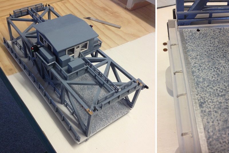

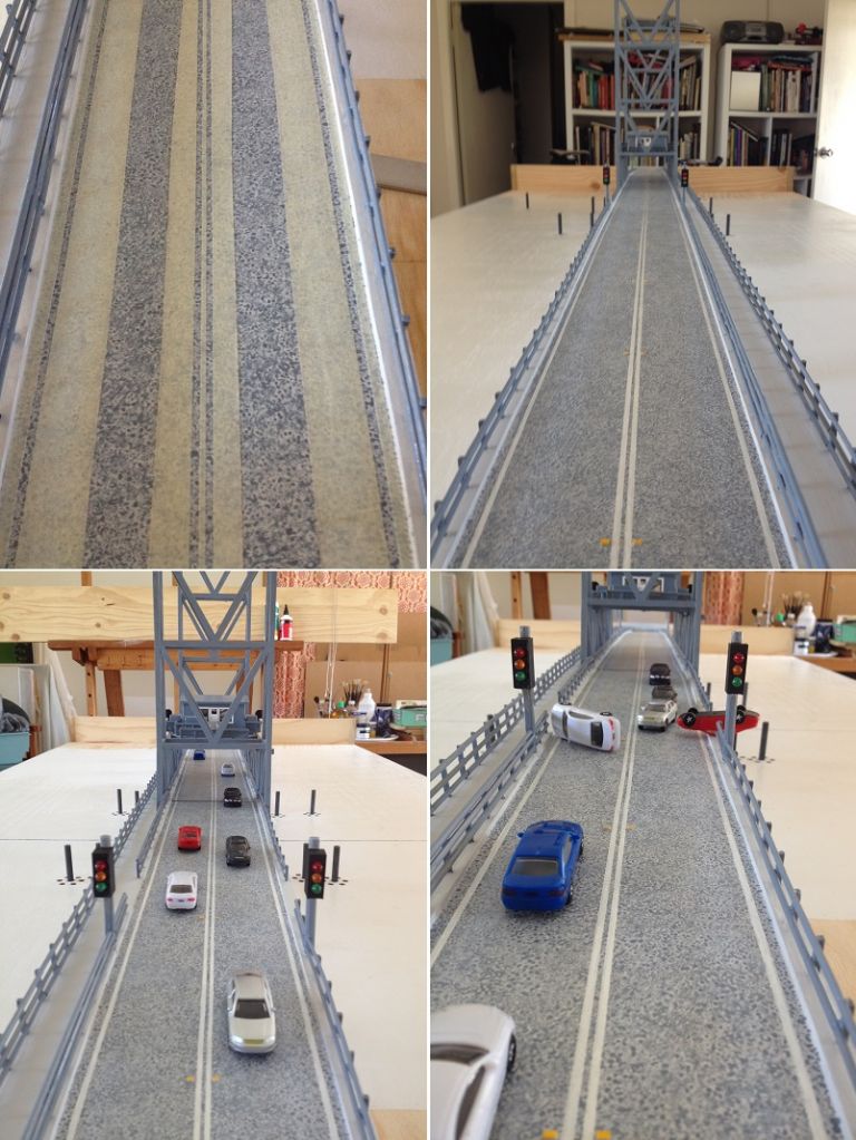

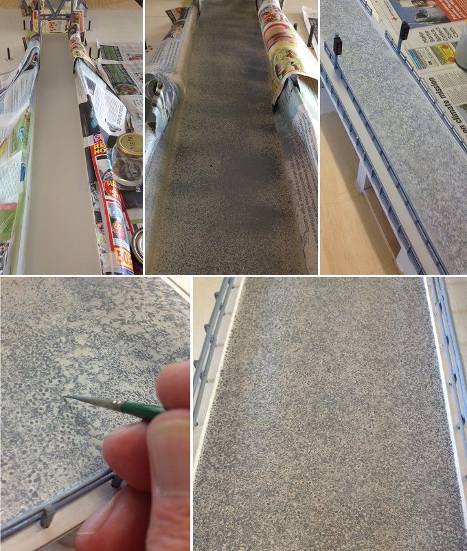

        Throughout this project I continue to do Internet research. A friend emailed me a photo taken of a computer screen by her iPhone. It revealed a few things I was still not clear about. There was the matter of what did the swing-gates look like. The scale of the cars is known, but how did they look in comparison to the whole bridge. Finally, what did the concrete road look like from above.

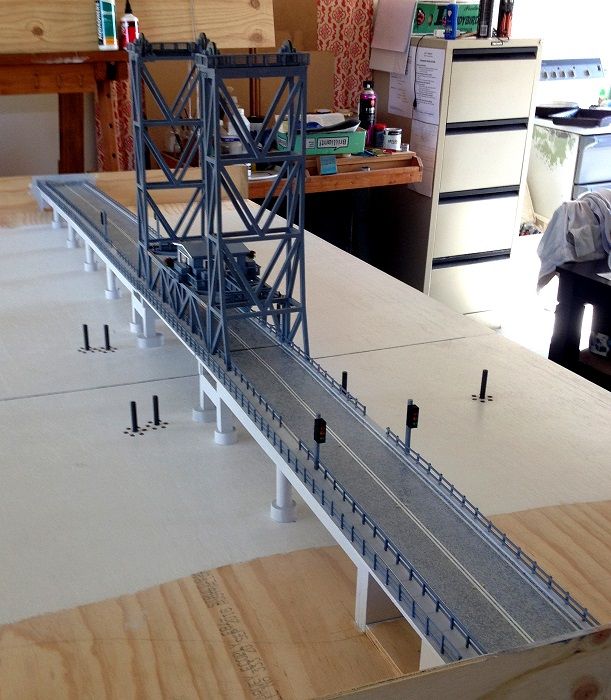

        Decided to splatter dark grey paint onto the cement colour. It turned out horrendous. So then I used the dry brush method to lighten up the dark patches. Afterwards, I kept alternating between dark and light paint with a fine brush until I was happy with the results.
        Painting the span took longer than painting the rest of the road. It was difficult to get into the central areas. The edges of the span and bridge have a metal plate (silver painted area). The hole you see on edge of road is for the fine (0.7 mm) bridge cable which goes through the display table.

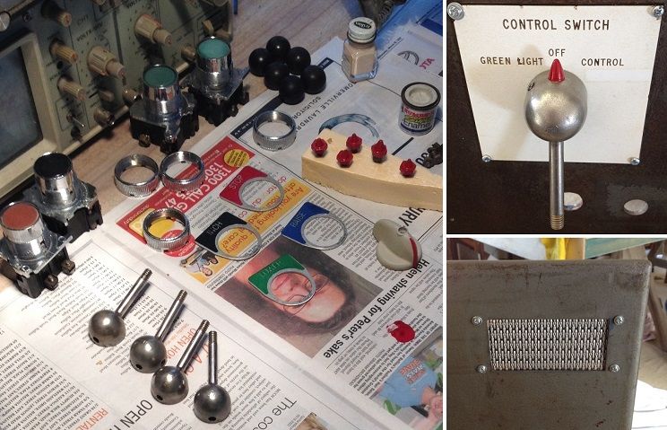

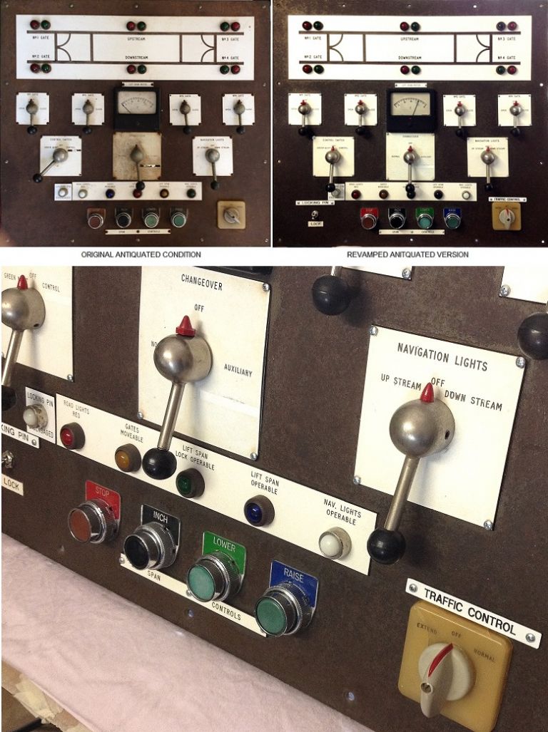

                        Since the console is to be a wiring diorama of sorts, I decided to dramatize it a bit by adding some paint here and there.

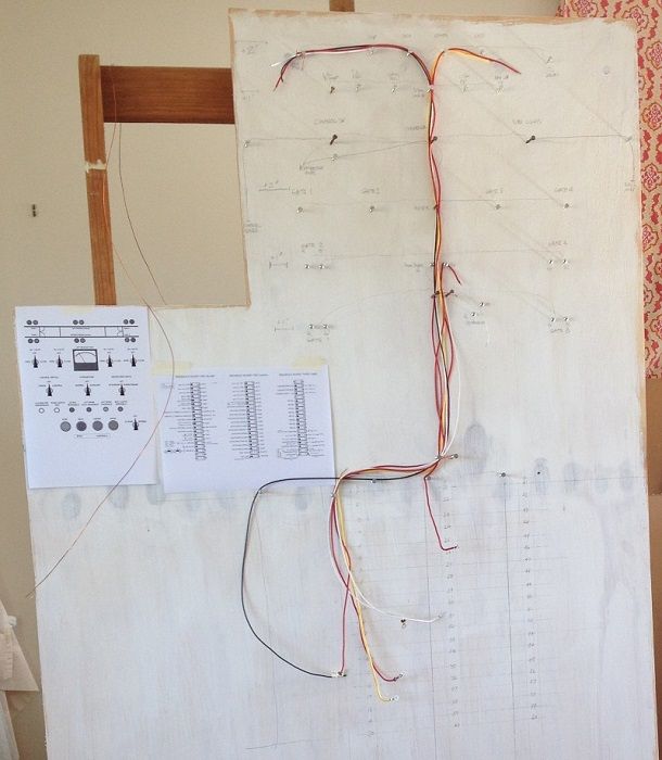

                        #338909
                        Peter Hausamann
                          @peterhausamann71795

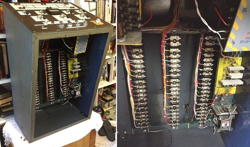

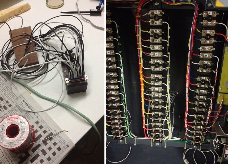

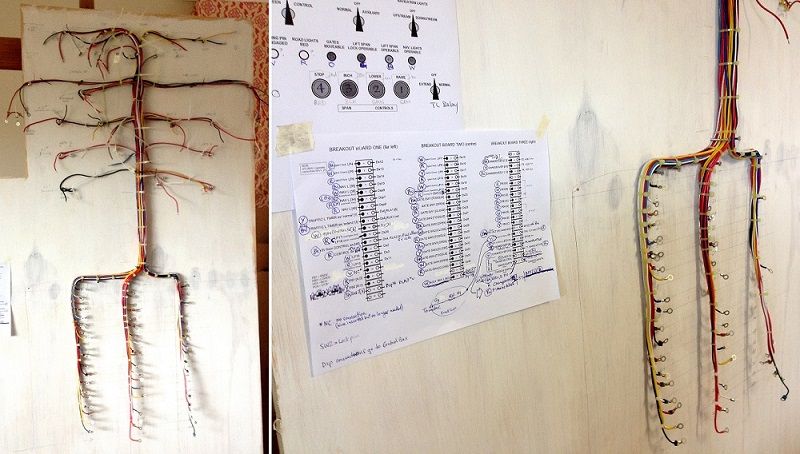

                          Creating a new wiring harness for the console.

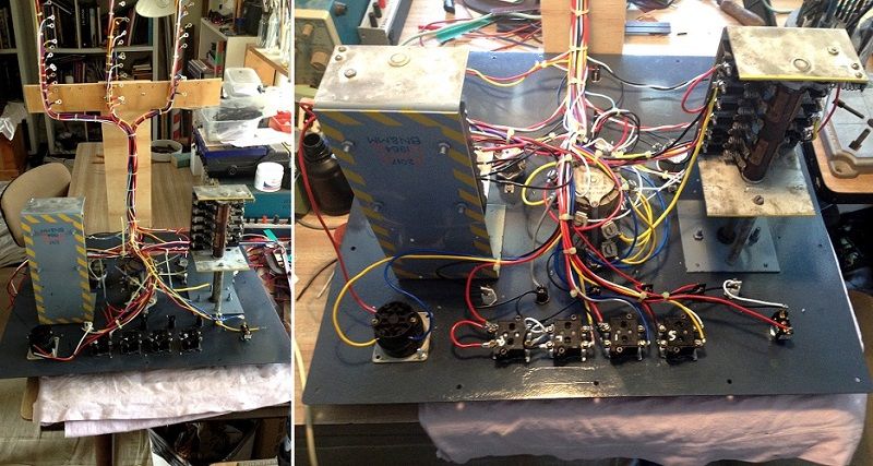

                          #339116
                          Peter Hausamann

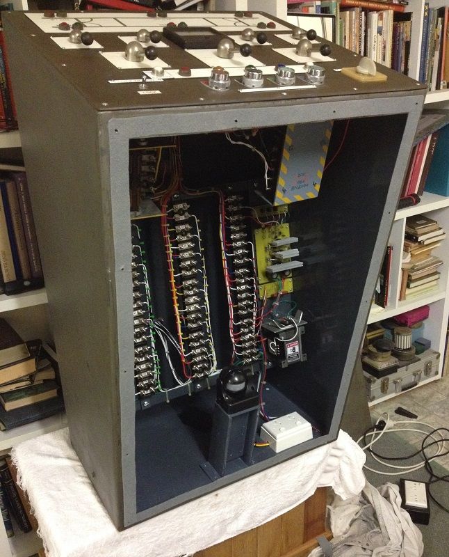

                            Added wiring harness to console control panel. Since it is the underside (not easily seen) it was pointless to dressed it up.
                            Connected control panel and harness to console.
                            Made small harness between terminal strips and the two D-Connectors to the back of console (these connect to control box under display table).

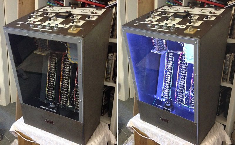

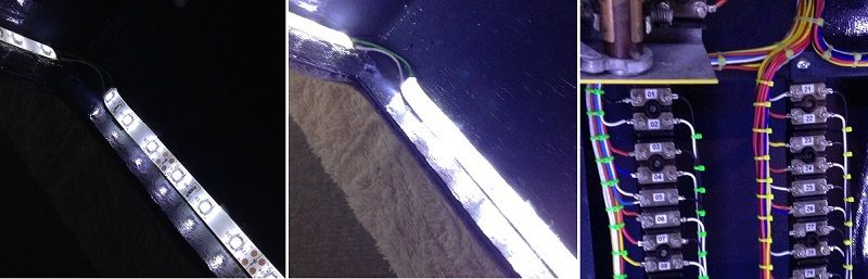

                              Added Passive Infrared (PIR) sensor for detecting any museum visitors approaching the display.
                              Dyed some felt a grey color and lined the console edges of front panel.

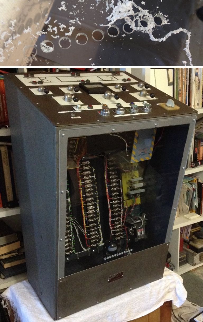

                              Drilled holes in the thick Perspex, allowing heatwaves to reach the PIR sensor. A portion of the front panel was used as a kick board to protect the Perspex.

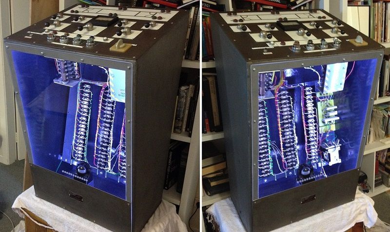

                              #339362
                              Peter Hausamann
                                The PIR sensors movement in its vicinity. When it does it will turn the console lighting on. The only times it turns off is when the PIR no longer sensors movement for 10 seconds, or when someone starts working the console.
