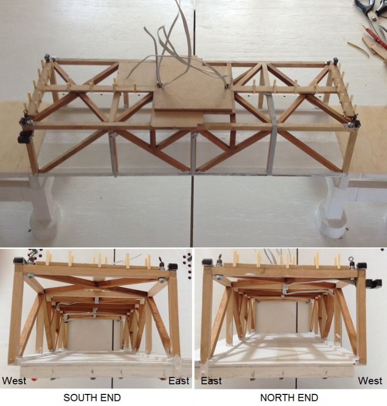

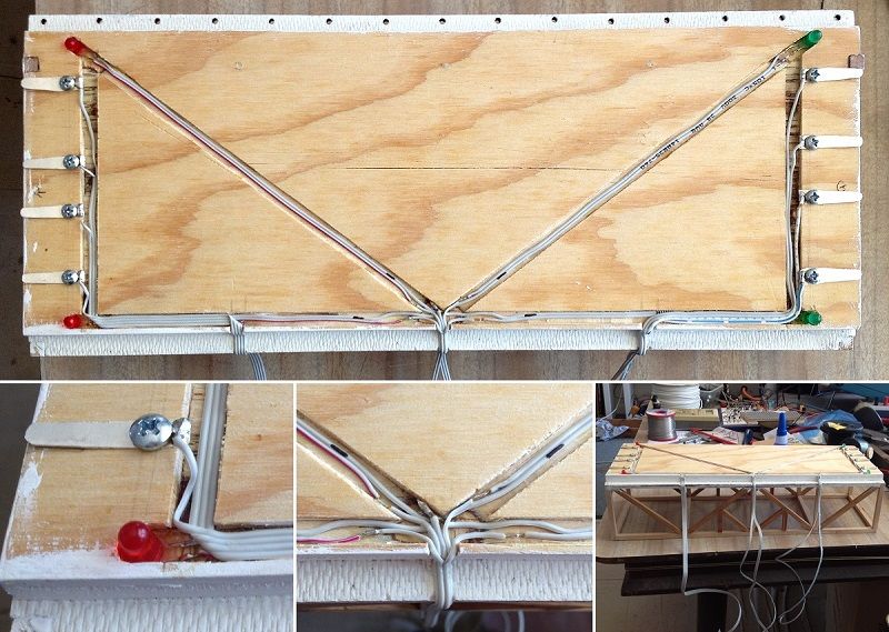

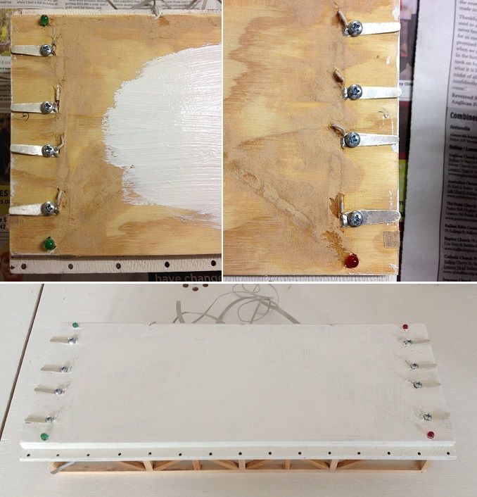

        I found some springy shim metal and cut out eight contact plates. Installed the contacts, LED navigational lights, and wiring.
        The wires are routed to where the frame vertical beams are, so to guide the wires to the span hut.
        I filled the trench work with wood putty (after I checked for electrical continuity). Then sanded and painted the span with white acrylic undercoat.

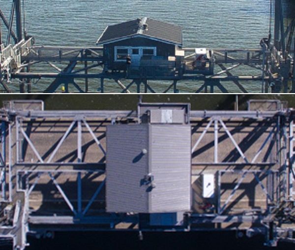

          Luckily I came across a few photographs of Wardell Bridge via a Company that uses drones for aerial photography. Form these photos I was able to draw a plan for the span hut.

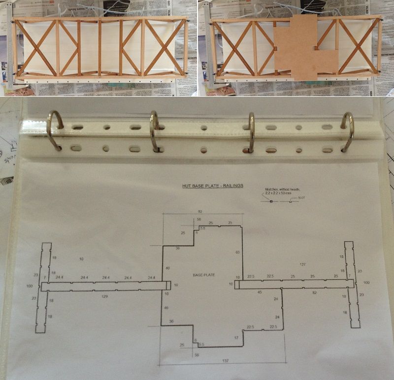

          The base plan:
          #336142
          Peter Hausamann
            @peterhausamann71795
            Used 3 mm MDF board for hut and gangways, and matchsticks for rail posts.
            The extra board you see is the hut floor. I am going to used its edge for gluing the hut walls to.
            The rectangular hole is where the wiring will come up from under the span.

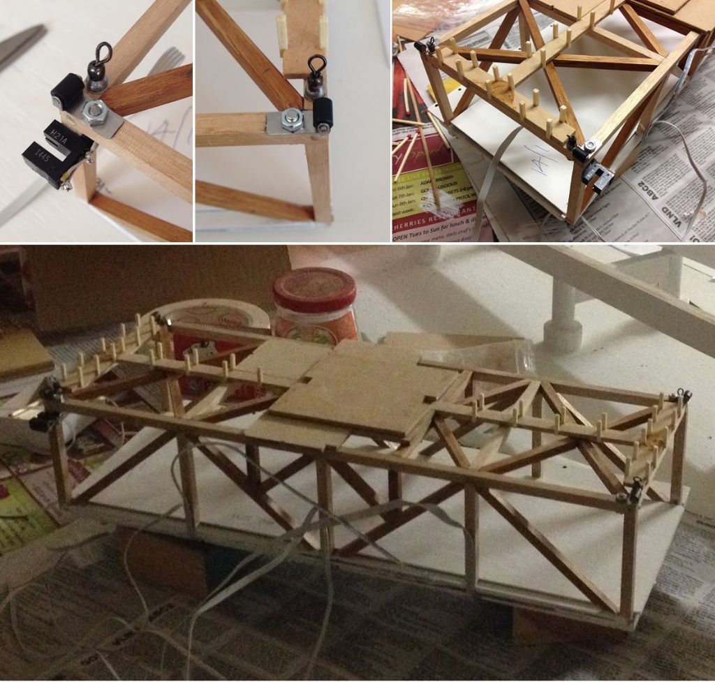

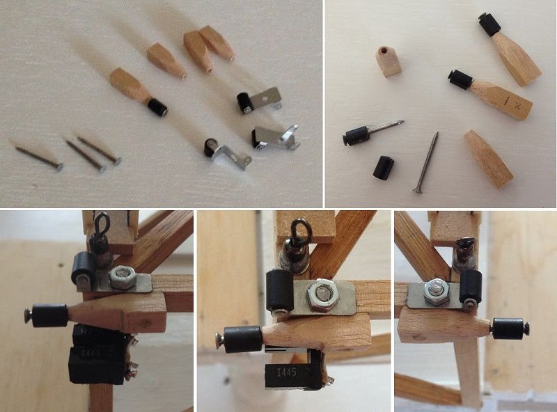

            You can see the cable anchoring points have been inserted. I used microswitch actuator arms (the roller type) for bumper rollers. These ones are for longitudinal movements of the span. They are to stop the span from getting caught onto the towers when the span raises and lowers. On one corner is also an opto-couple used for triggering the vessel traffic lights from red to green once the span reaches its upper limit.

                Photograph of the bridge's bumper rollers.
                Built another set of four bumper rollers but for lateral movement this time.
                Only used the rollers from the microswitch actuators this time.

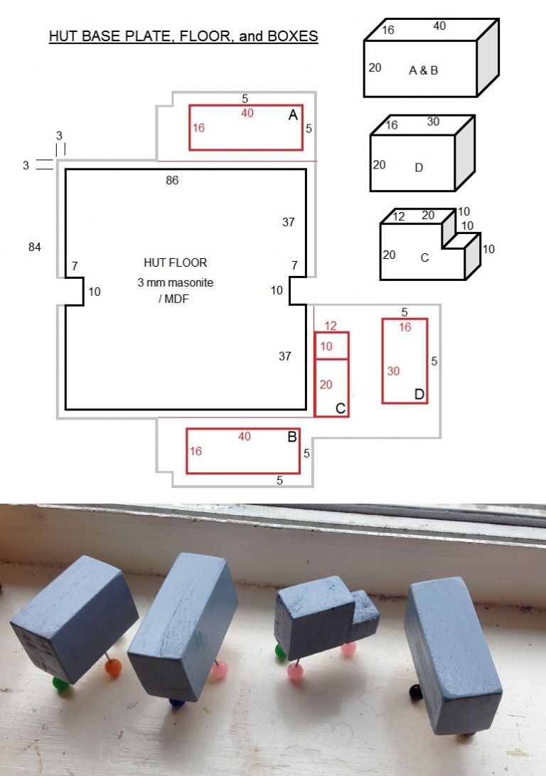

                There are several containers on the balconies. These are made from block timber and painted.
                Here they are drying on my window sill.

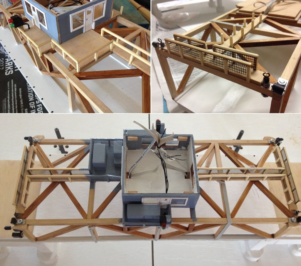

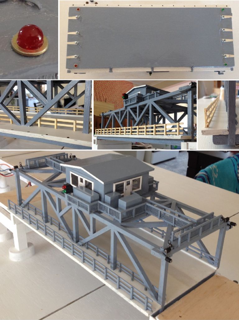

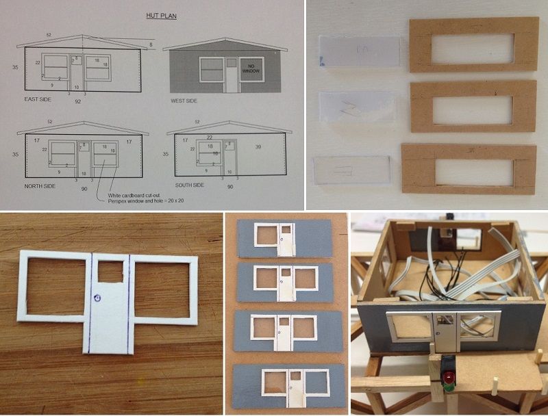

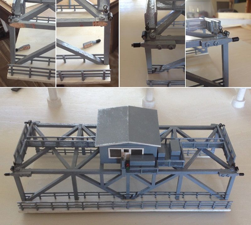

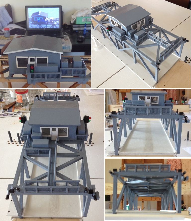

                  Used 3 mm MDF board, 2 mm clear Perspex, and white card to build the hut walls. I was surprised how well the Perspex can give that glass window effect (slight reflection and parallax error). The four tabs at top of walls is for positioning the roof.

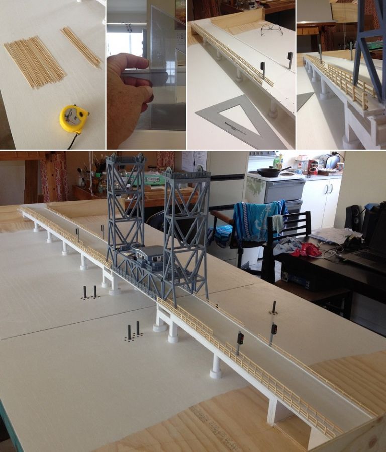

                  Added split bamboo skewers for railings, and fly screen for mesh. Started to paint the span with a home mixed, Bridge Grey oil enamel.
                  Found some washers that fit over the LED nav; lights. Now they look more like beacons.
                  Added railings for the road and footpath. Gave that a paint. Will paint road later.
                  To be honest, at this point of model making I felt really good on how the span turned out.

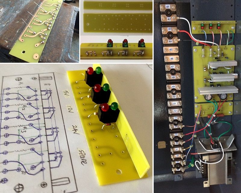

                        Added blown fuse indicators for the DC voltages. Also replaced terminal numbers with new printed ones.

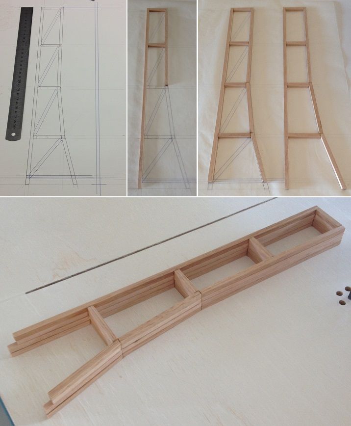

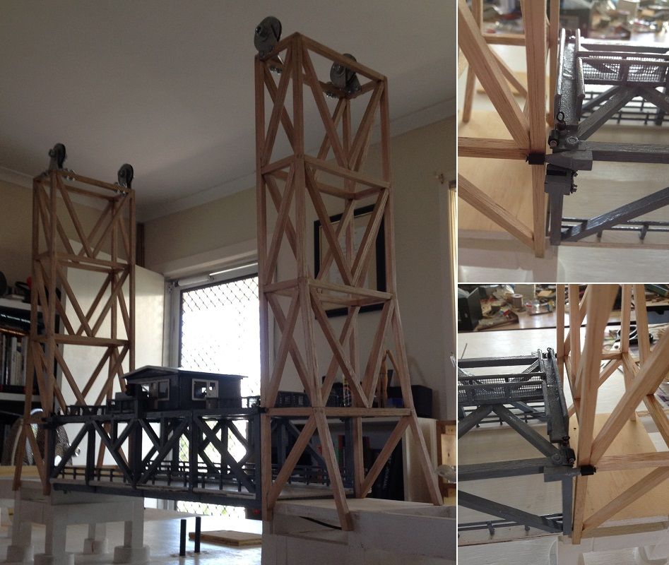

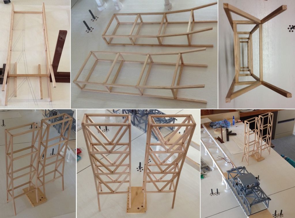

                          Doweling the framework
                          Unbelievably, there is over 11 metres of framing put into the towers.
                          Edited By Peter Hausamann on 15/01/2018 20:20:29
                          Edited By Peter Hausamann on 15/01/2018 20:20:45

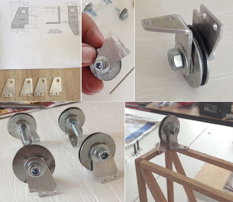

                          #337046
                          Peter Hausamann

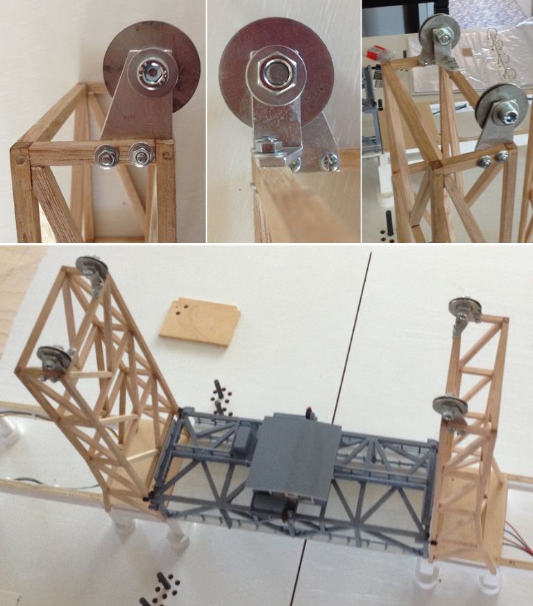

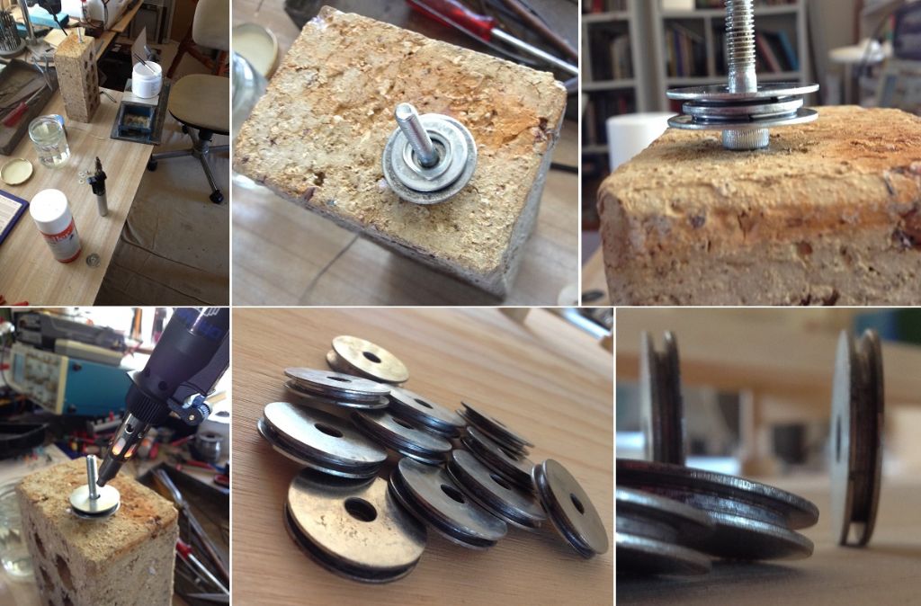

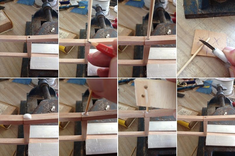

                            The pulley wheels I wanted were too expensive (to buy ten of them). So I came up with an alternative by solder-sweating different sized washers together.
                            My first attempt had too much solder, but got it right after that.

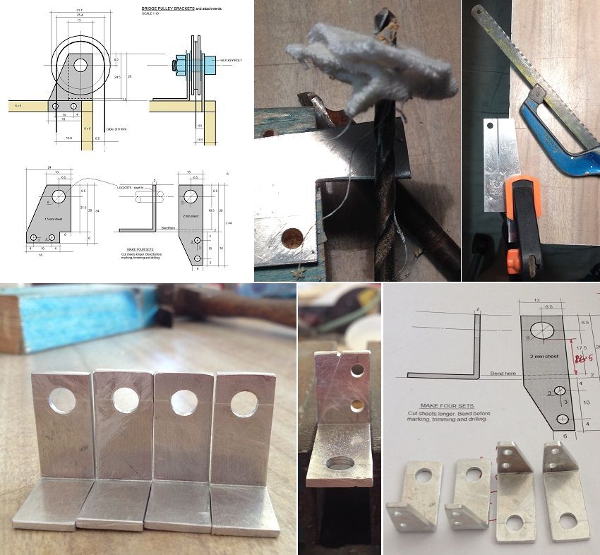

                                Peter Hausamann

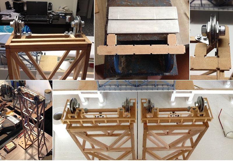

                                  Designing and constructing the pulley wheel brackets.
                                  #337356
                                  Peter Hausamann

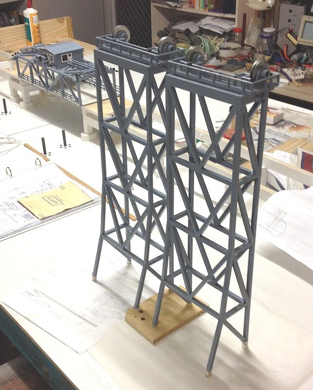

                                    The towers are not actually in place in these photographs. They are just positioned to see how it will look, and how close the span bumpers would get to the towers.
                                    The towers have to be installed at the same time as the road surface.

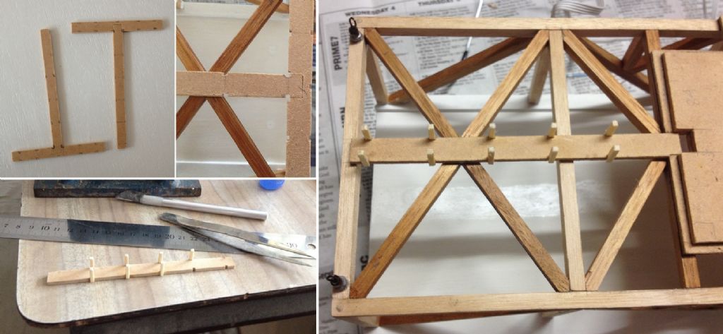

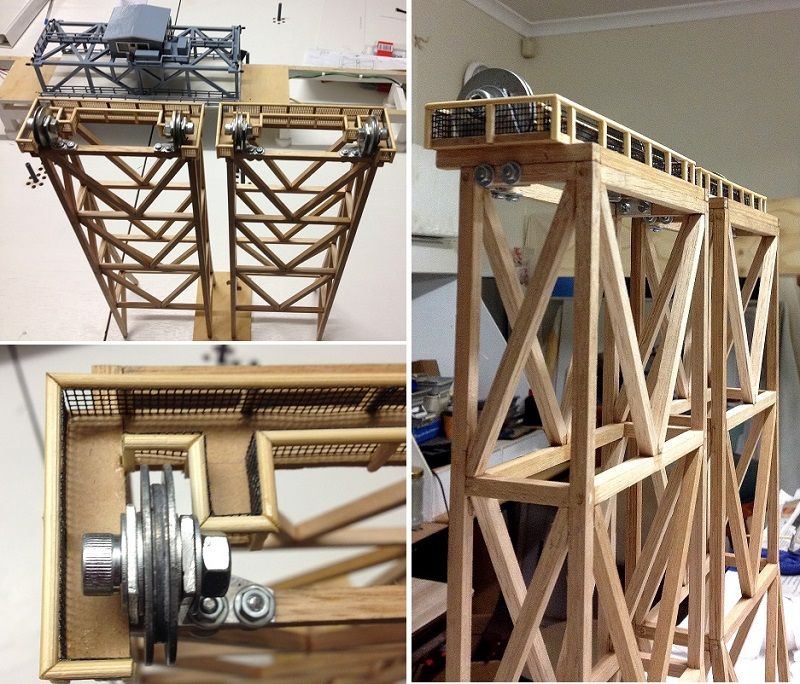

                                    #337504
                                    Peter Hausamann
                                      Added gangway and paint to the towers.

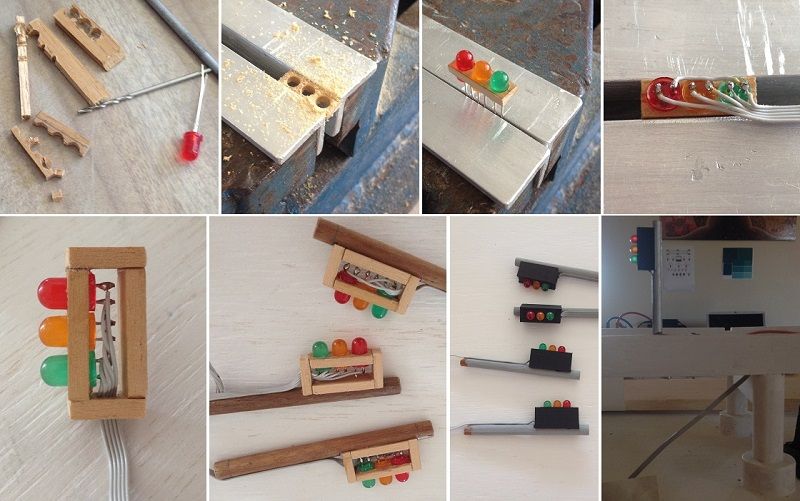

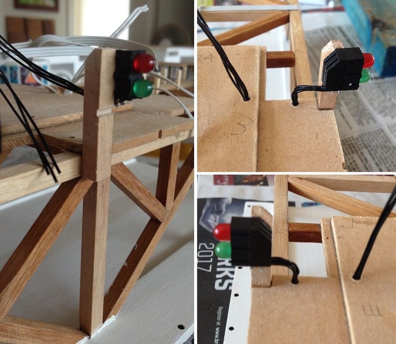

                                        Created traffic lights with large 5 mm LEDs (easier to see from a behind point of view). They turned out over scale, but I am sure the Ballina Museum can live with it.

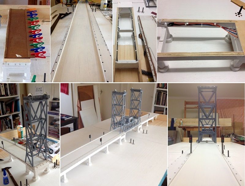

                                          Peter Hausamann
                                            Thanks Martin W, I sure hope it all works out okay.
                                            I discovered before installing the towers that once they are in, the span cannot be removed for repairs. There won't be enough room to pass above the pulley wheels. So I cut off the lateral bumper rollers (the hidden side) and replaced them with removable ones.
                                            #337858
                                            Peter Hausamann
                                              Prepared road base. Installed the necessary span and traffic lights wiring along bridge girders. Assembled road, towers and traffic lights in one go.
                                              #337942
                                              Peter Hausamann
                                                Took me a few days to add all the matchstick posts and split bamboo skewer railings.
                                                #338138

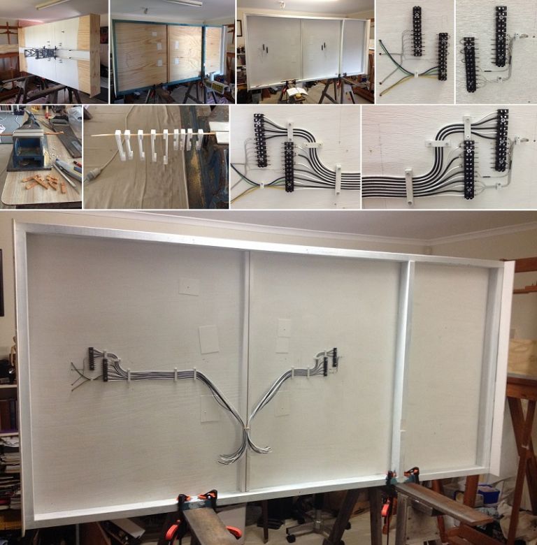

                                                  Tilted display table on edge to ease the working on the wiring harness. Wires from bridge got terminated and then harnessed to where the Control Box will be.
