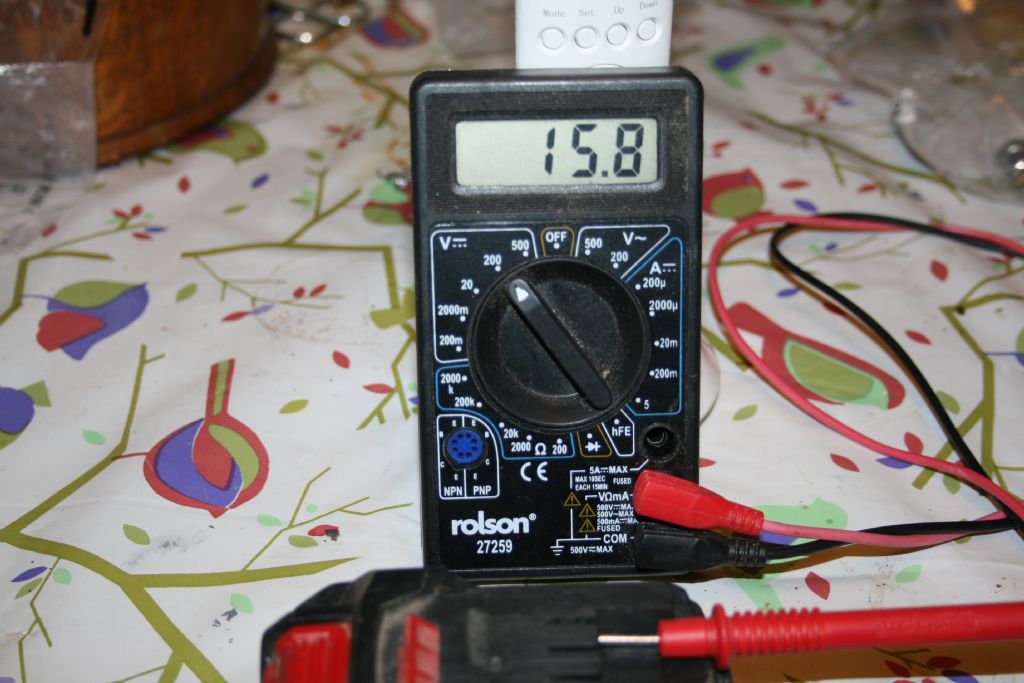

        Hacksaw
          @hacksaw
          I opened the old 16 v battery earlier today . It has a printed circuit board , packed with i.c.'s inside . ..so i thought I'll just put that back together….I can't fix that .but I'm sure it had 4 cells.. I've used it a bit , it was 16v .

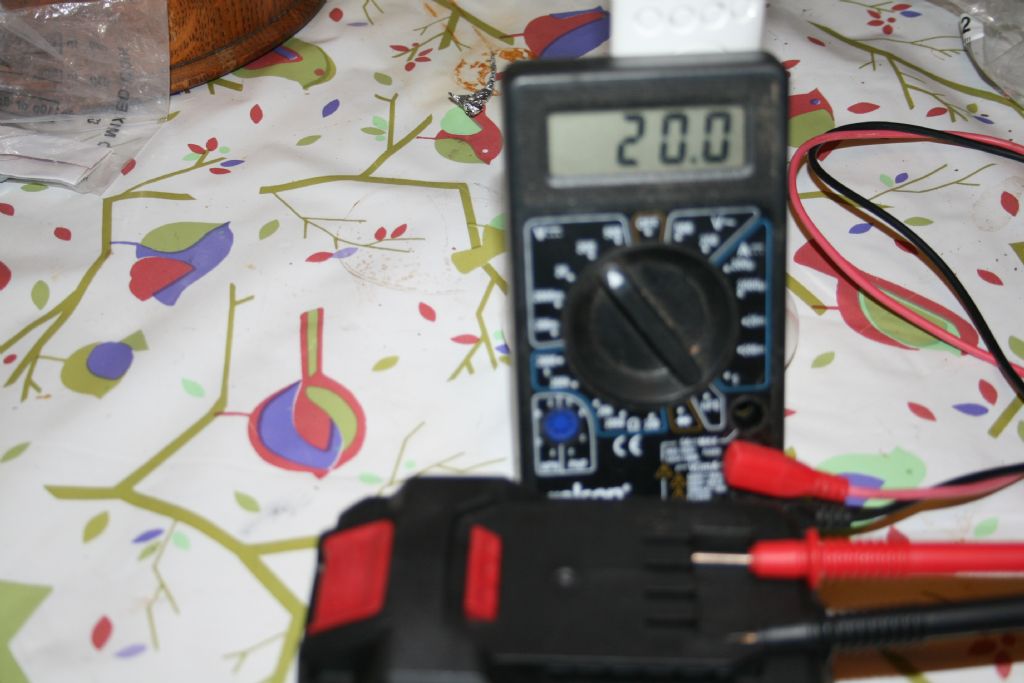

          And the new 20v one fully charged …………20v ..go figure !
