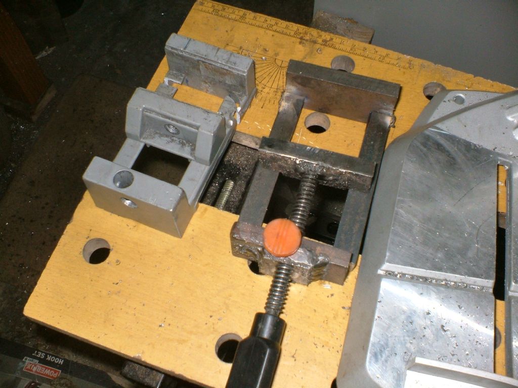

              First bandsaw project, a steel version of those aluminium vices they sell for about a fiver
              I hate the vice, but just love the quick release mechanism

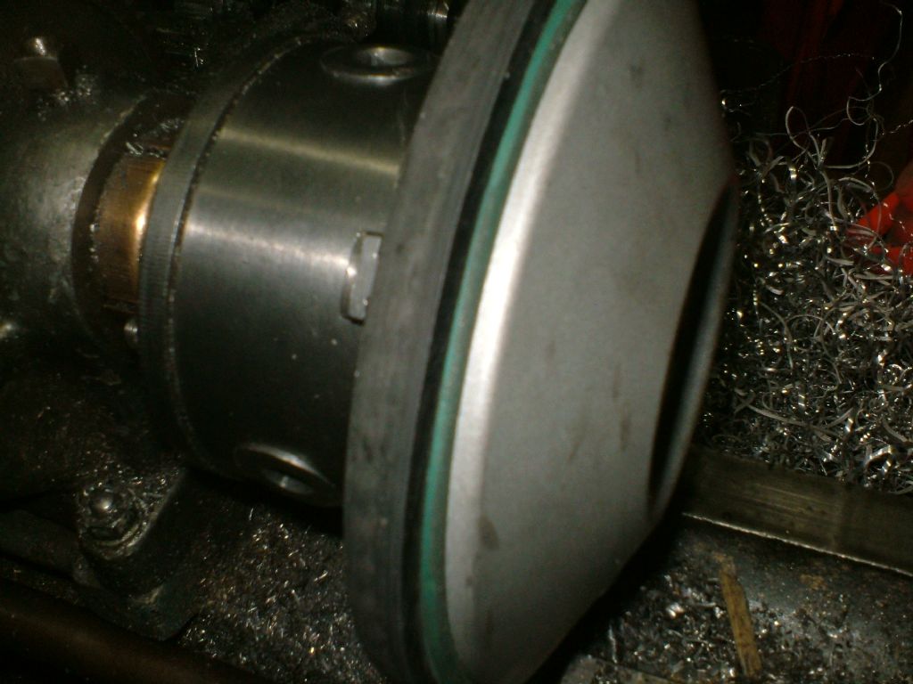

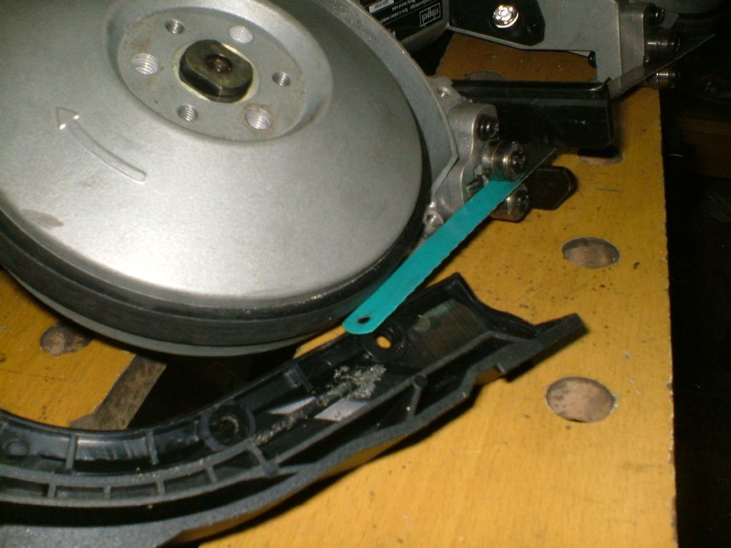

                                    Ok then let's make a start

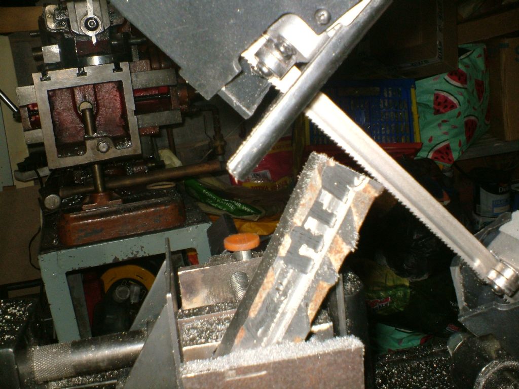

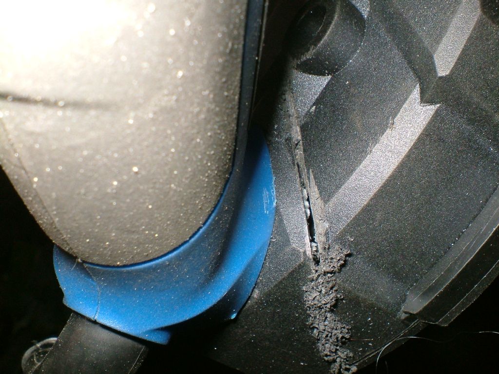

                                    I had to take the guards off which is about 8 screws but the drive side guard fouls on the handle which is integrated with the electrics, including the motor
                                    so I sawed it in half along the side of the handle so I could pull it out and get a clear shot at the drive wheel without disturbing the electrics
                                    with hindsight the other guard didn't need to be removed

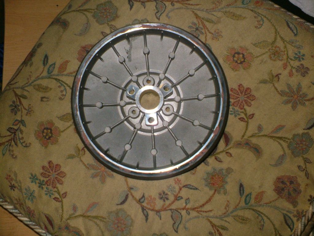

                                    The problem IMO is the twist on the blade as it is pulled through by the drive wheel, you can see the huge change in angle this hacksaw blade would have to make to rest on the drive wheel

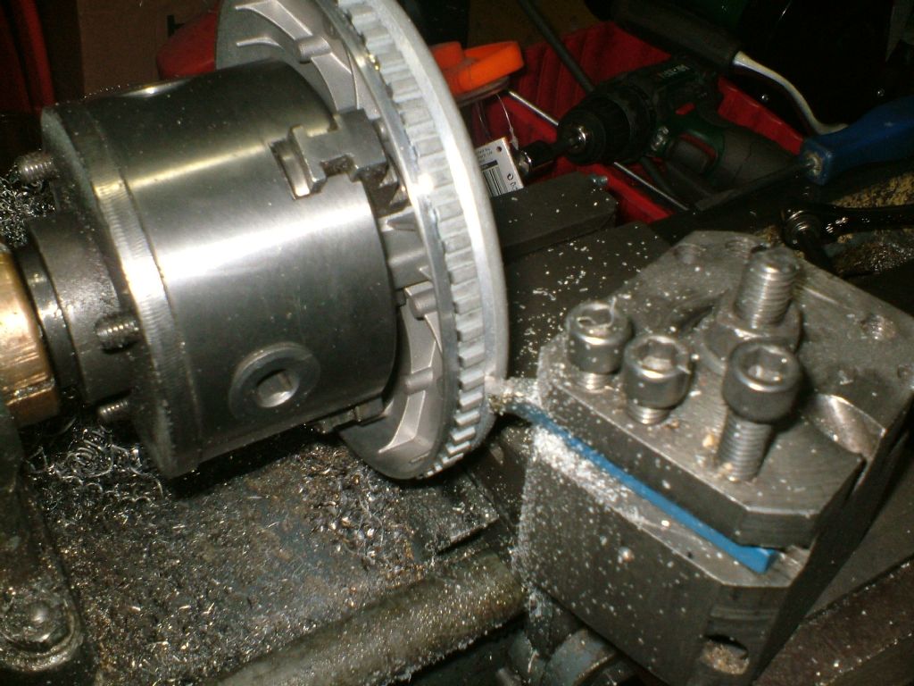

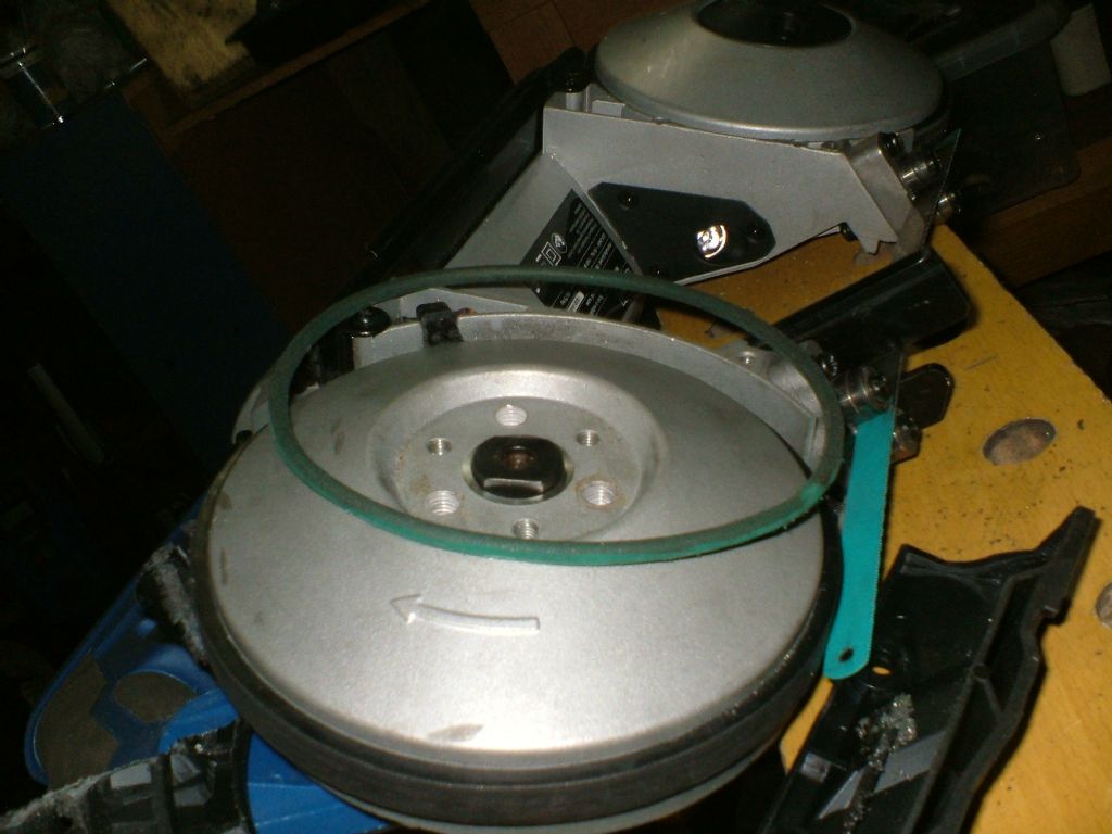

                                    I used 5mm lathe belting to lift one side of the tyre on the drive wheel
                                    cut a groove of about 0.5mm by 3mm in the drive wheel
                                    and fitted it into the groove, then refitted the tyre

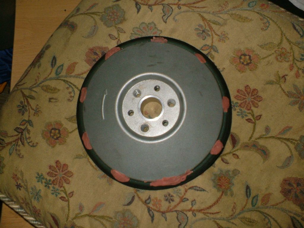

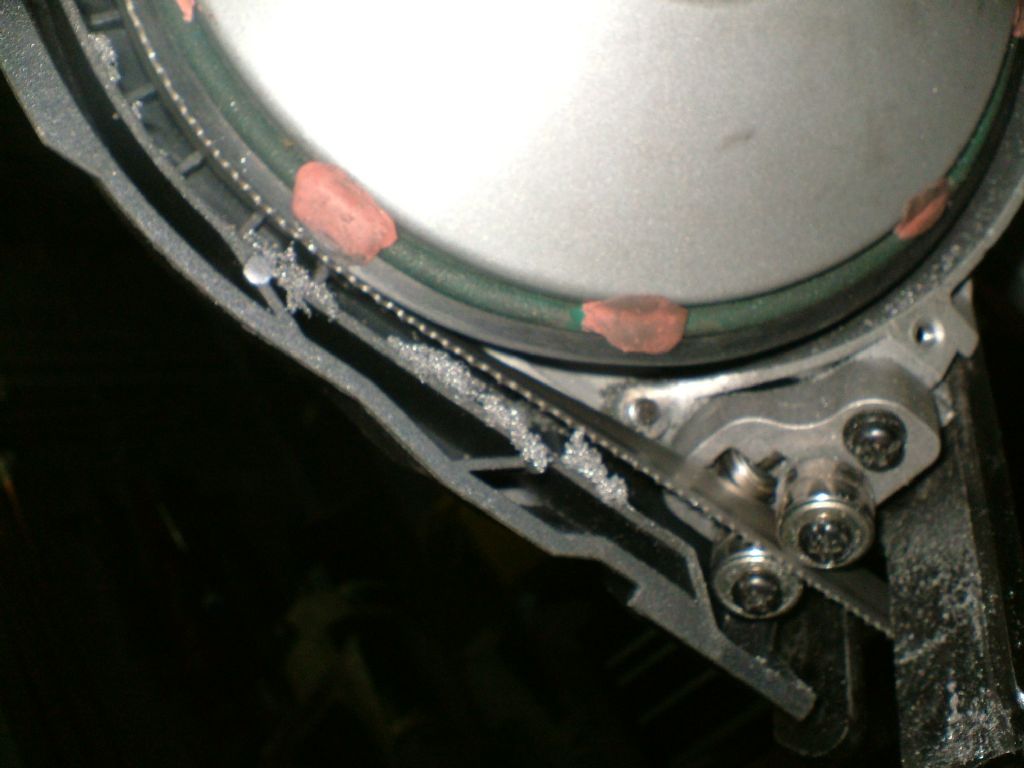

                                      This only created a new problem, the tyre would now come off under load since it was no longer seated on the drive wheel dimples
                                      To the rescue came my old friend, pinkgrip. I lifted the tyre all the way round and filled the inside gap with it
                                      Then put a bit onto the 5mm belt raised side just for luck, so the green belting stayed in the groove
                                      Left it for nearly 3 days to cure
                                      Put it back in today with a new blade and the band stays on fine, which was the great unknown here
                                      There are no weird noises from the bandsaw and the blade sounds a lot happier
                                      The cut also looks nicer than previously
                                      Other notes: The drivewheel nuts were seriously tight and it took a good bit of effort to get them off
                                      I ground the internal cleaning brush down to fit the new angle of the revolving blade
                                      The drive wheel guard didn't really need removed
                                      The album for the mod is here
                                      Only time will tell now whether this has been worth the effort, will keep you posted
