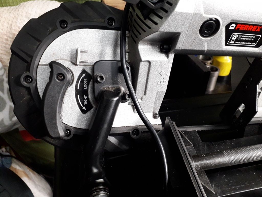

                                      Martin, I have the Aldi one (£149.99 delivered last year I think) – the blade tension is fine, I could play a tune on it and the weld is flat and smooth, I'd be taking it straight back before they have none left to exchange it with if I were you! (And hoping its not a crap batch!)

                                        I was wondering if anyone with other makes could chip in and say if their models have a mechanism for setting blade tension in addition to the cam mechanism that releases the blade for replacement?
                                        In the Lidl offering I had, there is only the cam adjuster for both blade release and tensioning and when at full lock, there is no other means of blade tension adjustment. For whatever reason, my blade was so loose that it would constantly stall in softer metals because there was insufficient pressure on the rollers for a good grip.
                                        Lidl v good -refunded no questions asked, and no, I didn't want another of the same ilk, ta very much!
                                        I might consider trying again with a better marque, but only if I can determine if there is a proper blade tensioning adjustment mechanism and preferably if blade guide adjustments are possible as well. However, I suspect guide adjustment may be unusual, given this type of bandsaw was originally designed for freehand use.

                                          I think you may have just got a bad one, my blade tension can't be adjusted by any other means, but it works perfectly fine, so I see no reason why it might need to be changed.
                                          Perhaps one defect accoutns for you both your complaints, a stray guide perhaps not holding the blade vertical, and as a result, shortening the correct route of 1140mm in length preventing you from tightening as the blade its literally cutting corners?

                                          Henry Brown
                                            @henrybrown95529
                                            Here's a photo of the blade tension lever on my Ferrex (Aldi), hope that helps Martin…
                                            #505470
                                            Martin of Wick
                                              @martinofwick
                                              Great, Thanks.
                                              I guess these products are all much the same in design but with varying build qualities. The lidl version looked to be extensively 'value engineered' and a Friday afternoon job (drillings off angle, poor threads etc). I did do quite an thorough check and strip down to assess blade run and look for any other means to take up blade slack, to no avail.
                                              Could just have been down to a poorly sized blade, but by that time I had decided it was just not satisfactory as the basis for any project and time to get my money back!
                                              I may pluck up the courage to try an Aldi version for conversion to vertical bandsaw one day, but one bitten… Now considering a small, cheapo upright wood bandsaw frigged with a 10:1 gear reduction on the motor as an alternative route instead.
