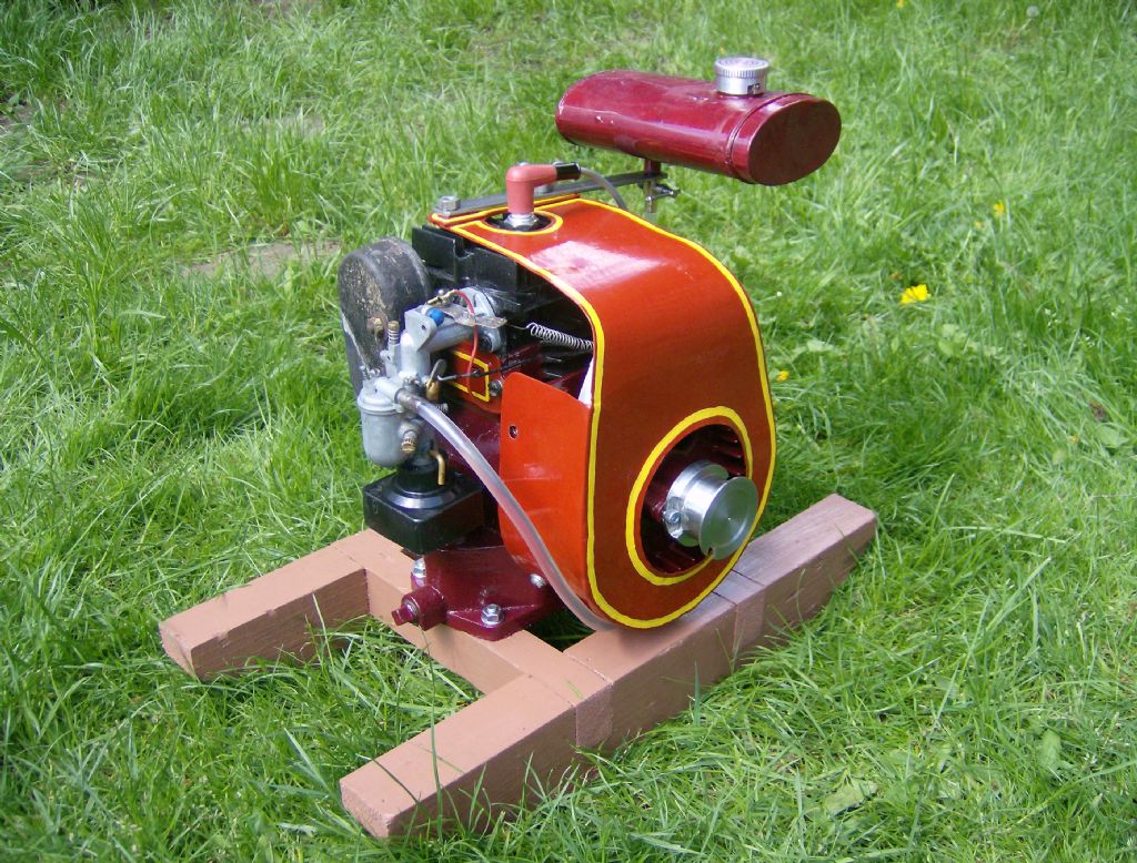

                  Agreed only small welds, but I was able to knock up the cover below from old tumble drier. Also got an ancient Bedford CF through it's MOT.
                  Front of restored engine
