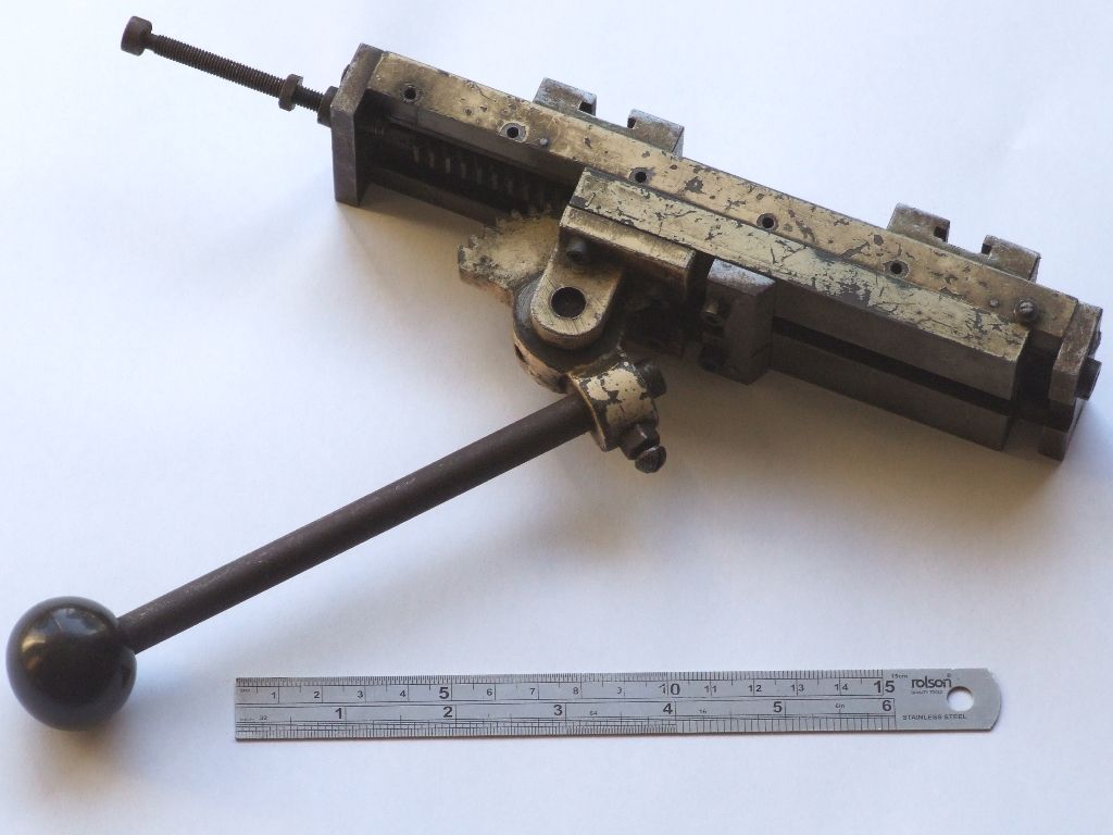

            Neil,
            The one for the Pultra is very well designed … It fits to the bed of the Pultra, but is about the right size to do as you suggest, on a Myford.
            Some decent photos, here: http://www.myford-lathes.com/other_acc4.html

                      #273554
                      Anonymous
                        I have a couple of the Pultra lever operated cutoff slides. They are indeed nicely made, but I suspect they're a bit small for a Myford.
                        Andrew
                        #273555
                          Posted by Andrew Johnston on 24/12/2016 10:11:08:
                          That's why I thought they might be 'just right' for Neil's requirement, Andrew
                          … If I understood the opening post correctly: He wants something to mount on the cross slide.

                              #273635
                              Anonymous
                                Posted by Neil Lickfold on 24/12/2016 19:45:02:
                                Andrew, have you got any info like size etc of the Pultra slide?
                                Are they still available and how much are they? Do you want to sell one?
                                In due course I'll take a couple of pictures along with a linear scale.
                                As far as I know Pultra went out of business some years ago. So the cutoff slides are not available new at any price. I suspect that the main issue may be rigidity, so you might be best off making a retracting style toolholder, as suggested above? However, I wouldn't rule out selling a cut off slide. Although I may need therapy first, as I'm not used to idea of selling machine tools and accessories. disgust

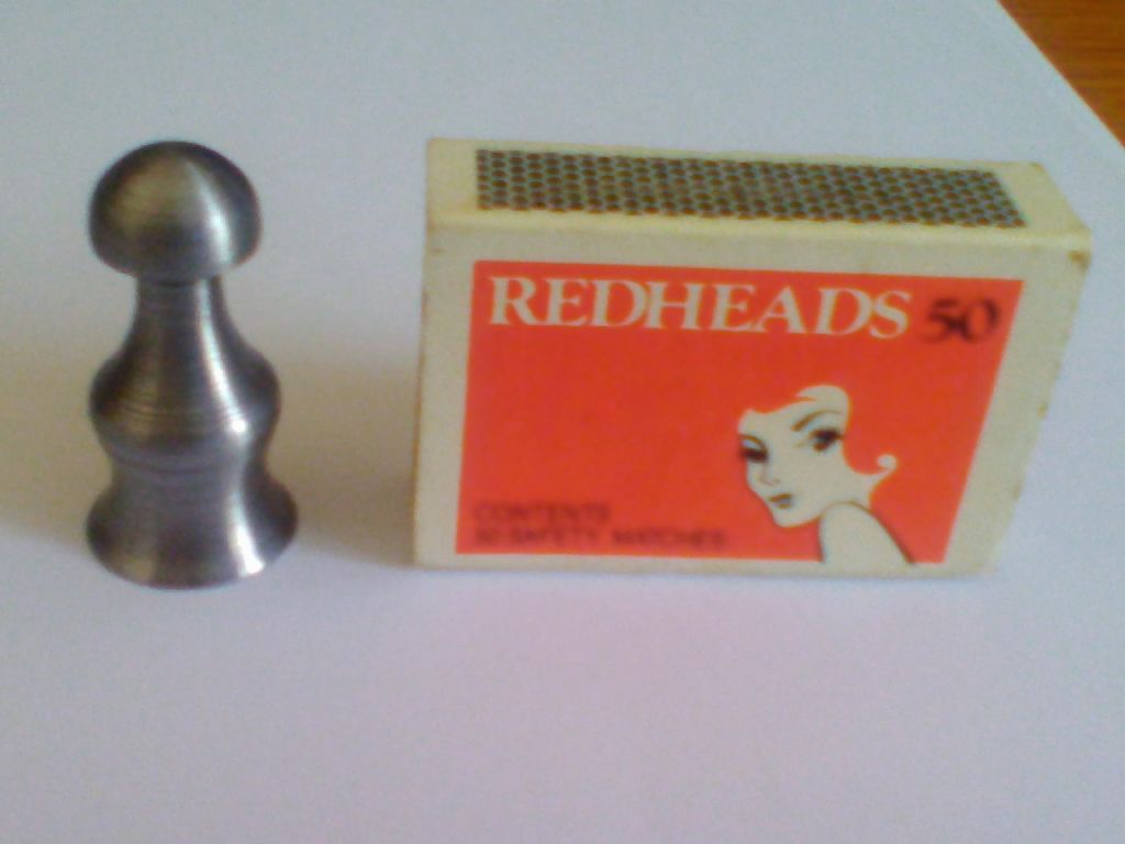

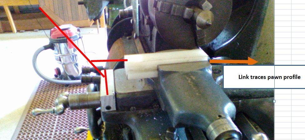

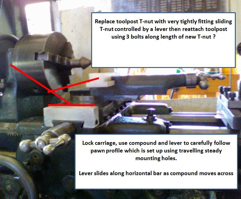

                                    copy_jig_4a.jpgNeil,
                                    I was wondering the same thing.
                                    Am attempting to make a jig to copy chess pawns and was wondering if I could also use it to part off.
                                    See attached photos for concept. Basically replace toolpost T-nut with a tightly fitting sliding T-nut …… see photos.
                                    Started off with Delrin because its easy to cut and I had a scrap handy – might be a bit bendy though – depends how far it extends ? I cut it to be a very very tight fit and then added a few drops of oil to help it slide – gotta admit I dont really know what I'm doing here. For my chess pawns its unlikely to extend very far.
                                    Wanted to keep the toolpost handy and didnt want to go through all the palaver of removing leadscrew from cross slide to follow the pawn contour but having second thoughts now.
                                    This thread has made me wonder about having the sliding part in the toolpost rather than under it.
                                    Any tips hints comments welcome re whether jig is practicable.
                                    Currently 37C outside, and the tin roof of the shed absorbs all that heat and radiates in into the shed, you can feel it like a giant gas heater above your head, so am quite jealous of all you white christmas folk.
                                    Havent got control of these photos yet but getting there.

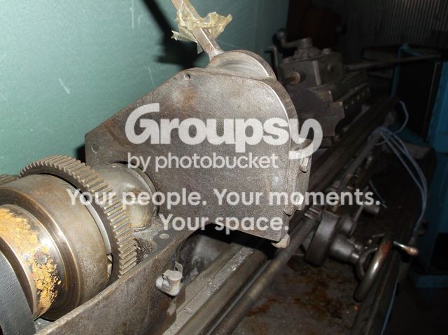

                                    #273652
                                    Hopper
                                      @hopper

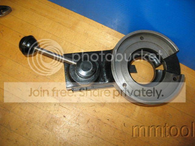

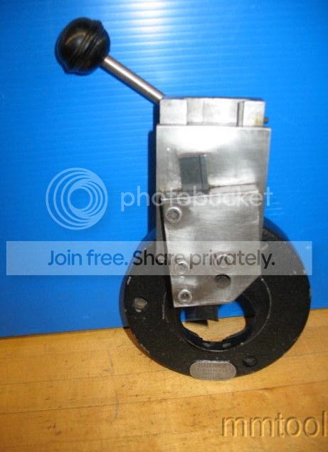

                                      Sounds like you need an independent cut off tool as used on some capstan lathes. This one is a homemade job for a Southbend lathe. Fitted here with a V grooving tool, it can just as easily be used with a parting tool. Something similar could be made up to fit on to your toolpost or rear slide if it suited better. You pull the lever on top, just where it disappears out the top of the photo and the eccentric pushes the lever down, which actuates the tool blade, giving high force yet fine control. Perfect.
                                      Hardinge made one that bolted on to the front of the headstock. It too could be replicated and modifed to mount on the toolpost or rear slide as best suited your needs.
                                      The Hardinge looks like it uses a rack and pinion set up along with proper dovetail slides etc so quite more elaborate to make up than the first example using and eccentric and couple of levers made from flat bar.
                                      Edited By Hopper on 25/12/2016 07:28:52
                                      Edited By Hopper on 25/12/2016 07:35:12
                                      #273655
                                      John Haine
                                        @johnhaine32865
                                        If you can turn the topslide through 90 degrees so it can move parallel to the crosslide, and make a lever feed for it, would probably be more rigid than fitting yet another slide.
                                        #273656
                                        BW
                                          @bw
                                          Posted by John Haine on 25/12/2016 09:29:59:
                                          Thanks,
                                          That does make sense – everything gets easier.
                                          I did the search recommended above and found the lever operated tools on lathes.com – thought they were great – I suppose they became less common because leadscrews are more convenient for hitting exact diameters ? – but for some jobs the cam/lever operated tools must be ideal – have many of you still got them and use them regularly ?
                                          Bill

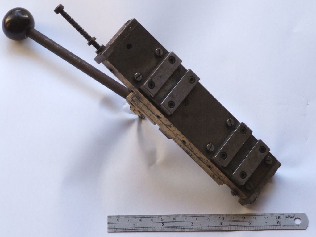

                                              #273869
                                              Anonymous
                                                As promised here are a couple of pictures of the Pultra cutoff slide:
                                                Andrew

                                                    #273993
                                                    Neil Lickfold
                                                      @neillickfold44316
                                                      That's perfect Andrew. I sent you a PM message.
