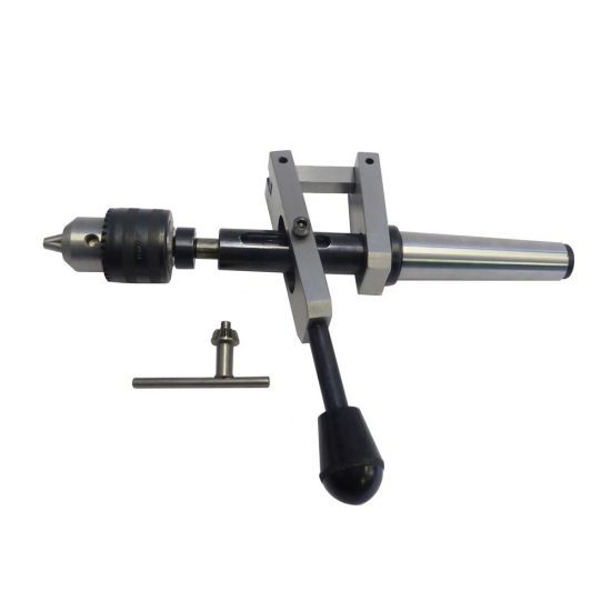

  • #588886
    Hopper
      @hopper
      Like this only more bigger

                Posted by Hopper on 09/03/2022 11:19:32:
                I'm thinking of having five bob each way and making a lever action "sensitive" attachment that fits into the MT2 taper in the existing tailstock, using a nice Jacobs 3/8" chuck I have kicking around. Handy for drilling small and medium holes then easily popped out to make way for a centre or bigger chuck.
                Myford call them a sensitive drilling attachment but I think I will make mine a bit bigger for general use.

                            Not obviously, Michael. The 1929 ME article was submitted by one H Dyer. His driller, as he calls it, looks much the same as the one Myford sells today, pictured in my post above of 9/3/22, only more elegantly shaped in the style of the era rather than Myford's Soviet Brutalist effort made from square blocks. And it fits into the taper of the tailstock, rather than clamp on to the tailstock itself.
                            I can't see any connection to the patents other than the most general of principals of having a clamp and a lever etc. But it is entirely possible that Mr Dyer had seen the patent, or patented item itself and based his design on the principles. Or it may have been a common idea that was done at the time by machinists and Tyden was the first to get around to patenting it. I guess we will never know.
                            I cant upload the original ME article as it is a PDF and this site won't accept it. But it is almost identical to the photo I posted of the Myford item but the two blocks are narrowed down where the link fits.

                                Warco list this (presumably Chinese) in 2mt and 3mt but it may take up too much bed length?
                                Edited By Nick Clarke 3 on 20/04/2022 09:39:57
                                #595176
                                Hopper
                                  @hopper
                                  Posted by Nick Clarke 3 on 20/04/2022 09:39:38:
                                  Yes that is very similar to the Myford current offering which is very similar in design and execution to the 1929 ME article, save the less rounding off of the two peices of flat plate there. Probably out of the same factory in India or China whre the Myford one is made. Or the factory next door who found one lying about and copied it.
                                  It would take up that extra three or four inches of bed length but for me that would not usually be a problem. And it allows quick change over from screw to lever action, albeit you would not be pushing a 13/16" drill with this one. The current Myford version I think has a 5mm max chuck. So it is a true sensitive attachment for small bits rather than the full sized universal tailstock lever attachment.

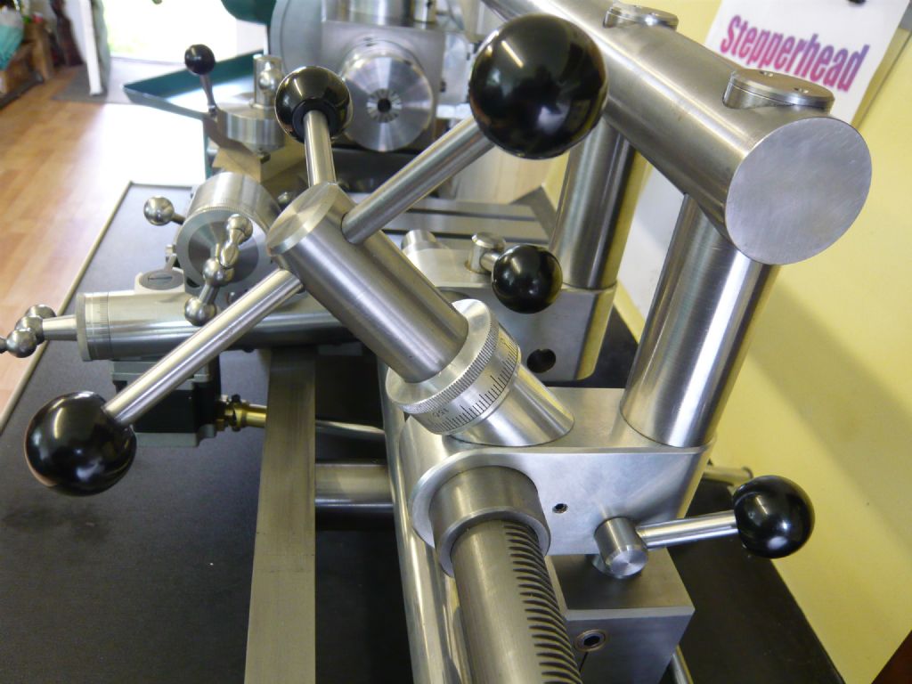

                                  Alan Jackson
                                    @alanjackson47790
                                    I much prefer this type, long range and sensitive
