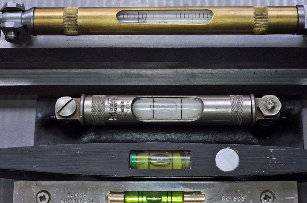

      I thought this photo might be mildly interesting:
      All 4 levels sitting on my surface plate. On the top "precision" level the bubble is hard against its stop. (They all show the same deviation when rotated through 180 degrees)

          Do they exhibit differing levels of precision or does each one have a different resolution?
          About half of the concept of 'precision' is repeatability (reproducibility being the other partner) and from your closing sentence, they all repeat very well. Perhaps enlist Mrs Jenkins to test reproducibility.

              Every one shows the tilt of the table, with varying degrees of sensitivity. I have a Moore and Wright 6" level with adjustability and a secondary bubble at rightangles, and have never known what its sensivity is. I should check it with slips and a sine bar one day.

                          From what I can see of the markings on the top glass I'd guess its nominal resolution is 15 seconds per division. If the bubble is supposed to fit closely between the solid lines, then I'd guess it's reading the plate as about 2 1/2 minutes out of level.
                          Considering how hard it is to read a 5 minute discrepancy on a M&W vernier protractor, I have to think this isn't much for most practical purposes.
                          Me, I've been using a grubby and scratchy (but pretty robust)  Stanley 43-220 for a lot more years than I can remember, and the books and even the titchy toy cars I've made haven't slid off the shelf…

                            Rod,
                            You now have to decide which one to believe.
                            Since they all show the same whichever way round, based on the lower ones, your surface plate is fairly level.
                            I would feel inclined to adjust the upper one,since it is supposed to be the most precise (finest resolution ) until it shows level, in both directions and then adjust any of the others to match.

                              I might stand corrected, but I'd *think* that since it shows similar deviation at 180 °, it's likely the plate that'll have to be adjusted.
                              The lowest level just doesn't have the resolution to show a 2 1/2 minute discrepancy, and the next one up can only just give an indication etc.
                              But then, what'll happen when the sun comes out, or a butterfly flaps in Kamchatka?

                                Probably the most important ‘take-away’ from Rod’s excellent demonstration is that it illustrates why it is futile to try ‘levelling’ a lathe with anything but a sensitive level.
