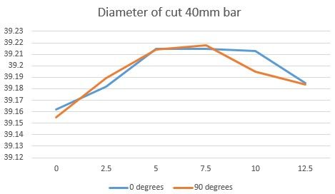

                              #662171
                              Iain Downs
                                @iaindowns78295
                                Headstock end, Benedict. Apologies if I mistyped earlier. I would say it's old age, but I've always been prone to typos!.
                                I have cut a 40mm bar in earlier tests and measured the diameter with a micrometer twice (one at 90 degrees to the other)
                                Yes I cleaned up the faces and as you can see I get very close agreement between the two sets of measurements. In fact most of the pairs of measurements are less then 5 microns apart.
                                At 40mm I would not have expected tailstock support to make much difference due to the stiffness. Also bringing the tailstock in would add an unwelcome extra factor.
                                Iain
                                #662173
                                Benedict White
                                  @benedictwhite51126
                                  If it is wider at the tailstock end, try tailstock support. Nothing is so stiff it does not bend.
