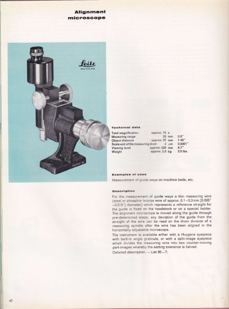

                            Posted by John McNamara on 01/04/2023 15:25:14:
                            Leitz Wetzlar made wire alignment microscopes, one of which was electrically controlled, so I was told.. I have not been able to locate a photo or specification for that one?
                            I don’t think I have ever seen the electrically controlled one, John … but this may be of interest:
                            Source: __ https://archive.org/details/pdfy-8Bodc5JEPZ0RGXru/mode/2up
                            PDF download should be available, but it seems to be struggling today.
                            Edited By Michael Gilligan on 01/04/2023 20:20:10

                              Hi Michael
                              Thanks for the info.
                              You are amazing you always know where to look.
                              They must have updated it. Apparently there is a later one as well. Maybe one will turn up!
                              I don't speak German. It would help if I knew the actual German naming convention for it.

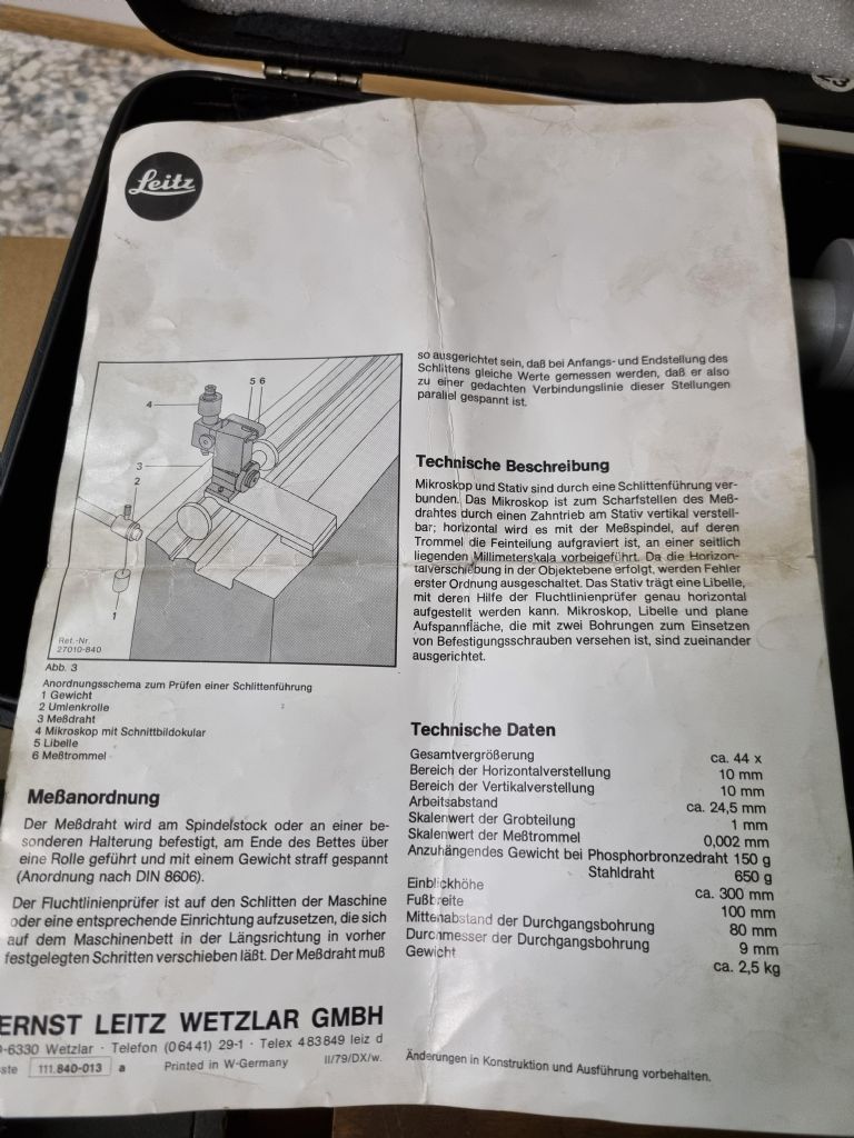

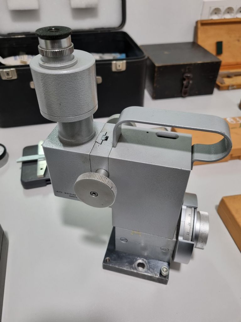

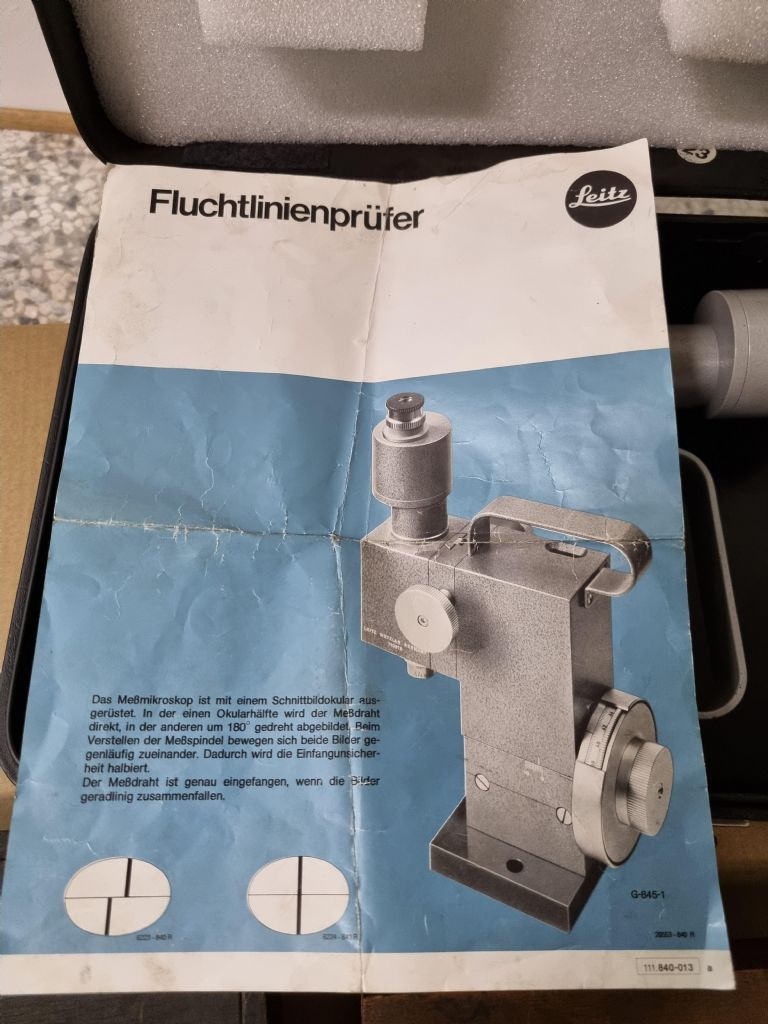

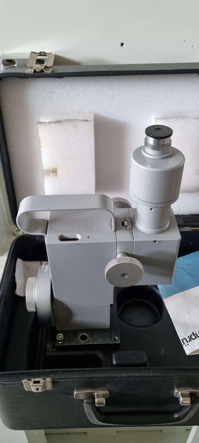

                              This is the one I have on the way.
                              It will be very interesting to test it out.

                                Very interesting, John, thanks for sharing the photos.
                                I don’t speak German, but fortunately most technical German is very literal and therefore translation is quite simple.
                                Fluchtlinienprüfer translates to Flight Line Tester
                                and it doesn’t take too much imagination to realise the conceptual similarity between a flight-line and a taut wire.
                                We did a lot of this rudimentary translation when I worked at KODAK in the early 1970s, but it’s much easier now … I just turn to DeepL when I see a tantalising word, instead of hauling-out the dictionary.
                                Edit: __ and there is even a Wikipedia page about them:
                                https://de.wikipedia.org/wiki/Fluchtlinienprüfer
                                Edited By Michael Gilligan on 02/04/2023 05:34:28
