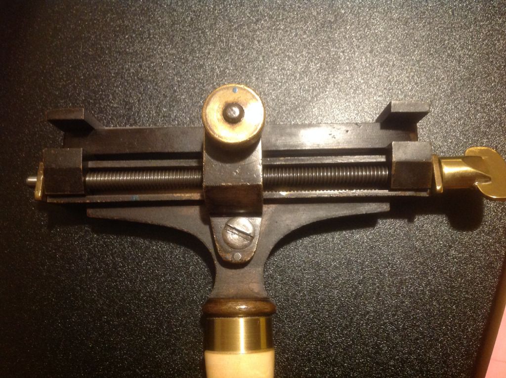

              I'm not sure how long the studding needs to be, but pictured is a six-inch long two-way* 1/4" BSW screw I cut on precision ground 1/4" stock using a woodturning lathe and a tailstock die holder. It is a replacement for an original screw that had been bent through careless usage and rendered the whole tool unuseable. The job was easy to do and the tool now works very well indeed.
              *i.e. right-hand thread one side and left-hand thread the other.
              Edited By Bill Phinn on 15/04/2022 00:38:25
