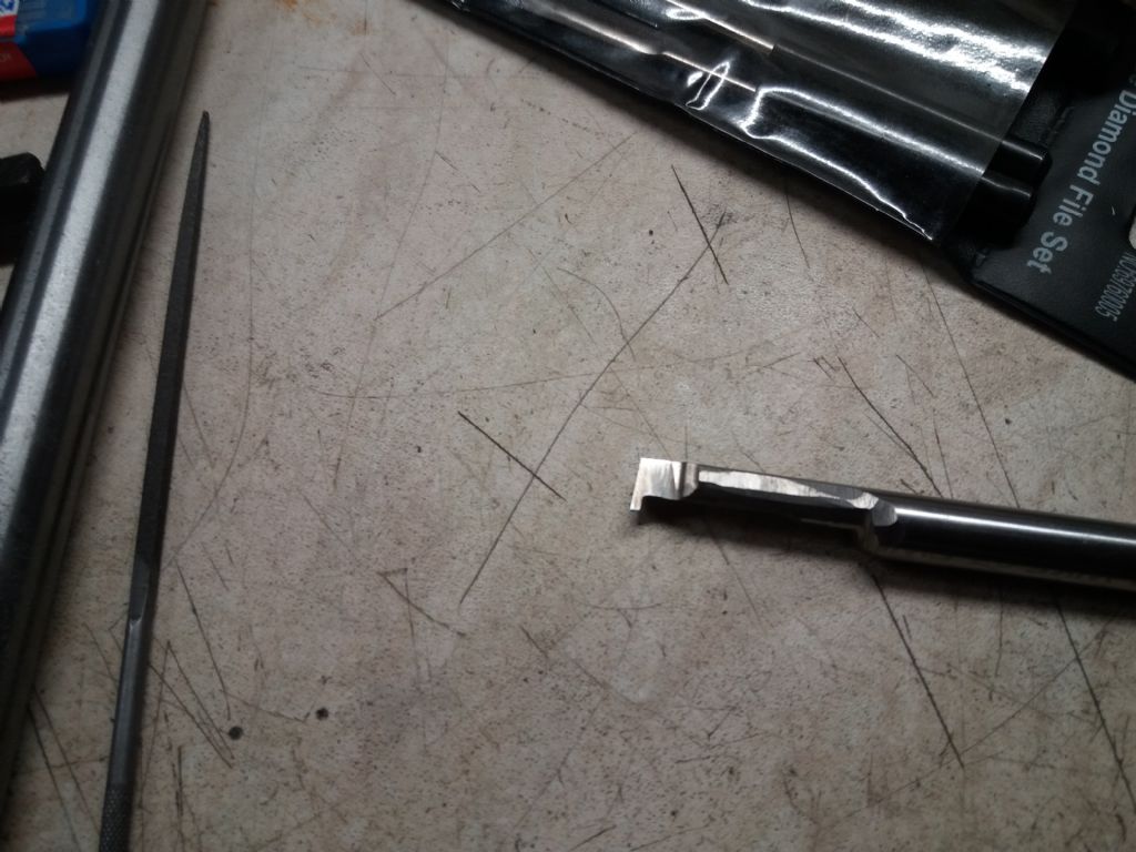

        I need to fabricate a feednut for my TS milling machine. The thread is 0.75” 5 TPI left hand Acme. Ideally, I would like to buy a carbide threading insert but this item appears to be very rare. So, it may come down to grinding my own tool.
        From watching videos from messers Booth & Rucker, they do not grind any relief on the top face of the tool. So in theory the tool could cut both right & left threads.
        Is this correct? I would appreciate your comments.

            One like this might do:

                    I have had exactly this problem with the Tom Senior LV nut for the Xaxis. 5 ACME is not available in smaller than er/ir 22 and tha minimum size that could be threaded internally would be 1" diameter. I got a tap from Tracy Tools, they do left and right handed taps. When I tried the tap in a piece of aluminium, I had doubts whether I could turn it, even though it was a very long taper. I used an ir 8 ACME insert ground so that only the main tip would cut and produced a partial thread with that at 5tpi. A bit of cheating with the compound widened the thread closer to the proper width, but the depth of thread was obviously lacking. This partly cut thread enabled me to complete the thread with the tap in the gunmetal nuts. The backlash was about 0.005", but that didn't matter, as I used two nuts for an antibacklash setup.

                        I recently did a 3/4-4 Acme. I hand ground the tool bit. The bar I used was 1/2". There was insufficient clearance for me to open the half nuts and crank the tool out. I had to leave the half nuts engaged, back the tool out a bit using the crossslide and run the spindle in reverse to get back to my starting point. With the that small a bar and the very coarse pitch it required MANY spring passes to complete the thread.
                        Be sure you have sufficient clearance on the proper side of the tool. Calculate the helix angle based on the minor diameter of the thread and add a few degrees to that to get the necessary clearance angle for the leading edge of the tool. The trailing edge of the tool need not have any clearance.

                            I think the $85 insert option from the States is a non-starter, especially as the insert may not fit in the hole!
                            I like old mart's idea of partially cutting the thread with an approximate form tool on the lathe followed by a tap.
