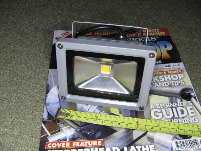

                                                      Here are two other LED light sources that others might find useful.
                                                      10 Watt LED floodlight.
                                                      These are available on ebay for about £11.00
                                                      They are claimed to be IP65 rated and are available in 12 V and 230 v versions.
                                                      The 12 V version does not work very well on 12 V DC but is OK on 12 VAC as this gives about 15 V when rectified inside the lamp. (They need about 15 V DC to work well.)
                                                      They are dicast so they are quite heavy (350 gm) so they would need a good flexible mount if used as a machine light.

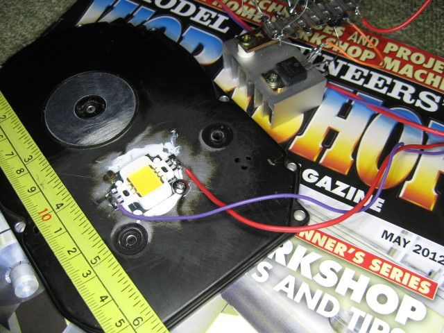

                                                      10 Watt LED array.
                                                      These 10 Watt LED arrays are VERY bright but they must be mounted on some kind of heat sink to keep them cool. The array is about 22mm x 30mm. There are two types. one is an array of three groups of three series connected LEDs connected in parallel. These reqire a voltage of about 9 to 10 volts. Like all LEDs they MUST NOT BE DRIVEN from a constant voltage source. They should be driven from a constant current source (900 – 1000 mA for this type. ) which can be as simple as a contant voltage supply a few volts above the LED voltage with a suitable series resistor. THe picture shows one of these arrays mounted on the lid of a 3.5" disk drive for cooling. The components above the disk lid are a proper constant current source. The second type of these LED arrays is made from nine LEDs connected in series. These require a CONSTANT CURRENT of about 330 mA. The voltage across this array will be about 20 – 30 volts.
                                                      I have bought 5 of each type for about £7.50 (About £1.50 each.) to try out. (The second type has not yet arrived.)
