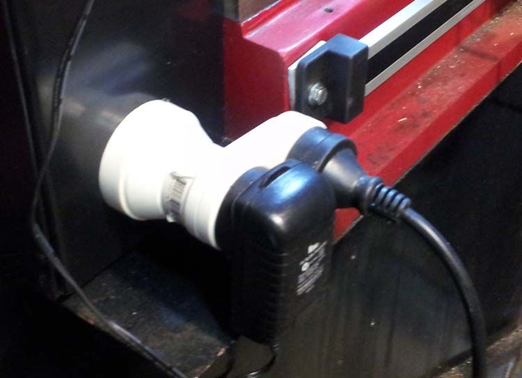

        I have used an old 12v dc plug pack to power the LED's. Also mounted a power outlet on the outside of the mill column and wired it to the main on/off switch on the mill. Added a double adaptor to supply power to the plug pack and also to the power feed. When the mill is turned on, the power feed and the LED's also come on.

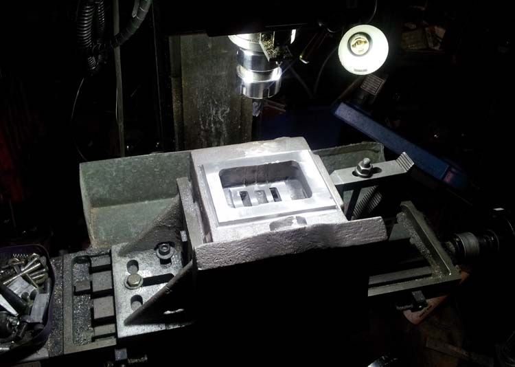

            Inspired by John's picture I just went out to take a photo of my mill lit up with a hurricane lamp, but my blooming camera's gone flat.
            Edited By Stub Mandrel on 05/03/2013 20:11:04

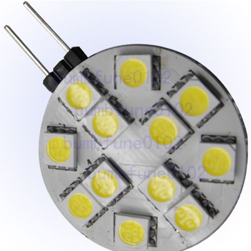

                              The reason for the LEDs not comming on until the voltage exceeds about 8 volts is that LEDs behave a bit like a zenner diode. They do not start to conduct until the voltage across them exceeds a certain value. This is about 3 volts for white LEDs and about 1.8 for red LEDs As you LED arrays will have groups of 3 LEDs in series they are just starting to conduct with about 2.7 volts across each one. As Neil pointed out earlier on this thread you can consider the array as 3 LEDs in series with an 8 ohm resistor (In the type of array I bought) at 12 volts the voltage across the 3 LEDs was 9.3 volts and 2.7 across the resistor which gives acurrent of 2.7/8 = 338 mA As the voltage across the LEDs stays more or less constant with a 15 V supply there would be 5.7 volts across the resistor giving a current of 5.7/8 = 713 mA.
                              The arrays I bought used type 5050 LEDs which is actualy a package containing 3 individual LEDs. Looking at the data sheet on this device I could not decide if the disipation rating refered to the package or each individual LED so I do not know the maximum current it would be safe to pass through each LED.
                              For another project I bought some of these 12 LED arrays
                              12 volt g4 12 led array
                              Here is some information on this type.
                              The array consumes about 110 mA with 12 volt supply.
                              The 5050 LED package contains 3 LED's
                              The LED's are arranged as follows.
                              The three LED's in each package are connected in parallel.
                              They are arranged as 4 groups of three LED packages. The 4 groups are in parallel. There is asingle 10 ohm current limiting resistor in the negative lead. There is a bridge rectifier (4 seperate diodes) so they can run on AC or DC
                              110/4 = 27.5 mA So each package of three LED's passes 27.5 mA Each LED within the package passes 9.2 mA
                              12V – 1.2V (For drop in bridge rectifier) = 10.8 V
                              Drop across 10 ohm resistor = 10 * 0.11 = 1.1 V
                              10.8 V – 1.1 V = 9.7 V
                              As this is across 3 LED's in series each LED has 3.23 volts acress it.
                              Les.

                                          Ironically got a parcel today from ARC and it it was a LED machine light.
                                          It's on a magnetic base, bendy spring type that stays where it's put, and a nice turned and milled alloy head that holds 3 triple A batteries.
                                          Push on, push off switch on the end. O and I nearly forgot, the magnet has a keeper on it the exact same size as the magnet so don't try to stick it down without removing the keeper.
                                          Not that I'd do that of course crook
                                          Shot taken at night with one overhead light on.
                                          Same shot with no lighting at all.
                                          The head unclips and can be used as a torch. Very impressed with this as you can get the light exactly where you need it and no trailing wires. Won't suit everybody but I'm well geared up for AA and triple A's in rechargable format.
                                          Now need to order a couple more or at least one more so I can have a light either side.
