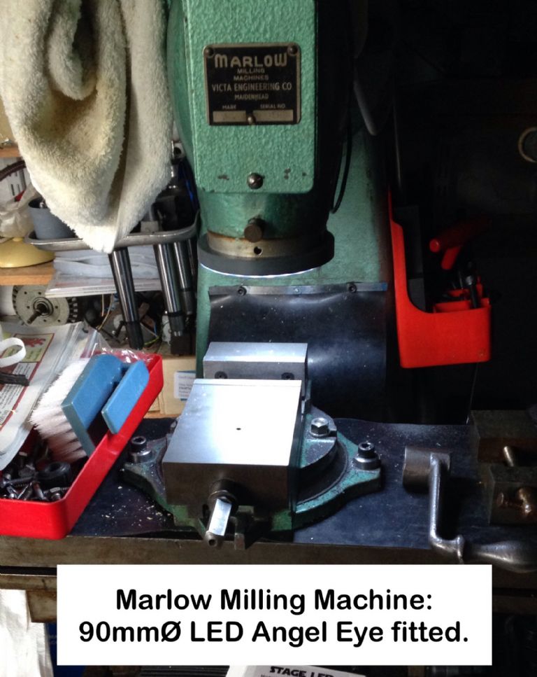

              John,
              Marlow Milling Machine.
              I still use the two machine lamps where necessary though.
              The angel eye on the drilling machine is marginal as the chuck casts shadows so am thinking of either adding or doing a new one with larger dia. angel eye.
              Check my Album: Angel Eyes LED Light
