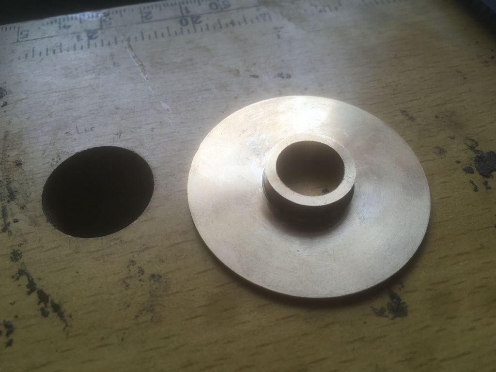

      I faced off a batch of brass discs to 1.5mm thickness the other day holding the work by a 16mm 'spigot' on the rear of the work in the three-jaw:

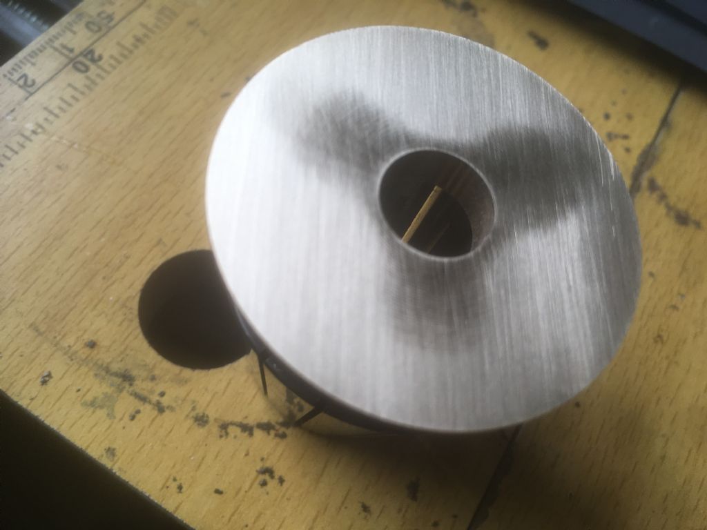

      When I started to polish the faced surface I was surprised to see:
      The dark areas are 'low' with respect to the rest of the surface, probably by ~40µ at deepest.
      I assume that the disc was distorted and 'bulged' in the areas between the chuck jaws, then relaxed and that's what caused the hollows.
      I could have used a collet chuck, but being lazy I didn't want the faff of changing chucks. I have paid the price in time/elbow grease/sheets of wet'n'dry!
      The point of this post is just to document one of the many things that don't work*.
      Robin.
      * "But the student will find that experience is the best teacher. The reason why I get along with comparative ease now is because I know from experience the enormous number of things that won’t work." 1882 June 15, The Christian Union, How to Succeed As An Inventor by Thomas A. Edison, Page 544, N.Y. and Brooklyn Publishing Co.,

              I don't think the chuck forces caused it to bulge. More likely the 3 jaws supported the work infront of then and the rest distorted away from the tool leaving them slightly thicker as they spring back. Though you may find the hole is distorted where the chuck has closed up the thin spigot in 3 places.
              Lighter cuts, sharper tool or some form of rear support would cure it, collet would just see a conical shape as the whole outer unsupported area get pushed away for the whole 360deg.

                Just to emphasise Jason's point above, the distortion is not due to the radial gripping action or squeeze of the chuck jaws, but due to the work springing away from the tool due to the axial force when cutting. The shadow of the jaws is because there is resistance from the rear (the structure is stiffer at those points).
                You could test this by using a longer spigot so there is an air gap between back of work and face of jaw. It would then be conical and concave.

                                Thanks for replies. I should have said that when I noticed the effect I checked the spigots for witness marks showing where the chuck had gripped. They were there, and the jaws had gripped the spigot at (eyeball accuracy!) 60° to the depressed areas, so the front faces of the jaws were behind the 'raised' areas. That observation got incorporated in my thinking about the cause and was implicit in my speculative explanation, but I should have mentioned it explicitly. Sorry!
                                If I have understood the axial deflection explanation correctly the pattern should be the other way round if it is right.
                                The discs were faced using a fresh 0.4mm radius CCGT insert (Arc Euro Trade), so sharp(ish). Roughing cut ~0.5mm, finishing cut ~0.05mm. So very little axial cutting force for the finishing cut I would have thought?
                                I take old mart's point that it might have been better to make the hole last – sequencing of machining operations is an aspect of this hobby I find particularly challenging. I guess it comes with experience – I didn't anticipate this effect so no amount of planning would have helped. The reason for the steely appearance is that I had to adjust lighting to display the contrast between the areas, and that must have mucked up the colours on my phone camera.

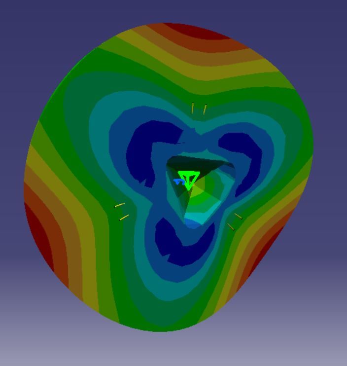

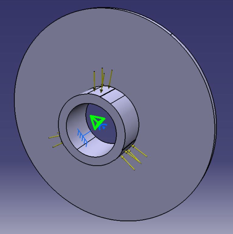

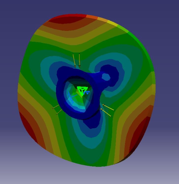

                                  Generic FEA of the part you are trying to machine. First picture shows the model with jaw forces applied. Second and third pictures both show the way the parts deflects, Values are not important it is the indicative pattern we are interested in. Blue is small, red is large relatively.

                                    Wonderful FEA Dave, that's pretty much a perfect match.

                                        Posted by Dave Smith 14 on 06/09/2022 12:20:30:
                                        Robin
                                        Regards
                                        That's fantastic Dave, thank you! I don't fully understand the pictures though – are the deflections in the plane, normal to the plane or what? The pattern certainly seems to correspond to my observation.

                                        #612661
                                        Dave Smith 14
                                          @davesmith14
                                          Robin
                                          The part deflects along the axial plane. So the red maximum deflection zones bend backwards towards the headstock.
                                          #612664
                                            Posted by Dave Smith 14 on 07/09/2022 11:03:18:
                                            Robin
                                            and therein lies the twist
                                            Robin clearly stated “ The dark areas are 'low' with respect to the rest of the surface, probably by ~40µ at deepest.“
                                            Which means the ‘mechanism’ is : the red areas move towards the headstock, thereby reducing the cut, and the depressions form when the workpiece is released.
                                            Now … if we could use that in a controlled manner imagine what subtle surfaces could be machined !

                                              Robin Graham
                                                @robingraham42208
                                                Robin
                                                Thanks for clarification Dave – now you say it I see the perspective in the images to which I had been strangely blind.
