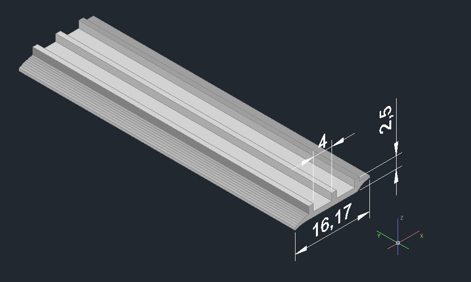

      Hi Rebekah
      If you have access to Acad 2013 you should be able to open it as a DWG file.
      **LINK**

        Hmm Browsing around the web it appears Lazycam cannot import 3D DXF files properly.
        There is some mention of the pro version doing it better, maybe, You also need a Full version of Mach 3 or you will only get the first 50 lines.
        Not that good really.

                  John McNamara
                    @johnmcnamara74883
                    Hi Rebekah
                    Yep It works…
                    Well done.
                    Regards
