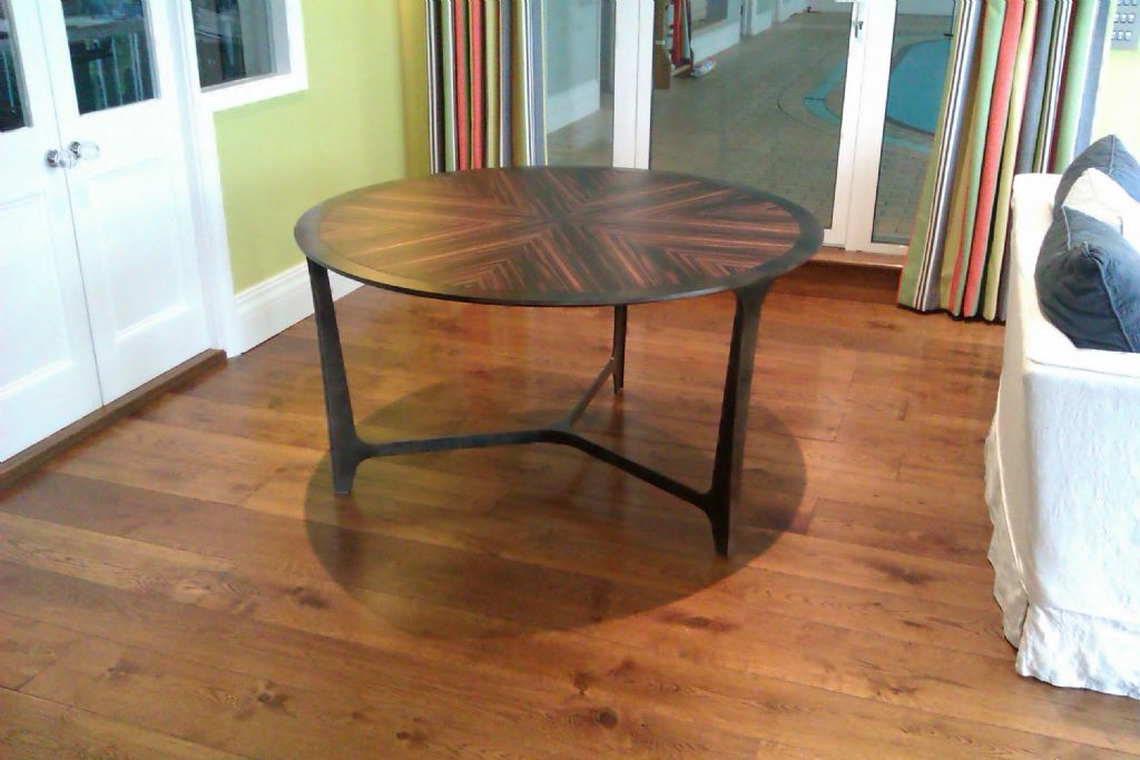

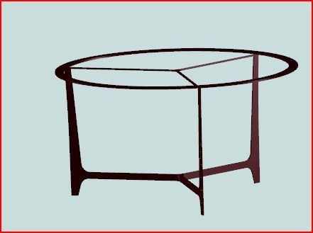

              Jason, is that a stock scene of a room with a rendered table placed in it or is it a photo? It gets harder and harder to tell these days!
              Mark

                  #133891
                    Posted by Mark C on 27/10/2013 18:59:15:
                    Mark
                    Its the real thing, I drew out the steel frame parts and e-mailed them to the water jet cutters, welded & painted them up and veneered the top in macassar ebony. Doors to the left are by me as well.
                    J
                    #133894
                    WALLACE
                      @wallace
                      Hello Jason – was that done with the full version of ‘Design’ or the ‘Design Elements’ ?
                      Thanks.
                      W.
                      #133896
                        Just PE which is now Cubify Design which was about £169, think its £185 + VAT now though possibly cheaper if you buy from the states rather than UK reseller.

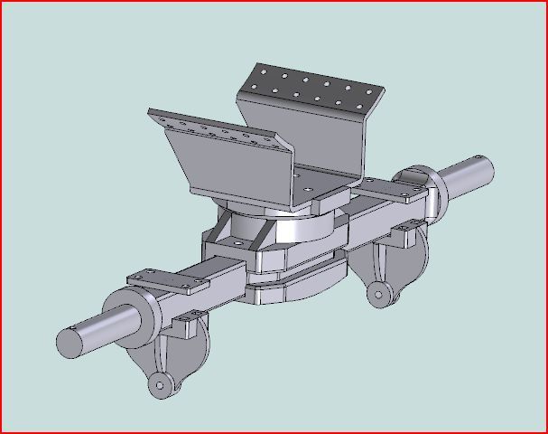

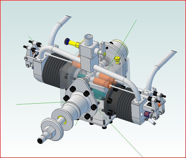

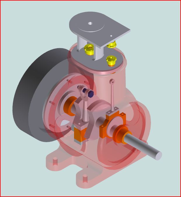

                        #133905
                        Mark C
                          @markc
                          Phil, I have been using Solidworks for around 15 years now, so I have had some practice. The software just gets better and better but there are some things it really should leave alone (automatic dimensioning of drawings for one thing).
                          Here is the motor in exploded **LINK** and if you don't have edrawings or don't want to install it, you can use the executable version that opens without the need for the viewer installed by using this instead **LINK**
                          John, thanks for pointing me in the right direction for sharing files etc.
                          Mark

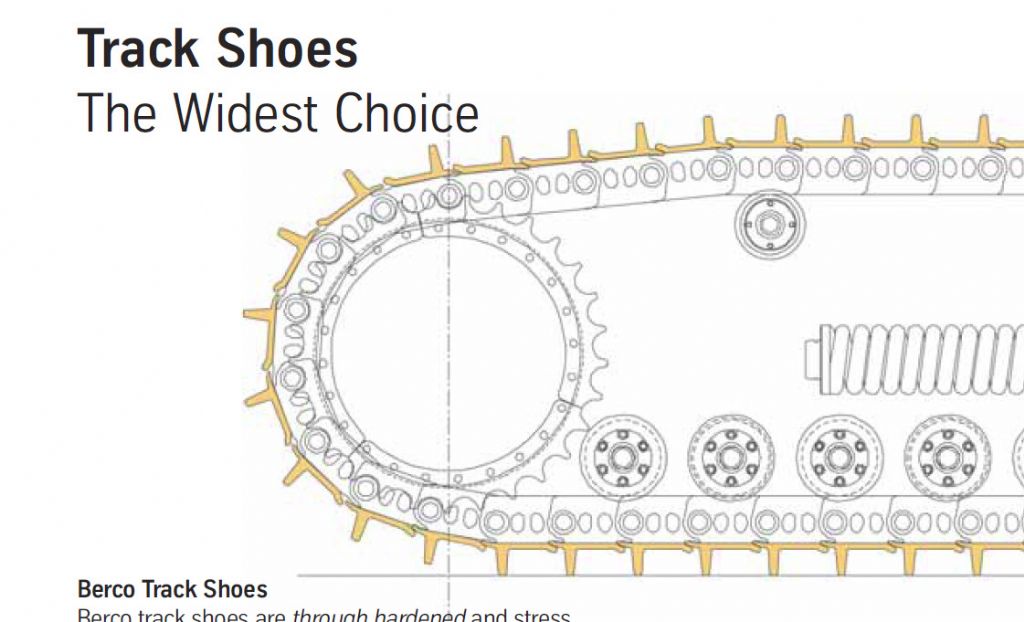

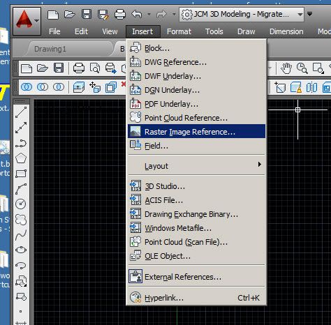

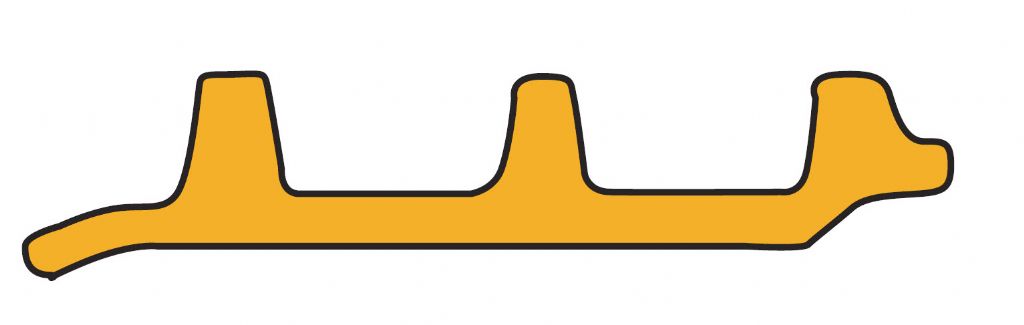

                              Hi Rebekah
                              I had a look at David Jupp's Link. The tracks for excavators do look similar to your posted image. I selected one B114 for an exercise.
                              I screen grabbed the profile.
                              Then imported the image into AutoCAD as a background to trace on

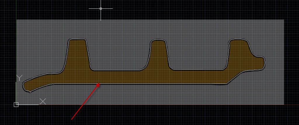

                              Then traced over the image with a polyline (and closed it)
                              In order to be able to see the trace line I set the transparency of the imported image to 70%

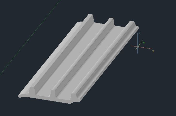

                              b114 extruded.jpgFinally the image was extruded
                              You can then scale the object to the size you want it is better to trace first then reduce to increase the accuracy of the trace.

                              rebekah anderson
                                @rebekahanderson95322
                                sweet, thats a very cool tool.
                                i have got a file now (i think)

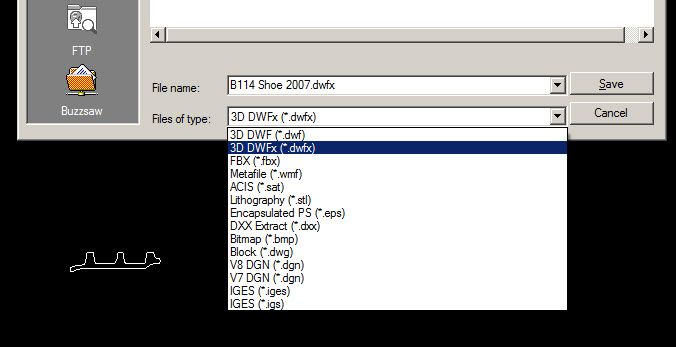

                                                      Hi Rebekah Hi All
                                                      Lets hope there are more ways to skin a ……..
                                                      The screen grab below shows other formats Acad can export to, Is ther one that might work? I will post if there is?
                                                      Check if you program can read any of these?
                                                      Regards
