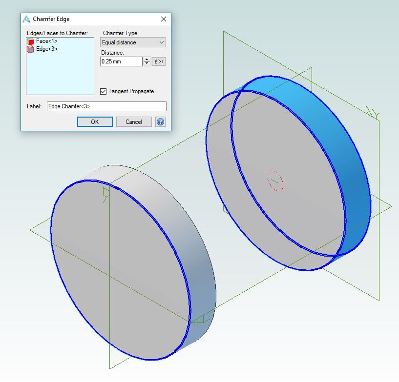

      Regarding the chamfer it sounds like you are clicking on the "face" of the cylinder and will be getting a wide blue band. You need to click on the black line that is the edge which will then turn blue.
      I did do a video of drawing that part which you may have missed
      Edited By JasonB on 22/11/2018 19:26:18
      #381891
      duncan webster 1
        @duncanwebster1
        Thanks Jason, not exactly a thick line, but definitely blue, and it then does as expected, so that's one bit sorted
        #381892
          It will go blue as your cursor hovers over it and then when clicked give two darker blue lines at the extent of the chamfer, my pic shows those two lines but very close together as length of chamfer is default 0.25mm

            update, I've found I can draw a circle anywhere then constrain it to be coaxial with the first, but it seems a long winded way of doing it, snapping to axis would be a lot easier
            #381900
            duncan webster 1
              @duncanwebster1
              #2 son came round I'm now cooking on gas. Reading the instructions would have been good, you hold down both buttons to rotate!

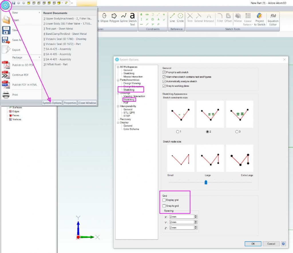

                    Posted by David Jupp on 22/11/2018 15:51:19:
                    Another tip for getting back to showing the whole design (zoom extents) – press the Home key on the keyboard..
                    That also reminds me – you can program pretty much every button function to a keyboard shortcut of your choice. You can even override the default shortcuts if you prefer.
                    The Home key doesn't appear to work for me. I looked under Help to see how to edit keyboard shortcuts and it was supposed to be under System Options, but doesn't appear to there for Atom. Is it a Design only feature?

                        John, it must be something on your keyboard as "Home" will take a 2D drawing back to showing the whole sheet.
                        System options has workspace options which include keyboard options, same place where grid etc is set but as said to Duncan Atom may be different.

                          First – Apologies – I hadn't checked Atom3D thoroughly, editing keyboard shortcuts is NOT exposed in the Atom interface.
                          Grid / Snaps has been mentioned before in this thread – there are separate settings for sketching and for 2D drawings. See image for how to access

                            This is not an option in Atom3d. The System Options under All workspaces are General, Sketching and Mouse Interaction only, whereas under Keyboard shortcuts in the on-line help is is pictured as General, Sketching, Keyboard Shortcuts and Mouse Interaction. Pressing the Home key on my PC does nothing either.
                            BTW does anybody know how to include screen dumps or images from the clipbqoard, I can only see how to add a file or from a URL, which sure makes describing a graphics package cumbersom

                                    I made my screenshot and annotated it, then saved the file locally. Next I uploaded the image to an Album on this forum (see Albums in the green bar near very top of forum). I then used the Camera icon in 'Post a Reply' to add image from Album to my post.

                                      Duncan, further to Davids post above this only works with circles drawn in the same sketch, not if sketching on the end of say a previously extruded cylinder unless the first circle was on an axis
                                      Edited By JasonB on 23/11/2018 08:50:36
