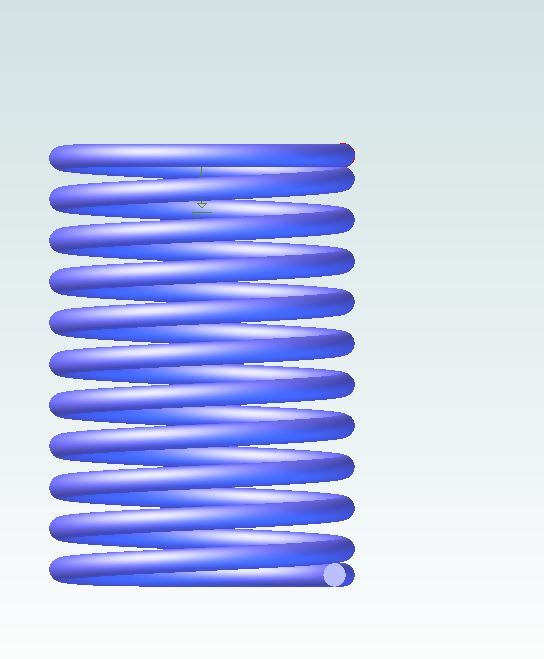

  • #381597
      Have you tried a spring yet?
      Or Knurling?
      Edited By JasonB on 20/11/2018 21:00:14
      #381633
        Is the knurling a double cut?
        #381635
          Yes you will need to do two helical cuts in opposite hands and use circular pattern to get multiple cuts around the rod. Have a look back at my "Sketches" album for a few more pics from when someone was asking about using screwcutting to form a knurl.
          Like screw threads it takes up a lot of memory so will slow things down so not worth using for visual purposes.

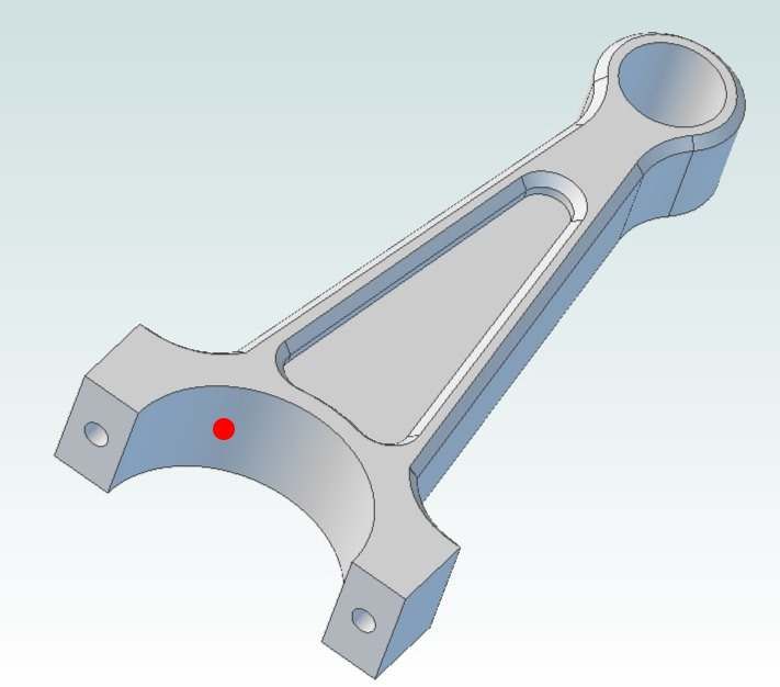

          #381648
          John Hinkley
            @johnhinkley26699
            As previously posted on this thread and others, I'm refining my engine design and come up against another problem. I wish to "drill" an oil hole in the conrod for the escape of pressurised oil from the crankshaft as depicted below and with the position roughly as indicated by the red spot. That is, centrally placed in the longitudinal bearing surface and radially at 45° to the median. I've tried a number of methods, none of which are viable. Any advice, please?
            conrod
            Thanks,
            #381649
            David Jupp
              @davidjupp51506
              John,
              You'll need a plane or an existing flat face to place the sketch of the hole outline on. Create a new plane having the required orientation. You may have to tackle this in more than one step – for example create a plane at specified angle to an existing plane – then create another one that is offset from or at another angle to the first (just an example).

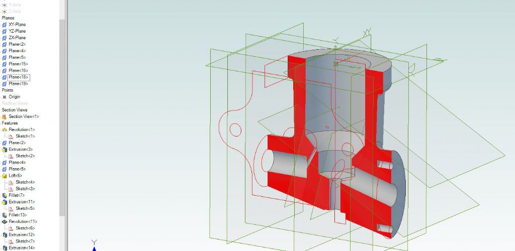

                As David says you need an angled Plane. Not quite sure how Atom handles then but when I had the basic Albre PE I often found it easier to draw a simple shape with one edge at the angle I wanted and then extrude it. you can then add the plate using the surface just created as the reference. That extrusion can themn be suppressed so it doe snot show on teh finished part.
                This is a valve body that has quite a few planes added both for the flanges and also angled ones for the passages.

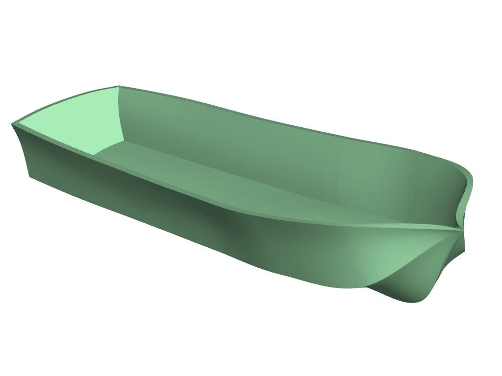

                    #381671
                      Posted by John Hinkley on 21/11/2018 12:19:27:
                      Thank you, David. I didn't know that you could introduce new planes! I'll have to look that up and play around with it this afternoon.
                      The planes are very powerful. I made this 'hull' but creating a plane (parallel to the original X/Y plane) for each section on a plan, drawing the sections on the planes and lofting the shape. I used the same technique for the aircraft I have posted above.
                      #381690
                      John Hinkley
                        @johnhinkley26699
                        I did it! Just set up a new plane with a right click, select the geometry and angle. Select the newly created plane and drew a circle which was then extrude cut "all through". Whether that will work with more complicated designs remains to be seen, but it's a start.

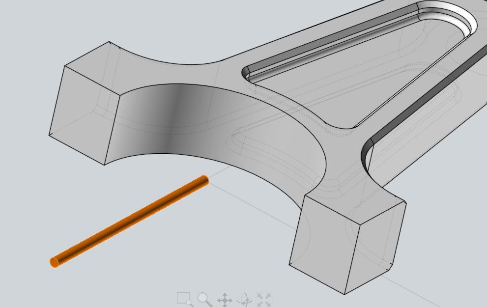

                        blowlamp
                          @blowlamp
                          Posted by John Hinkley on 21/11/2018 10:24:33:
                          conrod
                          Thanks,
                          Would Atom let you draw a long & thin rectangle at 45 degrees on the mid-plane of the conrod that could be 'Revolved' around either of its long sides to create a solid cylinder which could then be 'Subtracted' from the conrod to leave the oil hole?
                          Martin.

                                  #381723
                                  blowlamp
                                    @blowlamp

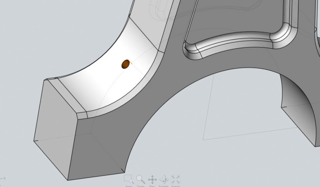

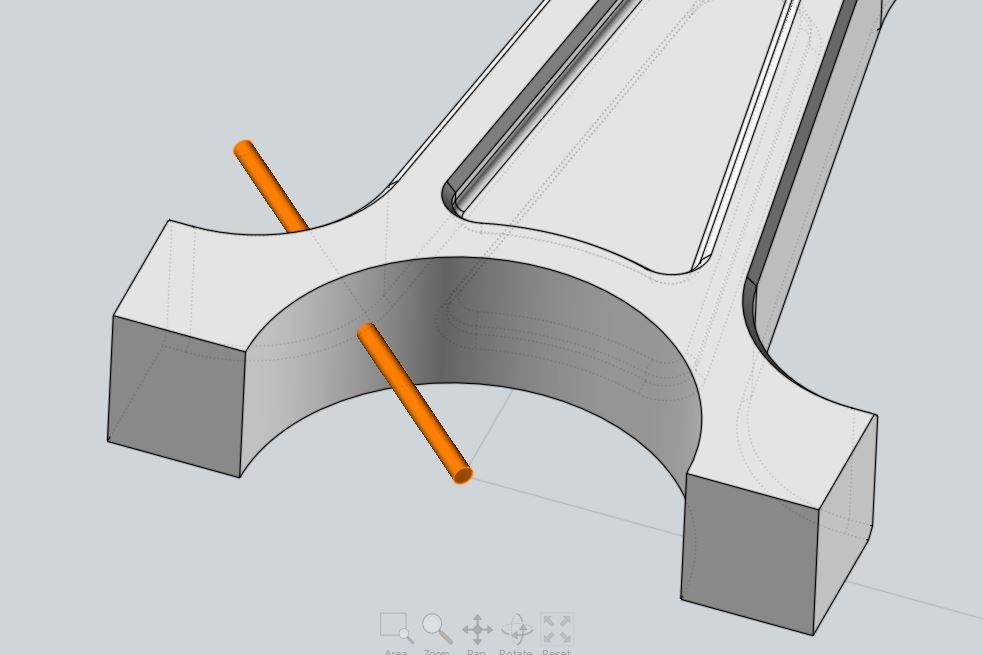

                                    I don't have Atom, so for fun, I had a play in MoI.
                                    The thickness of the conrod is centred about the Origin plane i.e., equally above and below the plane, whilst the big end bearing is centred at the Origin.
                                    I created a long cylinder (orange colour) in the first picture from a solid primitive (rather than a revolved rectangle) with its end centred on the Origin and pointing down along the Y axis.
                                    In picture two, I've rotated the cylinder about the Origin into the 45 degree position.
                                    Picture three shows the result after subtracting the cylinder from the conrod.
                                    Martin.
