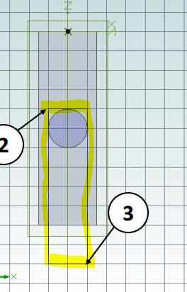

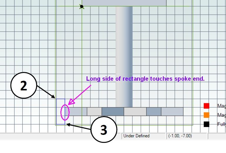

                      The rectangle which is revolved to form the wheel rim is shown in the exercise manual as drawn just touching the end of one of the spokes.
                      Rectangle corner indicated by circle 3 in the Manual should be at same Z co-ordinate as end of spoke.  Are you definitely sketching on the YZ plane ?
                      The rectangle is only blue whilst being 'dragged' – as soon as you finish placing it (click on second corner) it'll switch to another colour. The image in the manual looks to me as though it has been snapped just before clicking that second corner.
                      Does you wheel rim have a diameter that is too large, or is it 'out of plane' with respect to the spokes?
                      Edited By David Jupp on 17/11/2018 16:25:18

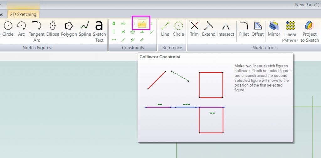

                        You may be able to fix the position of your rectangle by applying a co-linear constraint between the spoke end, and one side of the rectangle.

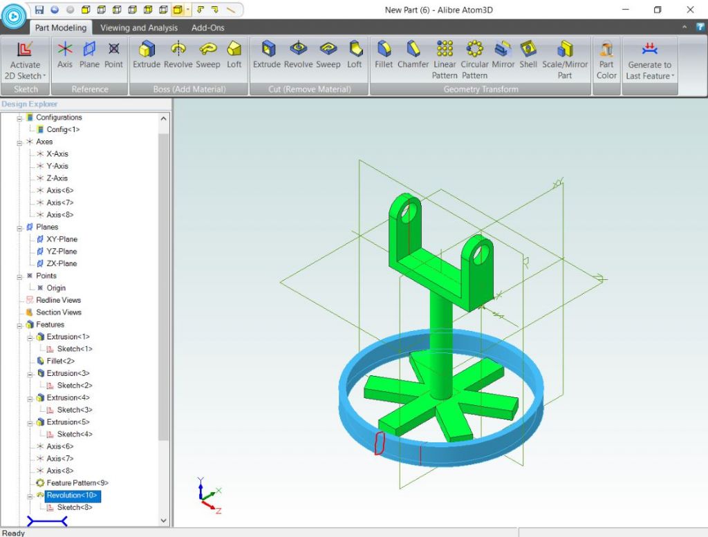

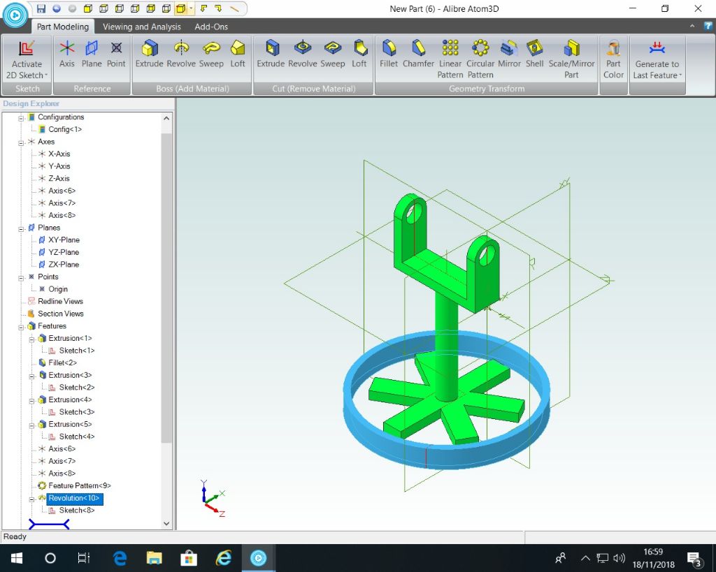

                                  Another day another problem. I still can't get the rim to contact the spokes and I can't seem to upload a screen shot, so I've sent the screen shot to Neil to post. Started the base, first thing is I don't have a grid option in the ribbon and so can't turn off 'grid and snap' or check DOF color is on. I've generated the base but the rectangle by two corners won't generate a rectangle on the face of the base, also I don't appear to have a rectangle by three corners option available. Thanks.
                                  #381267
                                    Mick, are you looking at the Alibre design tutorial again as those are not Atom options in the ribon, they are in design. Once again you need to be using this tutorial
                                    Edited By JasonB on 18/11/2018 18:36:52
                                    #381288
                                      Hello Mick, here's your pic:
                                      The basic problem is clear enough, you need to move your rectangle so that it's touching the end of a spokes before revolving it.
                                      #381290

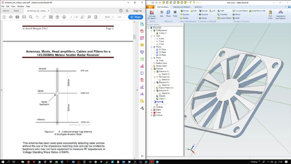

                                              As you must be using Windows 7 or later, you shoudl be able to switch windows easily enough, no need to save and close.
                                              Or drag the top bar of the alibre window to the right side of the display and of acrobat to the left edge.
                                              You will then have the two windows occupying the two sides of the screen like this example:

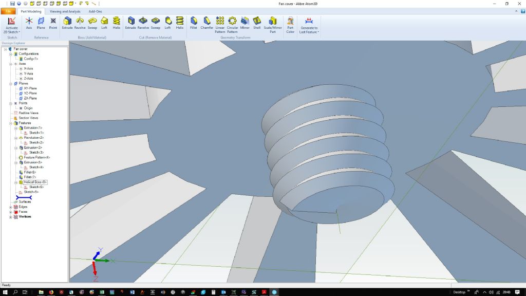

                                                    #381596
                                                      Quick and dirty test of the 3D Helix tool, rough and ready M6 thread:
