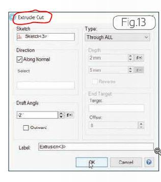

        Today's problem. I've got to the stage of the 6mm through hole. The extrude Boss dialogue box doesn't have the option 'Through All' in the 'Type' drop down box as shown in Fig 13, the only option that looks remotely like it says 'duel depth' which doesn't work. When I type 'Z' into the draft angle it becomes red and disappears when I click okay. Graph paper and G code still looks pretty good!!
        #379989
          You need to use the CUT extrude not BOSS extrude.
          Edited By JasonB on 09/11/2018 17:39:47
