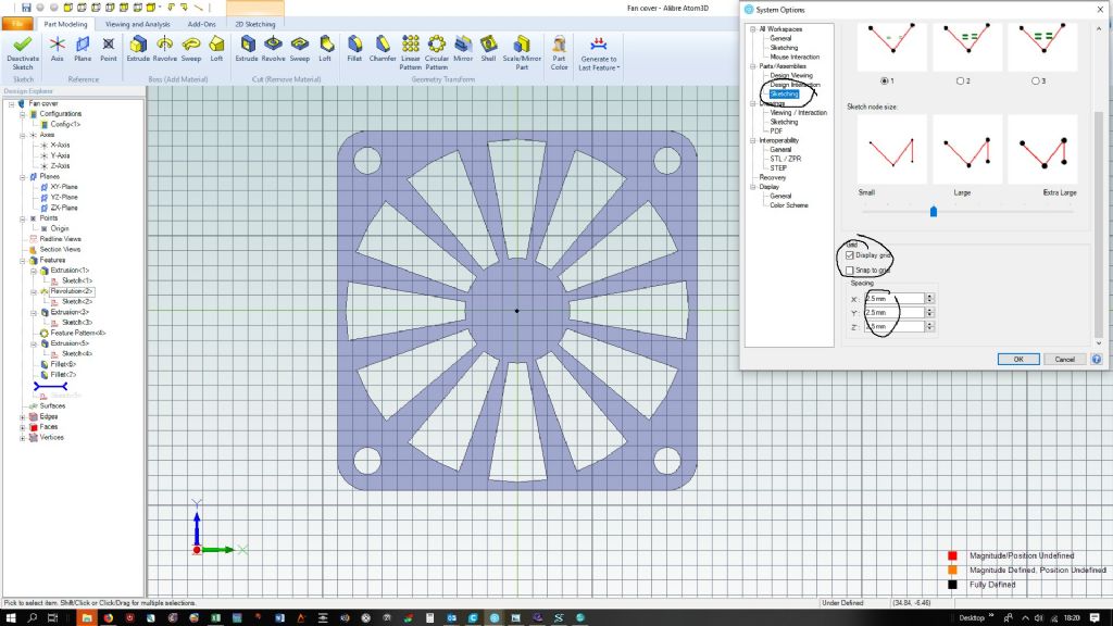

      25" sounds big, are you sure you are not on metric somewhere and getting a 25mm grid?

        My error!
        You need to change the grid size and visibility under Parts/assemblies so it shows when in Part Modelling view.

        David Jupp
          @davidjupp51506
          NOTE there are separate Grid settings for Drawings – sketching and for Parts/Assemblies – sketching.
          Both are accessed through System Options, they are independent of each other.

          Paul Abrams
            @paulabrams18342
            It definitely measures 25". If I draw a line in 2D starting at one grid line and over to the next, the box reads 25"
            I normally work in metric and a new drawing starts in metric but I have changed the current drawing to inches! My existing Design Exercise Manual drawing is measured in inches.
            In System Options – Drawings – Sketching – I'm ticked in Display Grid and also Snap to Grid and – X: 1.000"
            In Properties – Units – General – Display Units – I have Inches in the drop down box.
            Is there another place I should be changing or has Alibre 'frozen' on me – Everything else works??

                Posted by Paul Abrams on 06/11/2018 19:27:10:
                Go to the group above "parts/assembly" and then sketching and change the grid sizes there.
                The drawing grid can just be used as an aid when setting out your 2D drawing. If you want a grid when doing the 3D model then that is your "Part" so use parts/assembly to set the grid.

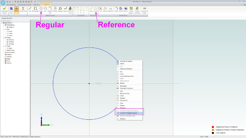

                                  I've been through all the posts here and no one seems to be having the problem I've encountered using the step by step tutorial in this month's MEW. I successfully reach the stage of creating the 25mm circle, however the circle isn't a solid circle but interrupted, when I click the green tick to deactivate sketch the circle disappears and so it will not proceed to the next step. I closed the software and started a new component but the same thing happens each time. I fully appreciate the problem must be the finger controlling the mouse but I would like to know what I'm doing wrong.
                                  Thanks.
                                  #379798

                                    Posted by mick on 08/11/2018 17:26:39:
                                    Might be a reference circle (which is dashed) and is intended to aid sketching, not be part of the sketch itself.

                                      Thanks Andrew. How do I produce a solid circle? I think this learning curve might be a tad on the steep side!!!!

                                      David Jupp
                                        @davidjupp51506
                                        Mick – sounds like you have drawn a reference circle (reference figures produce dashed lines – they can be useful for laying out your geometry, but they don't actually get used when creating 3D features).
                                        You can either right click on the reference circle (in sketch mode) and choose 'convert to regular figures' – or choose the circle tool from the 'Sketch figures' part of the ribbon and create a new circle.

                                        mick
                                          @mick65121
                                          Okay thanks, I'll go back and try again. All this is the reason I'm still a G code man!!!!!!!

                                            @mick65121
                                            It does work better when you click on the correct circle!! Just as well the tutorial is in monthly instalments!!
