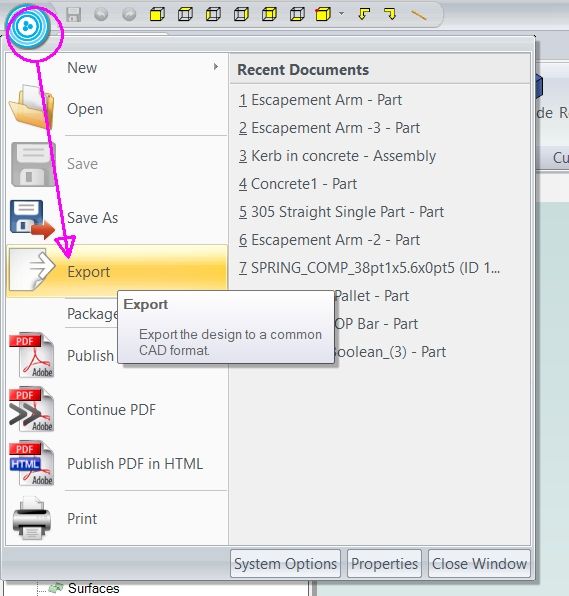

      Yes, I can see that would be an easier way – but my copy of Atom3D only gives the option to "save as" files with a ".AD_PRT" extension. Is this is the only file format that will be available after the trial period?
      Probably better asked of David Jupp?
      #378755
      David Jupp
        @davidjupp51506
        John,
        Try Export instead of Save As – see image. STP, ACIS(SAT) and STL are available.
        #378759
        John Hinkley
          @johnhinkley26699
          David,
          Thank you. Don't know why I didn't think to do that!

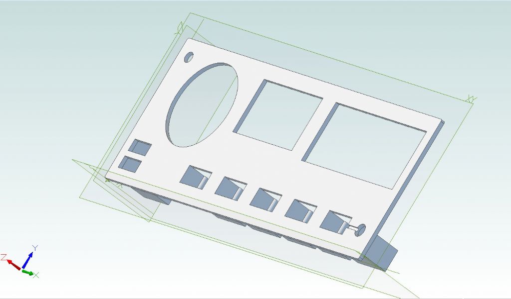

                            You can switch the 3D view between perspective and orthographic, but then I had a shock when this part was rendered as getting bigger as it went 'into' the screen!
                            I checked and the setting is orthographic too!
                            It's actually an optical illusion! Calipers on the screen reveal the panel is drawn the same length at each end, despite appearances.
                            This does show an interesting possibility of 3D printing. I've printed a load of two-part shells for 30-amp connectors to clip into the panel, then I realised that I could print holders directly into the panel (like for the dual USB connector). I will either glue them in or add a simple clip to stop them lifting out.
