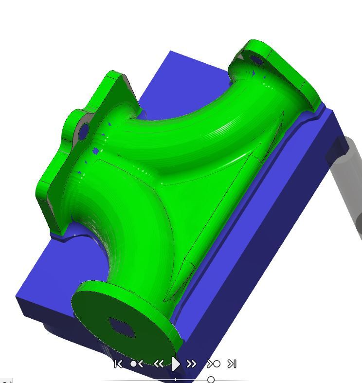

      Had a quick try of the trial while drinking a mug of tea so easy enough to pick up, initial thoughts are it's more basic than F350 and has limited 3D both roughing and finishing but need to play with it some more.
      This is the simulation of a part in MeshCAM (Alibre Workshop) with parallel finish
      And same in F360 with "Steep and Shallow" that keeps the same distance between cusps
      metal one is part way through.

      David Jupp
        @davidjupp51506
        Jason is correct, the CAM side of Workshop lacks advanced features. It is deliberately targeted at ease of use and a competitive price point. If you need 5 axis, thread milling, trochoidal toolpaths, etc. , then it's not for you. If your needs are straightforward 2.5D or 3D, it might be worth taking a look.
        It also has options for cutting height maps based on images.

              Have not look further to see if there is any help etc but I was able to pick it up easy enough at first attempt to produce the code to cut that part, a little playing around after got a slightly better finish on the vertical parts of the curves.
              I'm sure there must be MeshCAM videos on the net to learn from I just watched a few F360 ones and took it from there.
