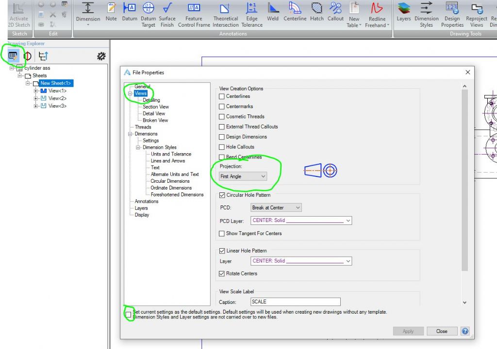

            Neil, regarding 1st or 3rd angle, click top left for file properties, select view where you can change between 1st & 3rd then tick the box to make defalt

              1st or 3rd angle is inherited from the drawing template – except for if you don't use templates, then Jason's instructions hold.
              ISO world = first angle, US = 3rd angle, unfortunately in UK we use both, so no template is likely to be 100% correct. You need to modify your template to avoid having to set it each time. In Atom3D you don't have all the editing options you might like.
              Projection Cone – I have a custom symbol somewhere, unfortunately Aom3D doesn't support that nice trick.
              Again if you modify the template, it only has to be done once…
              Save modified templates with their own unique name to avoid them being overwritten if re-installing the software.

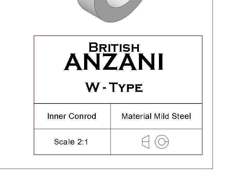

                You could just draw a simple cone and add a small scale drawing of two elevations to the title block of your main drawing if you want to show that sort of thing. Something like this
                Edited By JasonB on 09/05/2020 19:56:22

                  Yep, I had that already when I said "Defaults to 1st angle which is fine" I meant that's what I want it to do!
                  Fair enough I will have to add my own cone.

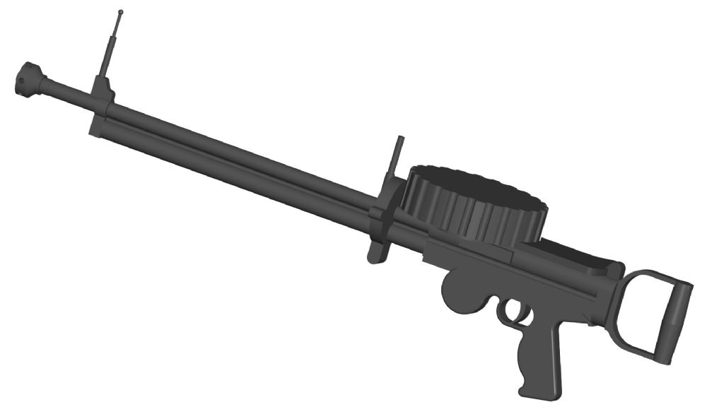

                  Knocked this up yesterday evening, as something I can print out for as an accessory for various models. Not super detailed but dimensionally accurate (taken from one of Savage's original drawings – the US maker).
                  Believe it or not there doesn't seem to be a decent representation on Thingiverse.
                  Forgot pic!
                  Edited By Neil Wyatt on 10/05/2020 14:26:05

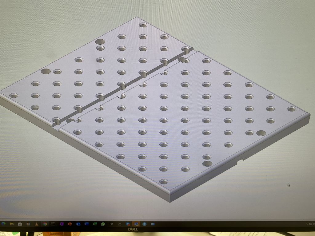

                      I am trying to draw up a fixture plate for use on the mill. This will be dual purpose, in that the primary use will be to hold a Bison 200mm indexer so it fits across the mill table (Bridgeport clone). As I was able to source a large piece 330mm x 423mm of 7/8" aluminium tooling plate, I though it would make good fixture plate.
                      I have created an extruded block of the requisite size and a single extrude hole 10mm dia and then used the linear pattern tool to create a matrix of holes. What I cannot see how to do is select them all so that I can then extrude them all. I will then need to align them in correct position.
                      Any help gratefully received.
                      Colin
                      #500348
                        If you have drawn your 10mm circle in a sketch and then used the linear pattern there then you should just end up with a series of circles all in the same sketch, deactivate the sketch and then use extrude cut which will do it to all the circles in that sketch no need to select them all.
                        If you have extruded a single circle so the hole is showing through your plate and used the linear pattern there selecting the extrude from the list down the left side then that will just copy the extrude cut to them all.
                        In both cases the alignment can be done when entering details into the linear pattern box by specifying the spacing and direction, I'm assuming you just want a grid of holes.

                          Here you go, two methods with a bit of faffing about between the two.
                          #500352
                          David Jupp
                            @davidjupp51506
                            Colin,
                            As Jason shows, you can use pattern in 2D sketch, or on a 3D feature (hole in this case). One important thing to note, if you change your mind about the spacing or number of repeats – it's easy to edit the 3D feature pattern afterwards, but if you patterned in the sketch you'll have to delete and start again (the pattern there is a 'one shot' and can only be edited during the original creation session).
                            #500368

                                  I have managed to get the linear patterns of holes onto the fixture and also the slots for tenons.
                                  If I put reference lines (construction lines ?) on the drawing to simplify location of holes, why is it every time I go back to make a change the reference lines have disappeared. Should I be able to switch the reference lines on and off?
                                  Colin

                                    Reference lines are specific to a sketch, so anew sketch doesn't have any reference lines.
                                    If you edit existing sketches the line should still be there.
                                    #500758
                                      I'm not sure if Atom has all the copy/paste features of Pro but if you select and copy all the ref lines etc in one sketch you can then paste them into another.
                                      #500769

                                          If you have separate sketches and extrude cuts for the hole and counter bore you can select both of those when you do the linear patterns.
                                          You should be able to see the initial hole when you go back to sketch a counter bore and simply make you CB sketch concentric to the hole.
