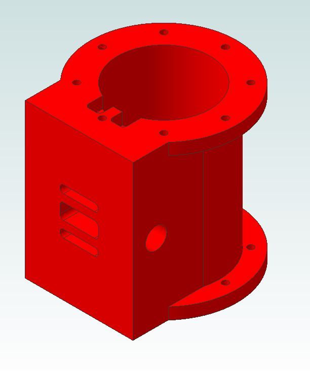

        Reference your very recent postings of illustrations regarding how to draw the transfer ports in the cylinder head, would you mind telling me where your original drawings (2D?) came from??
        The reason I ask is because I’m in the middle of modelling a spin-off of the Stuart Turner 10V. The source data (2D drawings) of the model appeared in ‘Australian Model Engineering’, issues 200 – 203. The title of the article is ‘The “Phoenix” Engine’ by Peter Martin. I’m doing the modelling in SketchUp. Later I’ll try the same model using Alibre Atom3D.
        When I say “I’m in the middle of modelling..”, I’m actually in the middle of modelling the cylinder head! When I saw your illustration of the cylinder head I was struck by the similarity of what you have done and what I am doing. It looks like the same cylinder head! Of course this could be a very common configuration. Any information that you could provide regarding your model would be greatly appreciated, both now as I work in SketchUp and later in Alibre 3D.
        Although I am a retired American and living in Australia, I feel I have a connection to the UK. I worked at RAF Lakenheath in Suffolk during mid 1980s and again early 1990s as a civilian contractor supporting the F-111. I lived in Brandon not far from where the Wheeting(sp) steam festival was held. I still keep in touch with friends in the UK. I really enjoyed my time spent in the UK.
        Cheers
        #415357

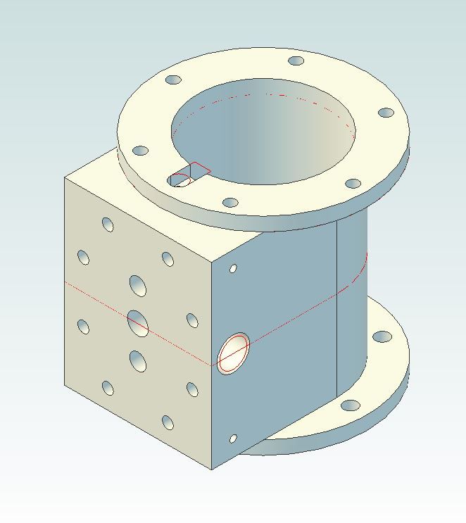

          When you say "cylinder head" do you mean the cylinder casting that I used in the post earlier this week or one of the cylinder end covers which somethimes get called the head?
          The reason you can see a likeness is that I drew that cylinder up a few years ago when another member had some issues with a Stuart No1, main dimensions were taken from the stuart drawing and the outside not detailed.
          There are several views in my album starting with this one of the piston/rod, just use the arrows to move to the next one. You will see that I have drawn it there with the cast in passages which were just suppressed so they did not conflict with the drilled holes in the recent post. This is how it wa soriginally drawing with teh cast ports showing in the sectioned casting
          Depending on how you are going to construct the cylinder you may need to draw it if different ways, this one was fabricated and the passages part machined into the parts before silver soldering which is easier than drilling afterwards and you get a good passage area
          On the other hand this one was cut from a block of cast iron so the passages had to be drilled, I also just used drilled ports to keep it simple.
          If it was just the cylinder covers then let me know and I'll post how to do them.
          If you have Atom then you should be able to open my files, click Message member at the bottom of this post and let me know an e-mail and I'll send the Alibre files to you to look at.

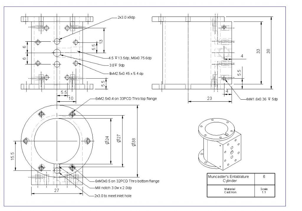

          #415358
            And as a bonus for Nigel Graham this is the 2D drawing of that last cylinder produced by drawing the 3D model first. All dimensions automatically generated off the model not fudged due to being drawn at wrong lengths, click for larger image
