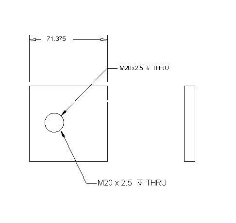

      (i) It won't work in Atom as you would have needed to put in the thread details during the 3D stage to be able to have it available to call up on the 2D drawing and it is not a feature that AA has.
      (ii) I will leave that to David
      Best bet would be to draw tapping size circle and then cut extrude that to show a hole in your part. Then when you come to the 2D drawing use Note with show leader (arrow)
      Top call out is what the other Alibre versions produce, bottom was done as I describe above

        As Jason says – the 'Hole Tool' is not available in Atom3D. Stripping unsupported items out of the UI consistently across all modes has been a far trickier task than I think anyone expected.
        I have just checked – one thing that might occasionally be useful – you can successfully turn on hole callouts in Atom3D for a file produced in a version of Alibre Design that supports the Hole Tool.
        The wording in the Help may not be the clearest – the content of the hole callout is generated from information in the hole definition (in the 3D model), it isn't created as such in the 2D workspace.
        I'll mention this UI inconsistency to the senior team at Alibre. Thanks for the feedback.

          Thanks guys for the super fast response. Thats what I had imagined would be the case, and I will use the Note feature

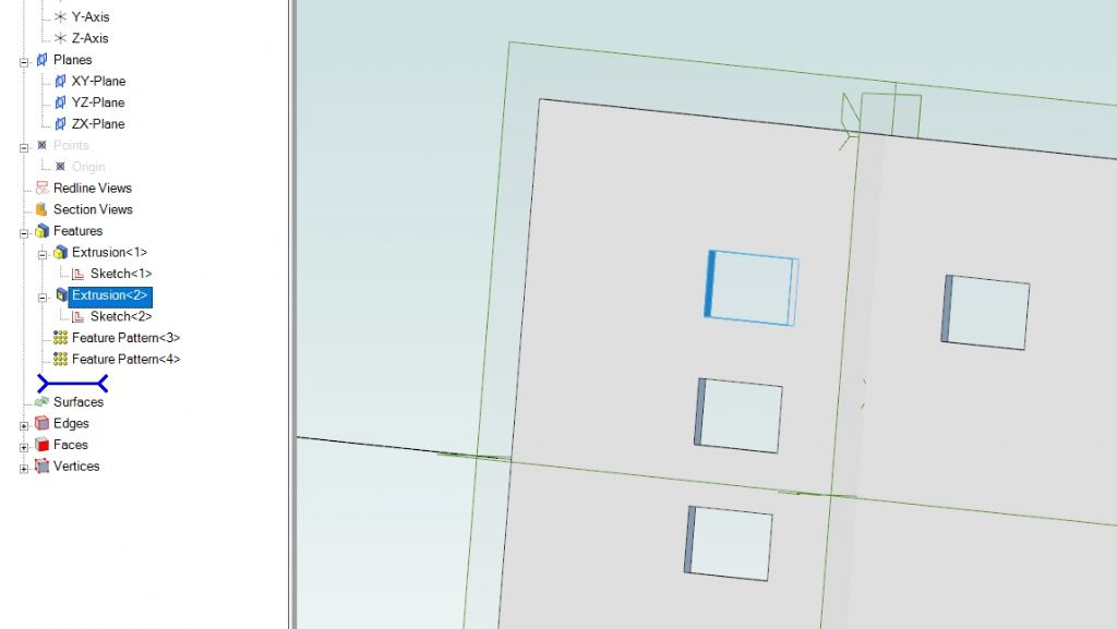

                    #378342
                      Just to add to what David says.
                      It's very easy to do a lot of work on a single sketch. I rapidly learned it was best to keep each sketch as simple as possible. The part view is uncluttered by the guidelines and dimensions for each sketch.
                      An exception is doing something like placing several holes in panel where you can use one sketch to place and dimension them so they match up and are aligned, where it can be useful to have them all dimensioned on the same sketch. In this case 'constraints' make life easier.
                      For example to cerate several identical rectangular cutouts dimension the first one and then use the '=' constraint to make the rest identical to the first one. You can also use other constraints to line them up with minimum need for dimensions. If you then make the first cutout a different size the change will automatically adjust all the others.
                      #378345

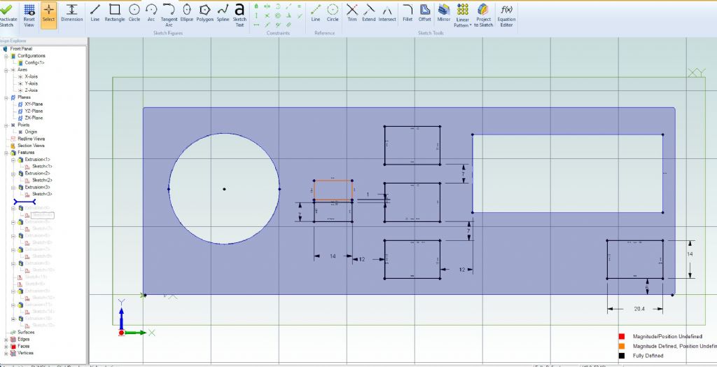

                              #378364
                                Here you go.
                                The positions of the power socket cutouts are not regular and relates both to the size and position of the large cutout (for a temperature control module which only ahs a about 1mm of tolerance as otherwise it will conflict with mounting brackets for the internal PSU) and each other.
                                Perhaps the dual USB cutout should be a separate sketch an no doubt it could be done more elegantly, but it was so easy to set out like this, why worry?.

                                  There is no single 'correct' approach – if it works for you then fine. Here is another way to tackle Neil's power outlet cut-outs, using a single rectangle in the sketch.pattern method.jpg

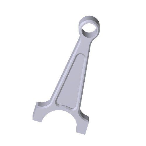

                                  John Hinkley
                                    @johnhinkley26699
                                    And, just to prove that it can be learnt quite quickly, albeit with a fair bit of help, here's a couple of parts I modelled earlier:
                                    Crankshaft
                                    Conrod
                                    From my album,
