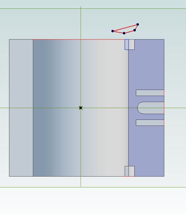

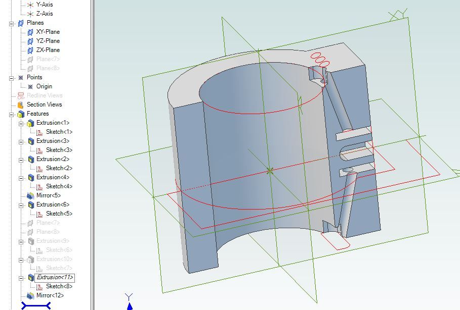

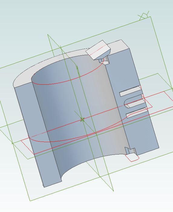

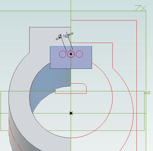

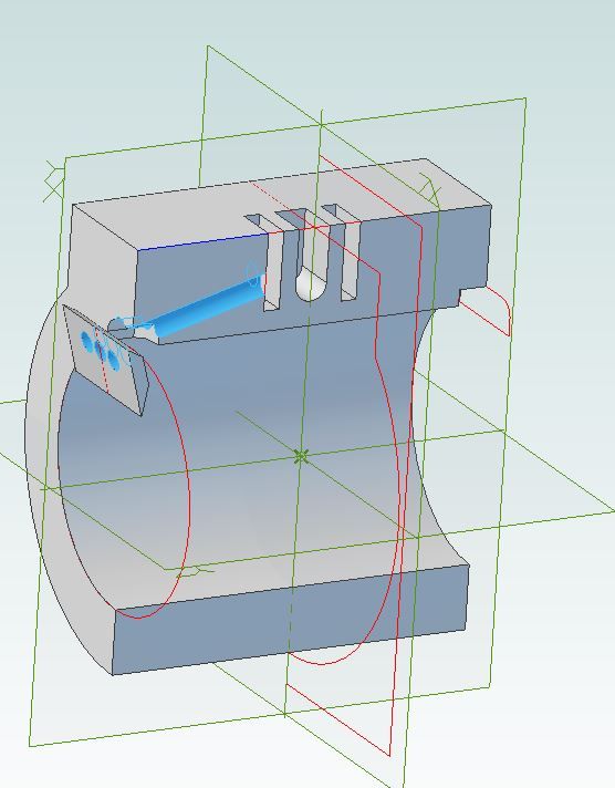

                                            You need to create a plane that is at 90degreed to the hole you want to draw, then it is just a case of sketching a circle on that plane and cut extruding it. An alternative is to add an axis then draw a half section of teh hole and cut rotate about the axis.
                                            Give me a while as I think Atom is slightly different for adding planes than my Pro version and I'll see what can do.
                                            #414328
                                              Well it came out a bit fuzzy but should give you an idea of how to first set a plane at the desired angle and then I added an offset plane to that before sketching on the offset plane. Also a bit of editing as the holes were cutting into the cylinder sides. I think Atom has the same plane options if not post a screen shot of what options come up when you click the "insert ref plane" tab.
                                              #414341
                                              David Jupp
                                                @davidjupp51506
                                                Another option (depends on the specific model) might be to add a chamfer to a straight edge to get an angled face – then use that to sketch on.
                                                The key points are
                                                • You can only 2D sketch on planes, or on planar faces of existing solids.
                                                • You can add your own reference planes to help in creation of features.
                                                Jason's method is very similar to how you might actually drill the holes – first set work up at desired angle, then drill.
                                                The nice thing with CAD is that if the angle wasn't quite right, you can go back and change it without wrecking anything.
                                                #414345
                                                  Similar to David's suggestion of a chamfer is to sketch a random shape with one side at 90 degrees to the angle of your hole, the long edge in this case
                                                  Then extrude that to any length I went with 1"
                                                  You then just select that surface to sketch on
                                                  Then once again cut to geometry
                                                  You can go back to alter the angle of your first line or move the circles if need be. Then just select the cut extrusion on the left hand list by right clicking and select "suppress" so it does not show on the model. Final thing on a cylinder like this is to mirror the cut extrude of the drillings about the central plane.
                                                  Edited By JasonB on 15/06/2019 10:29:52
