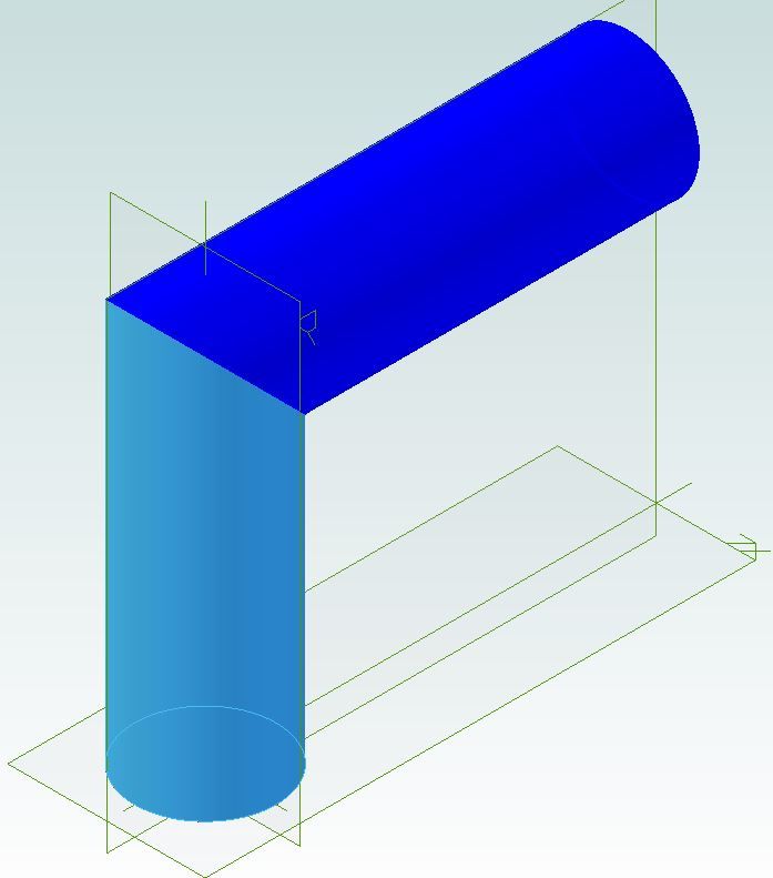

            I am drawing up a simple adaptor to connect dust port on a grinder to a vacuum. Once I am happy with it I wish to convert the 3D CAD data into a file my 3D printer can then use to print the required item. I have created my basic shape and changed diameters as required.
            What I now need to do is cut the smaller diameter at 45 degrees and rotate the cut piece around to give me a 90 degree bend. What is the best way to achieve this. I have followed the MEW tutorial exercises but not found anything that covers what I want to do.
            Any suggestions please.

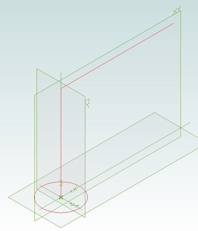

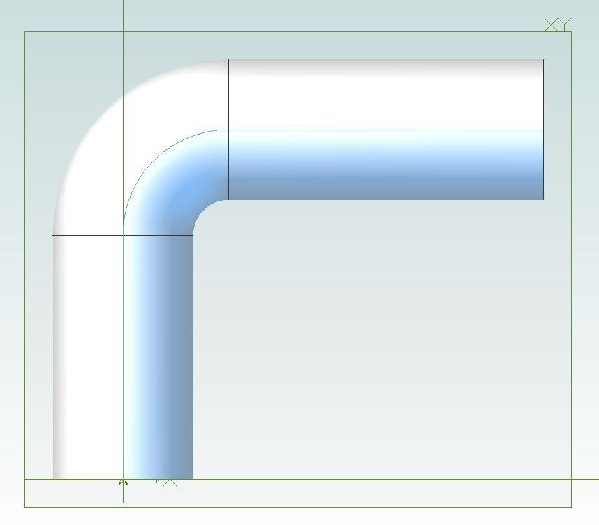

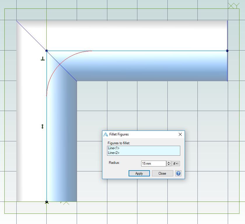

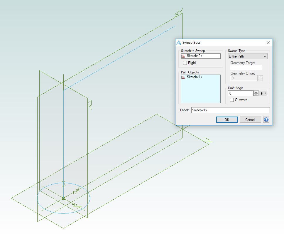

              Bit hard to say without seeing what you actually have but rather than cut a bit off and try to rotate it I would draw the small diameter as a sketch and then draw another sketch with a 90degree bend, you can then "sweep" the circle along the bend which will give a mitred bend or if you fillet the path you will get a smooth flowing bend.
              Draw circle and path
              Select sweep, enter the circle as the sketch and the bent line as the path
              Result
              Here I am editing the path to follow a curve
              Which gives this
              Edited By JasonB on 18/03/2019 16:15:43

                              In this case an "open" sketch is usual for a path unless you are sweeping a complete loop.
                              The circle needs to be drawn with the path starting on it's ctr so you may be better creating a plane where you want to draw the circle rather than placing on the surface of your existing diameter and make sure you draw the path sketch on one of the other planes that passes through the ctr of the circle.
                              If you can post a screen shot or photo of the screen showing the part and the path sketch that would help us to see whats wrong.
