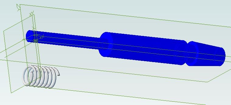

                        #399753
                        Tomk
                          @tomk39956
                          Can anyone tell me how to mate a spring to a shaft in Alibre 3d assembly. I have tried the Quick icon used to mate shafts with holes but cannot get it to work for springs. The screen shot shows the shaft and spring. I want the spring to be anchored to the small diameter on the shaft.
                          Thanks
                          Tom
                          #399764
                            If you right click on the spring and then select "show reference geometry" you can then mate the XY plane ( most likely plne) of the spring to the shoulder of the other part, may need to enter a distance depending where the plane is on the spring.
                            You can also align the central axis by the same method.
                            Quick will work the same as this
                            Edited By JasonB on 11/03/2019 18:29:05
                            Edited By JasonB on 11/03/2019 18:47:54
                            #399774
                            Tomk
                              @tomk39956
                              Posted by JasonB on 11/03/2019 18:15:26:
                              Jason
                              I got it work with your instructions.
                              Thanks
                              Tom
