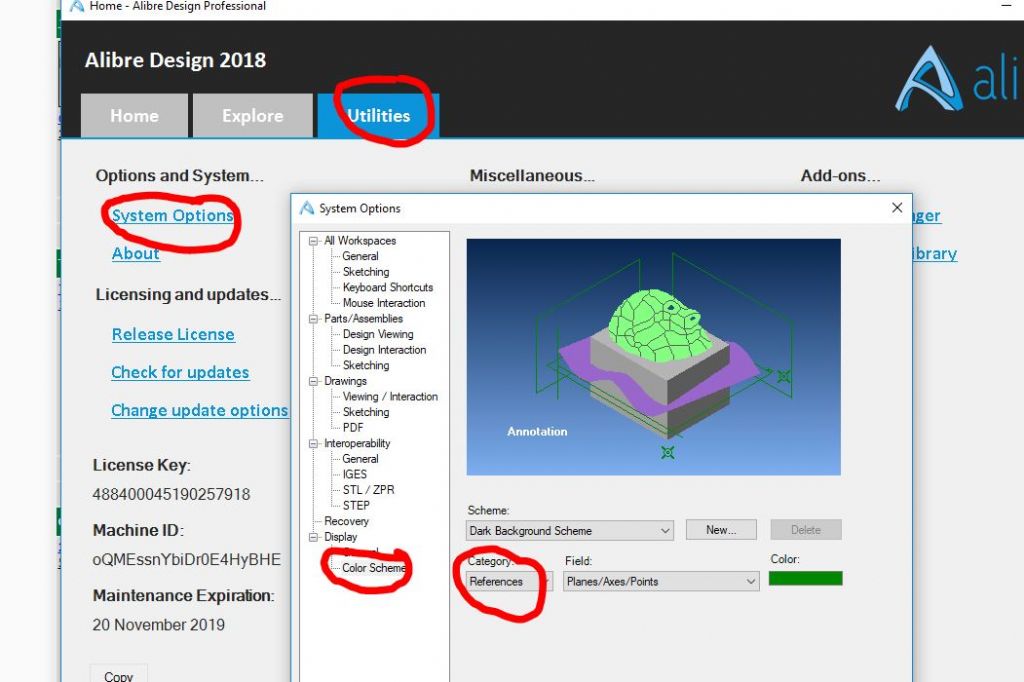

                              #397688
                                I'm sure you can do the same as this in atom, from Utilities – System Options select display – coulor schemes and reference seems to be the one for you
                                #397689
                                Colin Heseltine
                                  @colinheseltine48622
                                  Well that was a waste of a post. I have found an option in System Options in the Parts/Assemblies (General Appearance) where you can change Reference Geometry and Sketch Thickness. There are three choices. I think the default is Option 1 with very thin lines, Option 2 as you can guess is a little thicker and Option 3 (the one for me) gives nice thick lines.
                                  Maybe as get more used to the package it may be that can go back to a thinner option, most likely Option 2.
                                  There also appear to be Several Colour schemes under the Display (Colour Schemes) heading.
                                  Colin
                                  #397690
                                  Colin Heseltine
                                    Jason,
                                    Thanks for that. I did in fact find it just before your posting. I will have a play around with the colour schemes to see if any are more suitable for my colour vision. But I think just having a thicker line will make a significant difference to me.
                                    System Options and Properties buttons are displayed on the bottom right hand side of the drop down menu from the Alibre Icon button
                                    Many Thanks,
                                    Colin
                                    #397719
                                    David Jupp
                                      @davidjupp51506
                                      You can create your own colour scheme if desired, you aren't limited to the provided ones.
