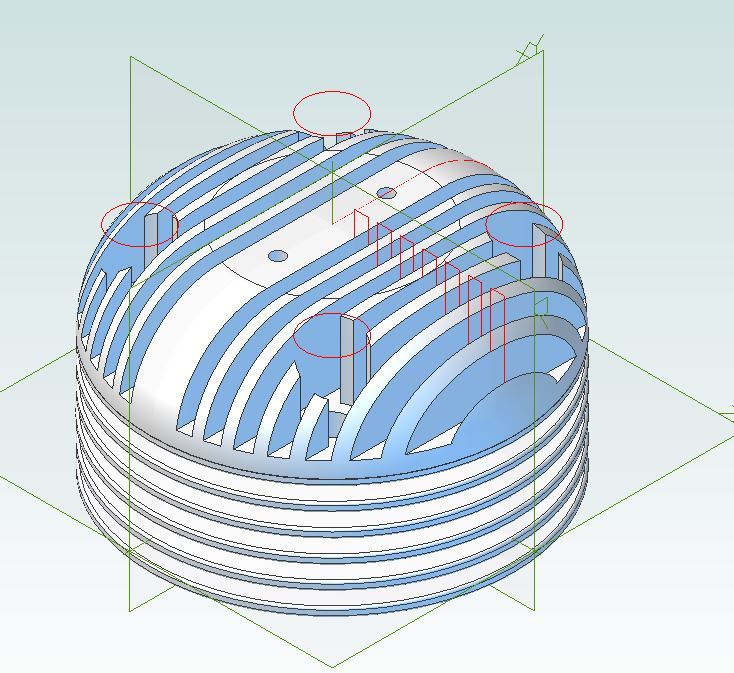

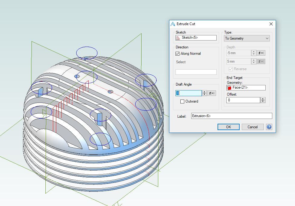

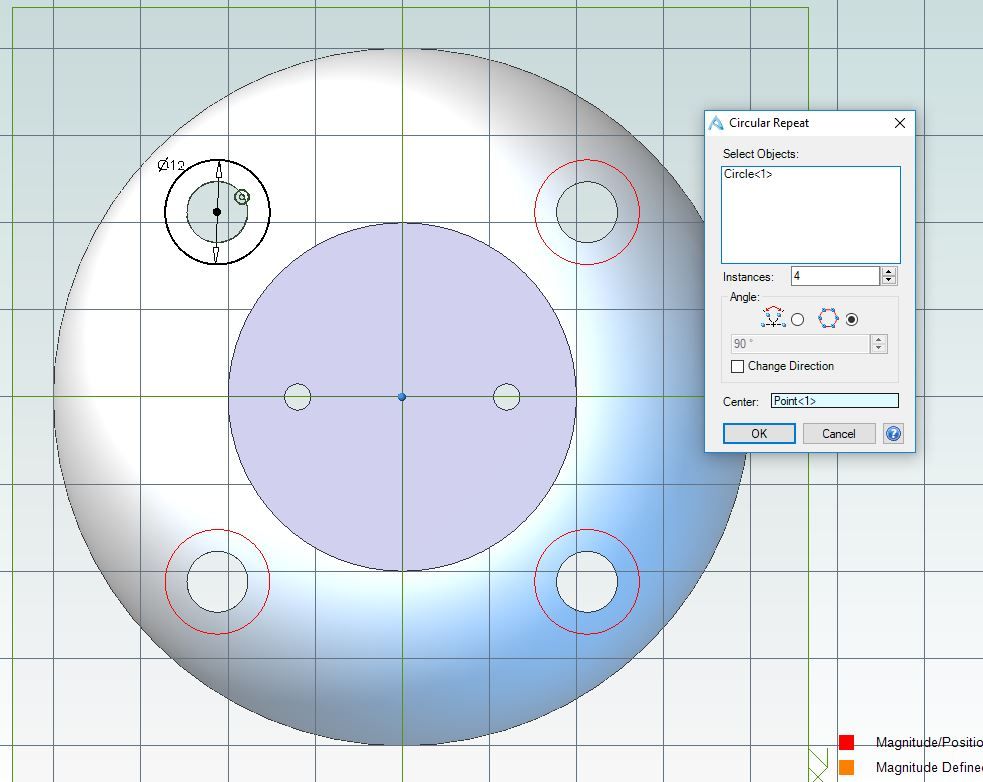

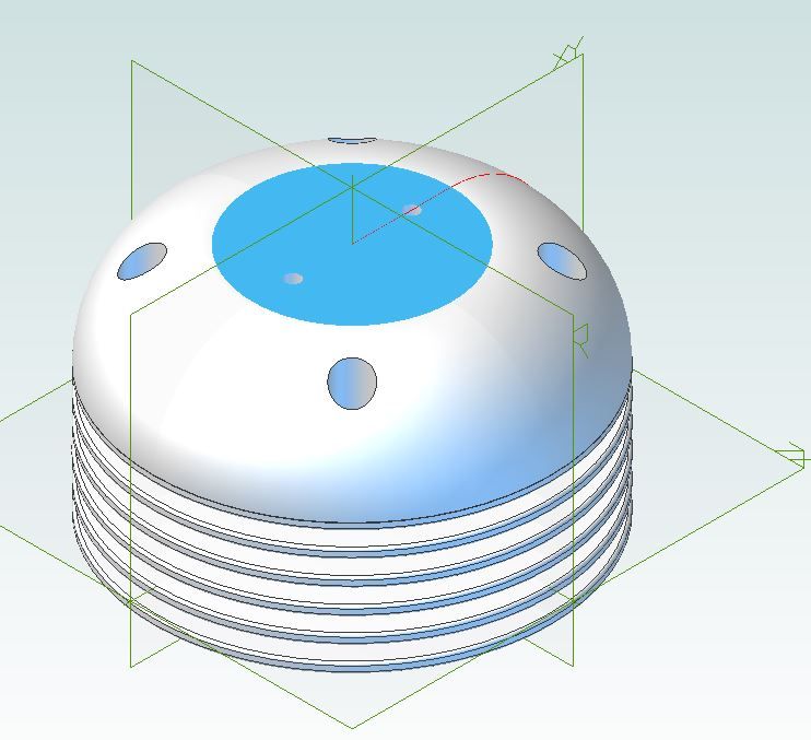

      For the counter bores that you asked about earlier first click the flat top of the head which will make it blue then activate 2D sketch
      Draw a circle roughly over one of the through holes and dimension it's diameter, then using the concentric constraint click the through hole followed by the circle just drawn which will place it centrally over the through hole.
      You could do the same for the other 3 counter bored or as I did use the circular pattern feature to place them.
      De-acivate the sketch and then use cut extrude, you can either set a depth or if the fins have been drawn already select "to geometry" and click the bottom of one of the vertical slots as the place the counter bore will end.
      Click OK and jobs done
      You can see I have a lot less sketches at the side than your screen shot, the pale grey pair are the horizontal fins which I have suppressed as we don't need both
      Edited By JasonB on 10/02/2019 19:14:55

        Thanks Jason, that will keep me quiet for a bit!!

          Mick – I'd add that in each of Jason's examples, an alternative approach would have been a single slot profile in the sketch, extrude cut that, then feature pattern to get the required number and spacing of slots.
          There is no 'right' or 'wrong' method – using feature patterns keeps the sketch simpler, hence easier to edit.

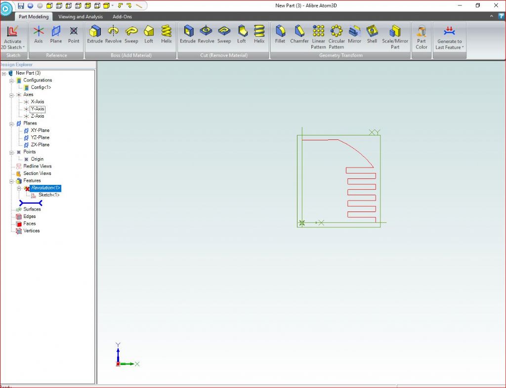

            Hi. Jason, its been far too quiet of late! I've been trying all the methods you've demonstrated but I can't get the results in your screen shots. My screen shots are in reverse order ( can't even get that right!) With the sketch I've produced I get the warning that the sketch isn't closed when I exit sketching. The sketch will only rotate when the Y axis is selected, screen shot two, if I select either X or Z I get the result shown in screen shot 3 and that's before I click the okay tab. When I click okay on the rotated sketch I get the result shown in screen shot 3ch3.jpgch2.jpgch1.jpg
            #396431
              You need a horizontal line from ctr axis out to the edge of the head and a vertical line up the central axis which will close the sketch. If you look at my sketch again you can see these two lines, bottom one is red and vertical is orange hence a bit harder to see over the green axis line
              #396439

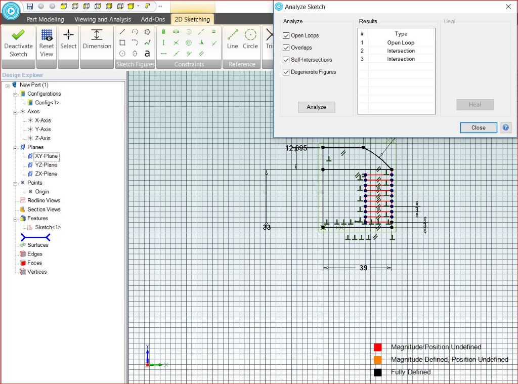

                  Hi David. I should have said that I was getting the same situation when the sketch is, to what I think, is closed. In the heal box it says that it doesn't conform to the 0.01mm tolerance, but the sketch had snap to grid ticked and so I would assume each line would be closed. ch5.jpg
                  #396588
                    In that pic you have a horizontal line splitting the sketch into two, trim that out.
                    On that Analyse box you have three results shown, click each one and it will show the error on the drawing which will give you an idea of what is wrong

                      You can change the 'heal tolerance' value – but tat doesn't help if you have multiple loops on sketch.
                      Personally I find snap to grid a pain – but it may be helpful for some.

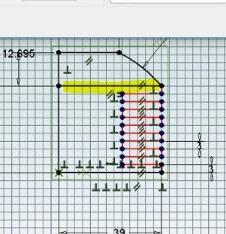

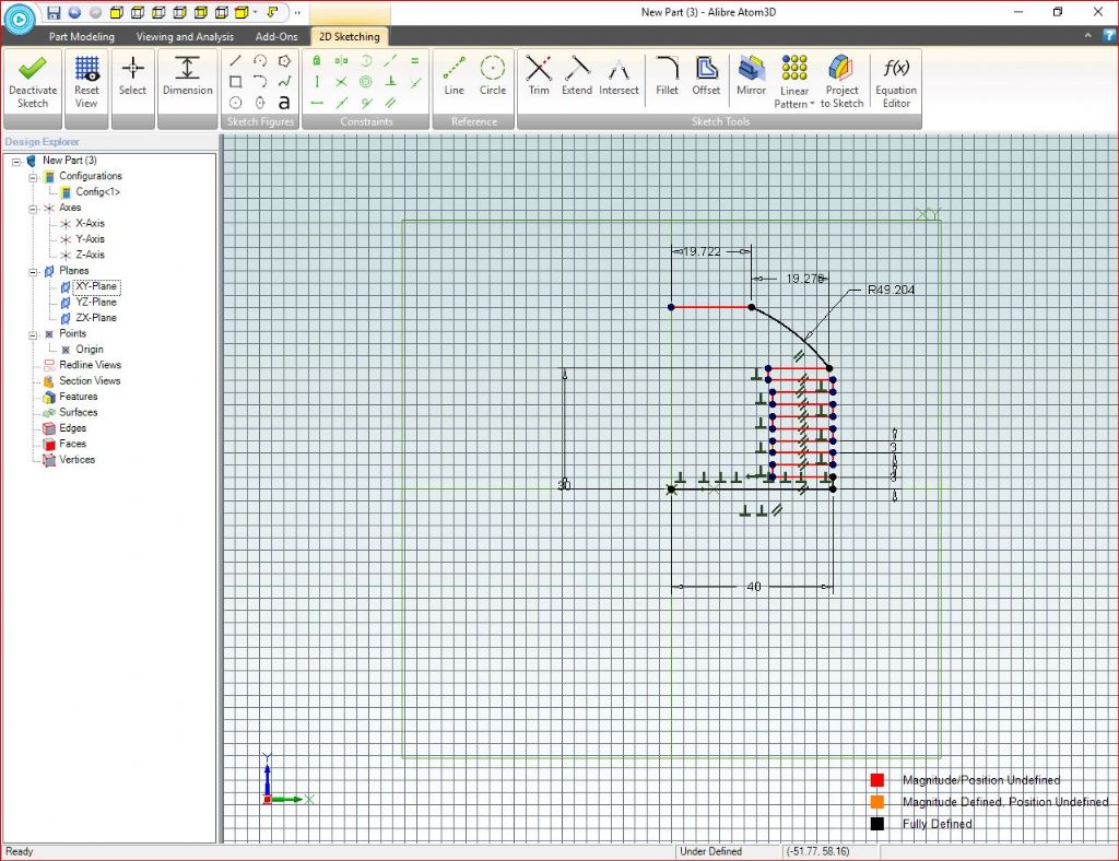

                        Hi,
                        i'm a complete beginner in the CAD area although I successfully got through the MEW magazine bits to date. However I have a simple question.
                        When I have a 2d sketch up on the screen what does " under defined" on the bottom of the screen mean?
                        I have "analysed" the sketch and it shows as having no errors.
                        One of the segments, which is a circular arc connected to two tangential lines, is coloured yellow.
                        How can I find out what is amiss in my sketch?
                        Regards JW

                          It is either the diameter of the circle forming the arc that has not been defined or the position of the circles centre point. David should be along later and can post a link to a suitable video.

                            This video was produced for Alibre Design, not Atom3D – but it illustrates how this works. The colour scheme used isn't quite the current standard. As the video states – best practice is to always fully define sketches, but this isn't forced on you.
                            I've just tried on my own system, it appears that you can do the following in Atom3D (my system also runs Alibre Design, so may not be entirely representative – would be good if somebody can check in Atom3D).
                            • Ctrl + Shift + N toggles the key for DoF colours (bottom right of screen in sketch mode)
                            • Ctrl + Shift + U toggles DoF callouts in the sketch – these make things even more obvious, but do clutter the sketch somewhat.

                                            Thank you Jason B and David Jupp for you quick replies.
                                            However the CTRL+Shift+N and Ditto U do not work on my version
                                            .Further magification of my sketch showed that the tangents to the circle were not connected for some reason. I have corrected this but still cannot get the sketch to be fully defined. Analysis shows no problem.
