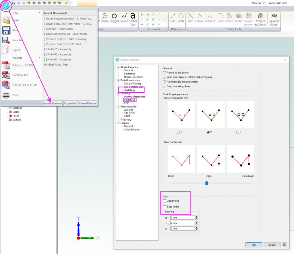

        I have successfully followed the Alibre tutorial up to fig 4 of the clamp pin. I created sketch 1 ok, but no way can I create sketch 2 withn a 3.5mm circle to the left hand side of the part, Alibre seems to insist on placing it on the origin. Please help.

            Roger, check to make sure that snap to grid is not enabled – snap will force things to grid intersections.
            #393185
              Roger it sound like you may have "snap to grid" turned on.
              To turn it off click the Atom Gem top left, Then system options at the bottom of the drop down. From there come down the list of the window that comes up to Part/assembly and sketching under that heading then scroll to the bottom of the bottom and take the tick out of "snap to grid"

                Roger – re-setting user profile will put things like grid and snap settings back to default values.

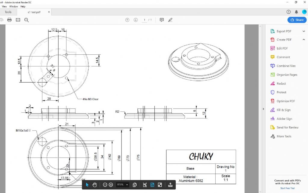

                                      Sometime ago I had reason to email a drawing to someone who did not have the software to open it (QCAD in this case).
                                      I was able to save the file as a PDF which almost any one can open. I tried using PDF publish on Alibre anf it worked ok with a 3D drawing but will not work with a 2D drawing. I have latest update of Foxit reader installed but have removed any Adobe software as it seems to cause trouble. I get the message "No PDF writer was detected. Please retry after installing one". If I look at Alibre System Options – Drawing – PDF. it shows Active PDF Writer as being "Foxit reader PDF Printer Driver" only. Any help would be appreciated.

                                        I tend to just go to print and then instead of selecting my printer I use Cute PDF writer (free to download) which works fine for me, this is an example of one such 2D drawing in PDF format.
                                        I've just done it with the same drawing using Alibre's "publish to PDF from the 2D drawing and that works fine too. Mine shows "Microsoft Write to PDF" and "Cute" as the two available and it used Microsoft.

                                            That's what I do too Andrew just print and use but the PDF is handy for sharing drawings with those that may not have Alibre or any CAD, the example above is one of the engines I have shared sets of drawings for.

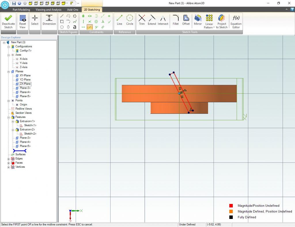

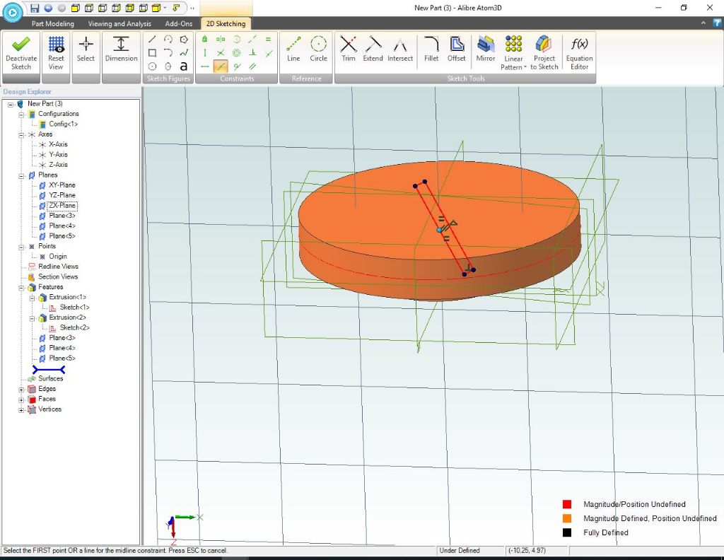

                                                    Sorry to bother you all again but I've spent quite a few hours trying to sort this out for myself. I've followed the tutorial to the letter but when I apply the midline constraint it locks the left hand line to the origin point but not to the sketch. I establish the plane by clicking on the z axis in the tree Which creates the blue box shown in fig 32.thumb screw 2.jpgthumb screw 1.jpg
                                                    #393600
                                                      Looks like you have drawn the sketch on the ZX plane and not the new plane that touches the edge of the disc.
                                                      Easiest option is to deactivate the sketch you have there then click "activate 2D sketch and come down the tree on the left to what is probably your "plane 5" and then draw the angled rectangle again.
