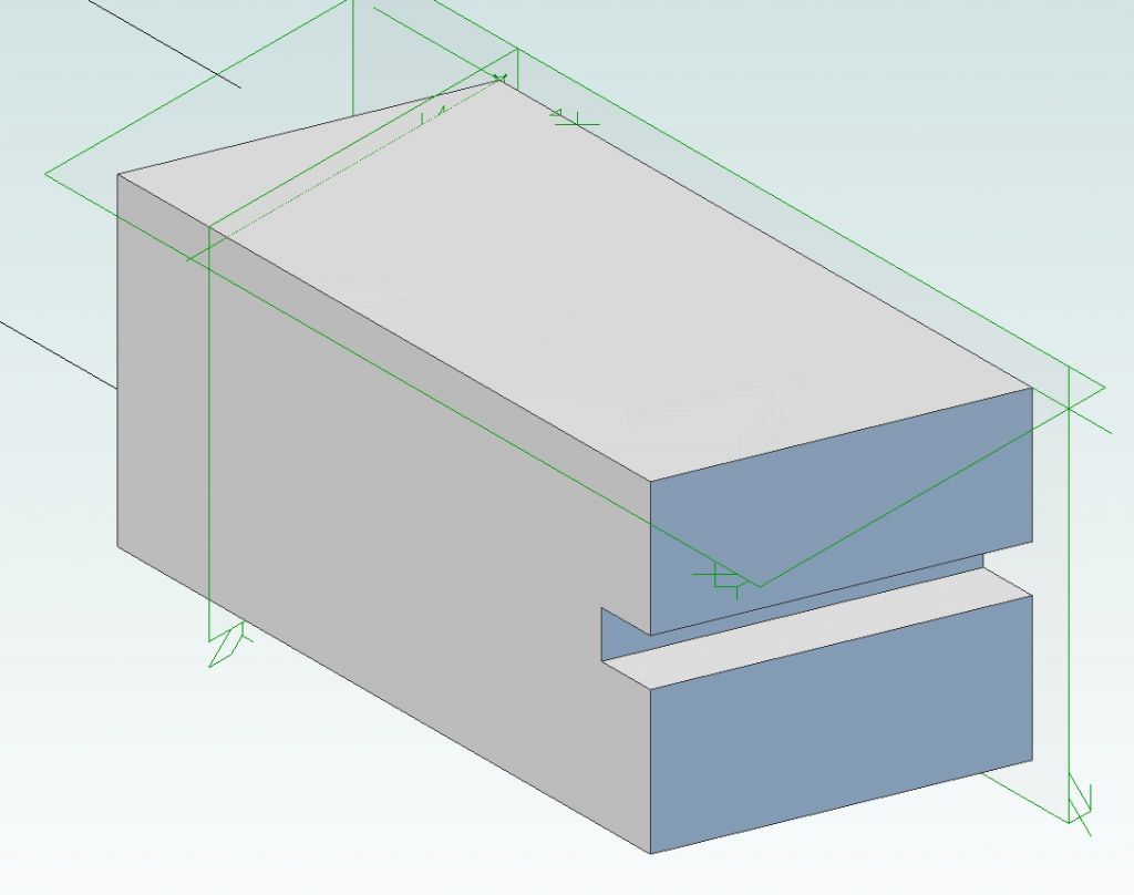

      Nige you either need to create a new plane at right angles to your sloping face which you can then draw the sketch onto and then extrude cut.
      Or select the sloping face and draw a long rectangle on it to represent the width of the slot and then cut extrude to depth, the rectangle will need to project beyond the obtuse angled end

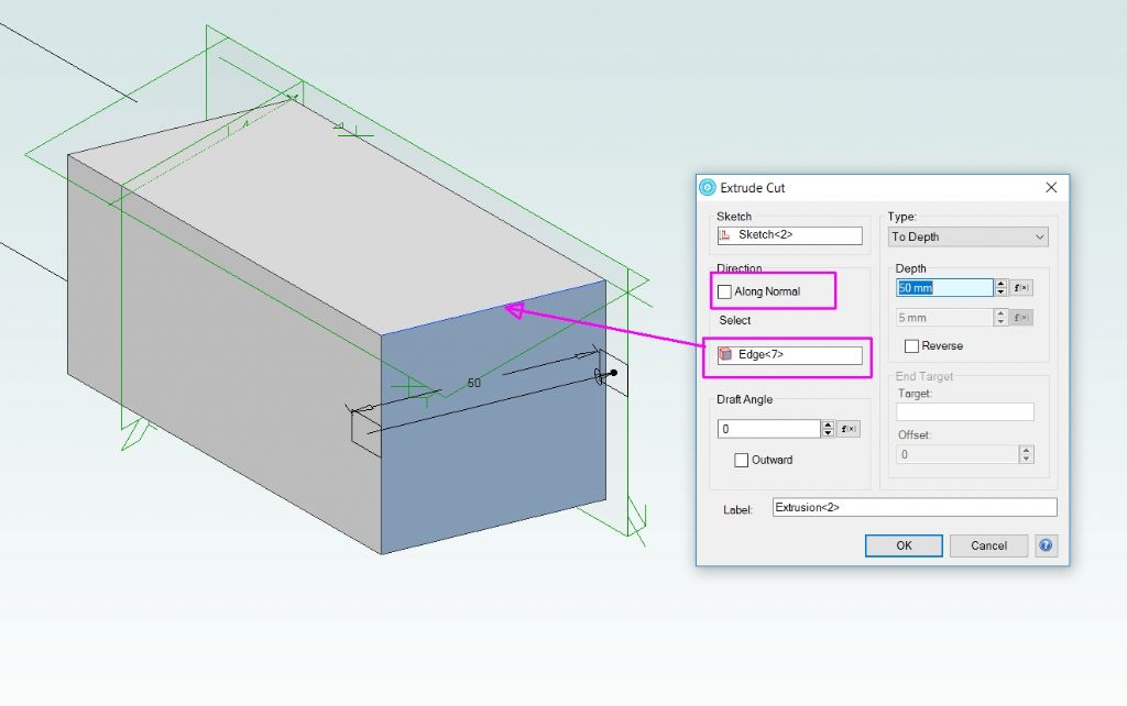

          Nige – yet another way to tackle.
          By default the extrude direction is normal to the starting plane, but it does not have to be. Here I have unchecked the 'Along Normal' box, this makes the field below available for specifying direction of extrusion. In this case I chose an edge of the existing geometry.
          Here is the result

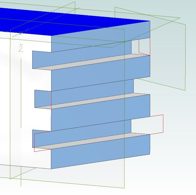

          #392324

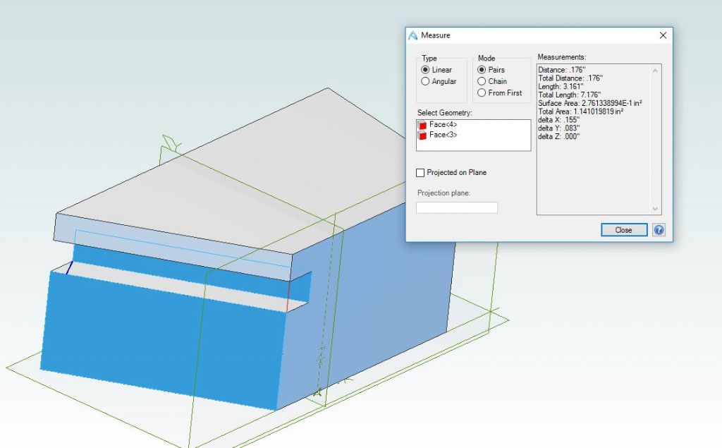

            David would that give the true depth of the groove? I would have thought the greater the angle of the face from the plane that the groove was sketched on the shallower it will actually "cut"
            For example this was sketched as 0.200" deep but when measured the groove is only 0.176" deep. You woul dalso need to set it to cut "through all " as the cut will need to be longer than the block as the length of teh sloping face is greater
            You can see it here where the top groove is done by creating a plane at 90deg to face, middle is extruded to follow rdge and bottom is just a long cut drawn on the face and then cut to depth and the middle one is shallower.
            Edited By JasonB on 22/01/2019 08:29:46
            Edited By JasonB on 22/01/2019 08:30:41
            Edited By JasonB on 22/01/2019 08:35:12

              Jason – that is all down to design intent and what the user is trying to achieve. The differing approaches do give different results, as you have shown.
              There are usually several ways that a particular task can be approached. Ability to change the extrude direction might be useful in some circumstances, but not in others.

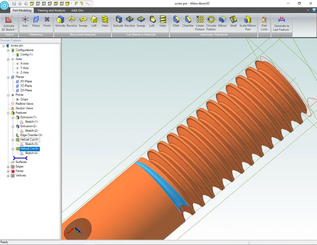

                However I have started on the introduction of a thread on the clamp bolt (issue 277) but I have hit a snag.
                Referring to Fig 16, page 28 it says "right click on the horizontal line then on Convert to Reference Figure"
                But the drop down table on my version does not include the line 'Convert to Reference Figure' . The last line is 'Direct Coordinate Entry'
                What am I missing, sorry to such a doddery old fool.

                  Make sure to right click whilst cursor is touching the line, not the nodes at either end of the line, nor slightly away form the line (either will give a different right mouse context menu).
                  It might help to zoom in closer using your mouse wheel.

                          Thanks David & Neil, I was clicking on the horizontal surface, not the horizontal line. As I said, its the doddery old fool syndrome!, onward now to the next challenge.

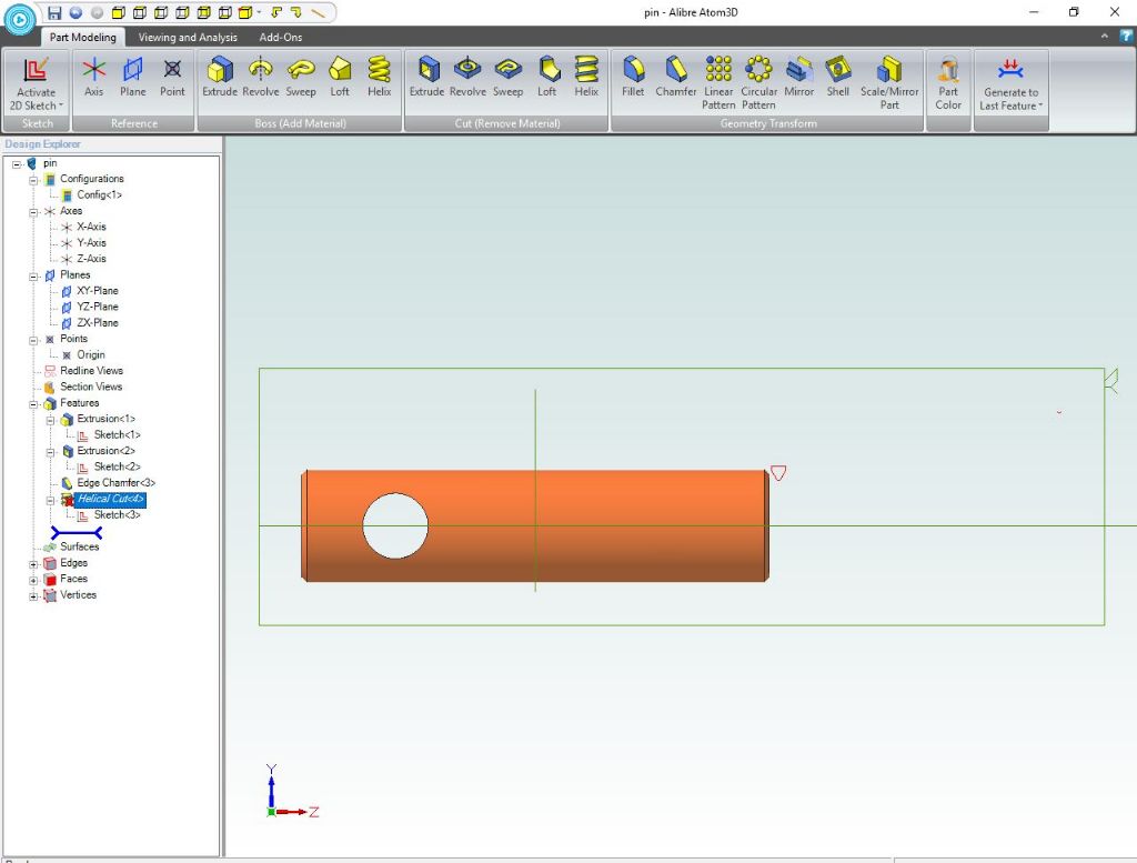

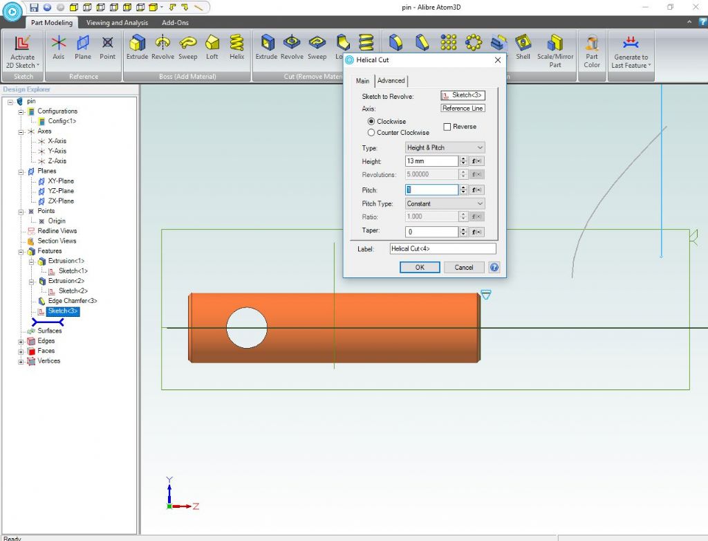

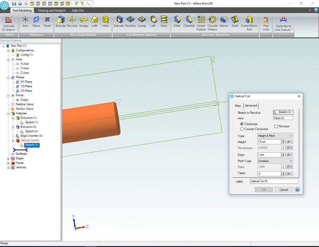

                            Still no joy. One screen shot shows the screen with a helicial line to the right of the sketch, but when I click OK there's a spring coil appears for a split second to the right of the sketch before the screen reverts to the other view. On this occasion the pitch is highlighted in blue, this is the first time this condition has occurred.thread 3.jpgthread 2.jpg
                            #392623
                              Mick, that vertical blue line looks a bit suspect, is that what has been clicked as the axis?
                              #392630
                                Click with left and right simultaneously so you can rotate the part, like in the article.
                                This may help make sure you click the right thing (I've found it make clicking an axis much easier).
                                #392644
                                David Jupp
                                  @davidjupp51506
                                  Mick – looks like you have placed a reference line in your sketch an used that as the axis for the helix. Click in the axis field in the helical cut dialogue, then click on the cylindrical face of the part (or the Z axis), so it is selected.
                                  The helix path preview is in empty space, you can't perform a CUT in empty space, it has to cut from an existing solid – this where both orientation (axis), and direction (reverse or not) play a part.
                                  If you are still struggling, e-mail me and we can have an on-line screen sharing session. Make sure to save your file – don't delete it, it will be fixable.
