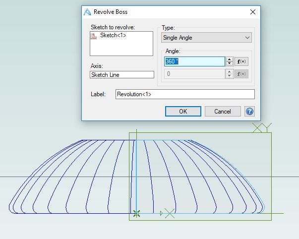

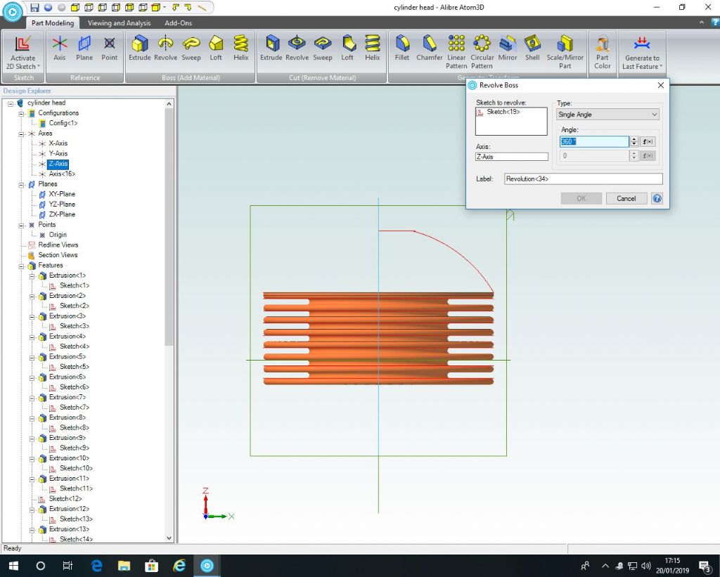

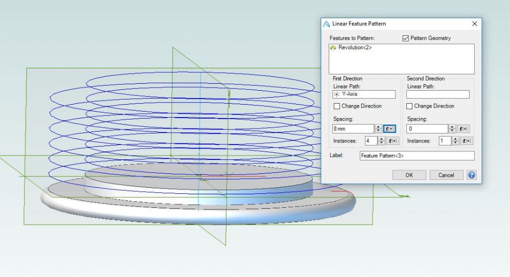

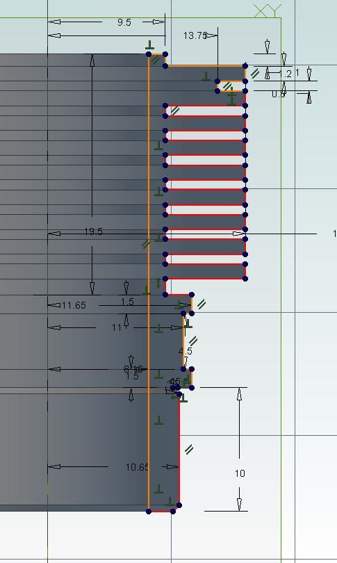

      I still seem to be doing something wrong. The vertical sketch line was drawn from the top face of the head to the intersection of the horizontal sketch line. I've also drawn the vertical line to pass through the head to a point beyond the base and above the horizontal line with the same result, the sketch doesn't revolve as the OK tab isn't illuminated. capture 3.jpg
      #392083

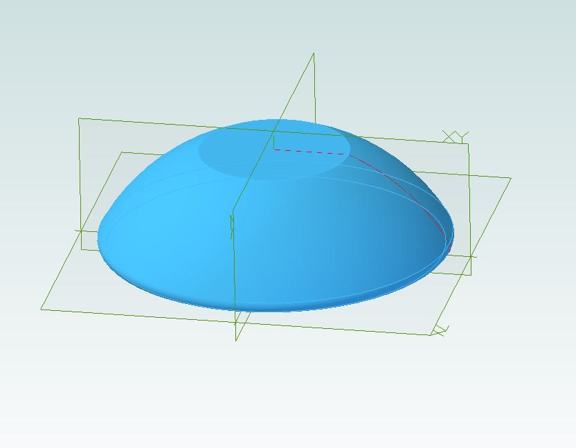

        You need the head sketch to look like this
        The vertical line should be on the central axis and you can then select that vertical line as to rotate the sketch around
        Should end up like this
        #392089

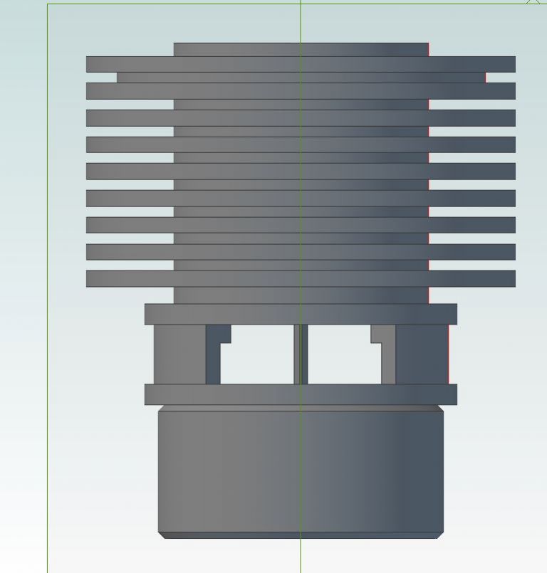

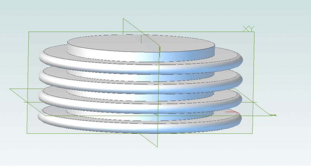

          You could have done the cylinder by drawing a section through it rather than a separate sketch for each ring of fins like this
          Or just drawn one fin and space as you have and then used the feature pattern to make multiples of it
          #392093
          mick
            @mick65121
            Thanks Jason, the section to be revolved needs to a continuous sketch.
            #392099
              Yes, if you get a warning when closing down the sketch it should be attended to before trying to extrude, revolve etc

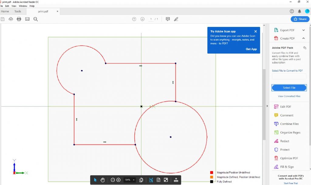

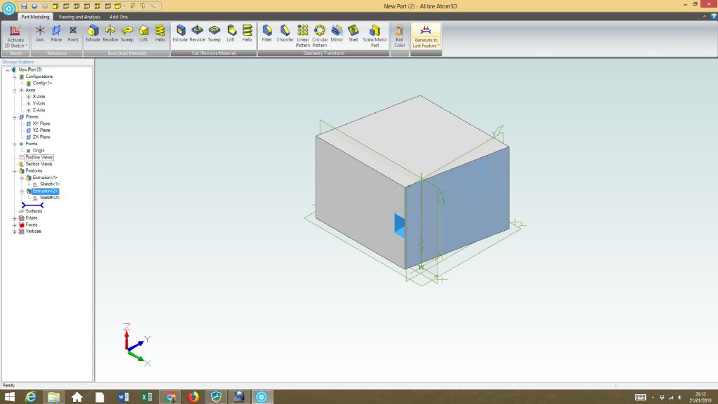

                Having not used Turbocad for a while I struggled to do a quick sketch – decided to try Alibre and was amazed at how easy it was to use by comparison.. Then the workshop gremlin arrived, I tried to print the part and got a beautiful blank sheet of paper. I then tried to publish as a PDF but was told that an empty part could not be published.
                What have I missed, its bound to be my fault!(ask the wife).
                Tool
                #392180
                David Jupp
                  @davidjupp51506
                  Tool – in Alibre a sketch is used as the beginning of making a 3D part. The 2D sketch on it's own in a part workspace won't print because it has no volume. You have to turn it into 3D by extruding (for example).
                  You can actually print a 2D item -n but only if you create it in the 2D drawing workspace, and use 'sketch on sheet'.
                  Alibre is a Solid Modelling program, it is optimised for producing drawings from those models, it isn't really intended as a standalone 2D drawing tool.
                  #392183
                    If you just want a quick sketch to take down to the workshop you can just select print when in 2D sketching and that will print out the sketch as it appears on the screen which can be handy as the green construction lines can be included which can be handy to layout the drawing on metal.
                    This one I selected print and then a pdf writer rather than a paper printer but both work.

                      Thanks for your quick reply David. It was an sheet ali disc so I can extrude it by the sheet thickness and all should be well..

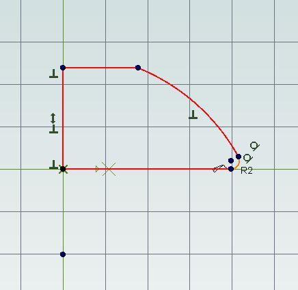

                                                    Trying to project a slot down the sloping face of a rhomboid figure but instead of following the 'plane' of the face the projection follows the relevant drawing plane as in the screenshot below. Question is how do I most easily acheive what I am trying to do please?
