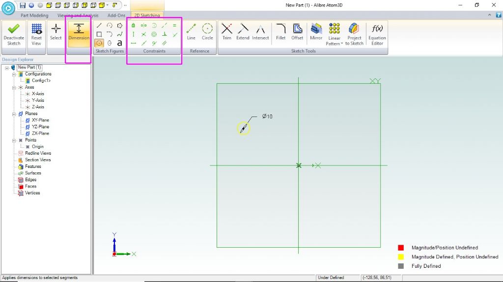

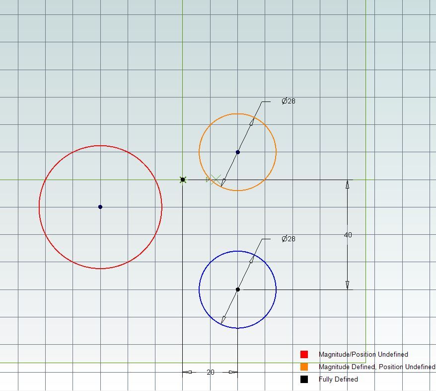

              John if you go to the "sketch options" box and click "toggle sketch dimensions" it should then show the distance your circle is from the two axis. Now use the select icon and you can double click these dimensions and alter them.
              The fact your circle is black means it is "fully defined" that is you have set the diameter and set its position. Snapping to grid would leave it red or orange if you had just set the diameter.

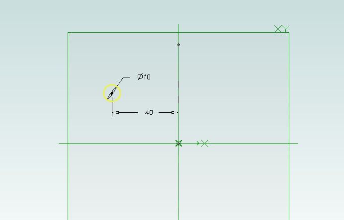

                  Others have at least partly covered this – this image shows where to find the dimension tool and the sketch constraints.
                  In this one I've used a dimension to fix the distance between Y axis and circle centre, by clicking on the axis, then the circle centre (with dimension tool active).

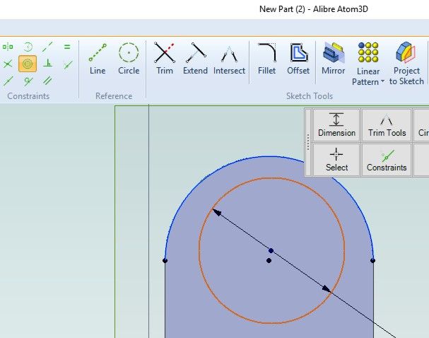

                    Here's my example:
                    I have created a rectangular crankweb, 10mm wide, then put a 5mm fillet on each corner. This makes each end a semicircle.
                    On the face of the web I drew a circle 7mm diameter for the crankpin.
                    With the 'concentric constraint' tool selected I first selected the outer curve of the web:
                    Once this is done, clicking the centre of the crank will move it to the centre of the outer curve.
                    Your problem may be that you need to be actively editing the sketch that creates the crankpin to set its position.

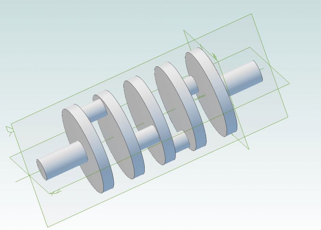

                          If it is a crank with round webs then draw a single web and extrude to thickness. Then use the linea pattern to give 5 equally spaced webs. Pick the inside face of the first web and draw your pin, select dimension tool and set its position from the axis
                          Deactivate sketch then extrude to geometry selecting the opposite face of the second web as the target. do the other pins the same positioning them at the positions you want. Finally put the shafts at either end.
                          Edited By JasonB on 28/10/2018 21:12:48

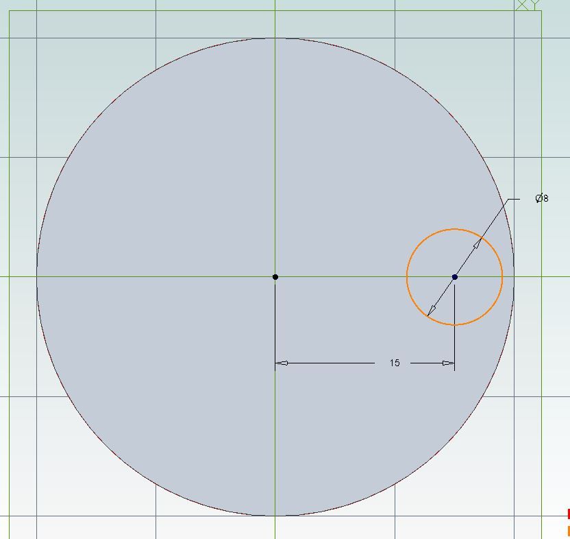

                                        Before I throw in the towel, do you have time to explain how I can edit the dimensions of a circle in sketch mode, including the centre position? All I get when I select a drawn circle and the dimension tool is the diameter of said circle. Nowhere can I get the centre co-ordinates as shown in your screen shot. There doesn't seem to be any way to edit the entity's properties. (I'm using the nomenclature which I'm used to in my present 2D CAD package. )
                                        Thanks,
                                        #378216
                                        David Jupp
                                          @davidjupp51506
                                          John,
                                          Look at the second photo in my post of 28/10/2018 20:46:13
                                          Place a dimension from the centre point of circle to some other geometry that you wish to set its distance from (for example an axis).
                                          Click the dimension tool icon, click circle centre, click other geometry, move mouse to where you would like to position the dimension, click again to fix that position. Type in the value for the dimension, then click the green tick, or just press return.
                                          Does that help?

                                                First, make sure you are editing the sketch you want to move.
                                                Double click the dimension number with the select tool and you can edit it to what you want.
                                                Position the centre by applying (and changing if necessary) dimensions from other objects edges or reference points, or from planes/axes within your drawing.
