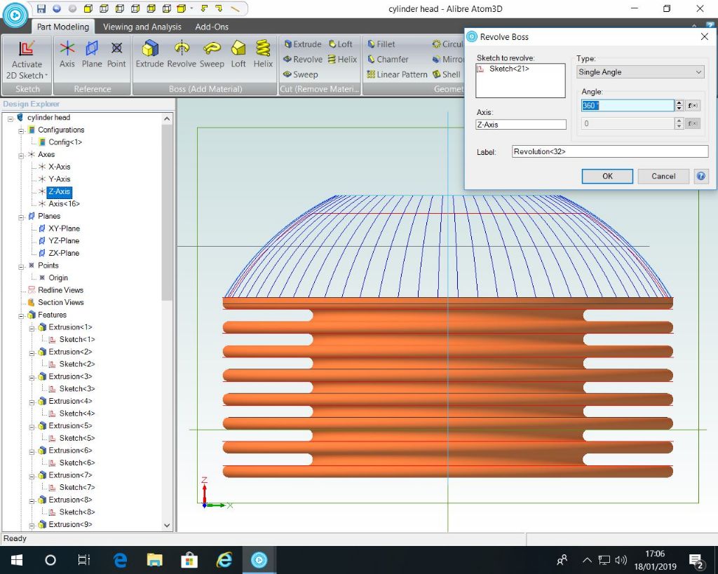

                                            mick
                                              @mick65121
                                              I'm playing about designing a cylinder, cylinder head and piston. The cylinder was pretty straight forward but I've got a problem with the head. Every time I get to the stage in the screen shot where I rotate the sketch of the dome I get the result you can see, but when I click OK in the revolve boss box all the rotated detail disappears leaving the original sketch, which I have to delete as the rotate boss won't allow a second attempt.    The red sketch line showing through is a previous attempt that I can't delete as the return arrow will only allow me to go back one operation.capture 2.jpg
                                              Edited By mick on 18/01/2019 17:26:13

                                              #391749
                                                Mick, that red line points to your problem. you only need half the profile eg draw a vertical line up the middle axis and delete what is to one side. It should then revolve around that vertical line.
                                                To get rid of the red sketch from previous locate that sketch down the left hand side, right click and select delete
                                                Edited By JasonB on 18/01/2019 18:01:10

                                                David Jupp
                                                  @davidjupp51506
                                                  Or edit the existing sketch…
                                                  Jason is correct. For revolutions, the profile sketch can touch, but must not cross the axis of revolution.
