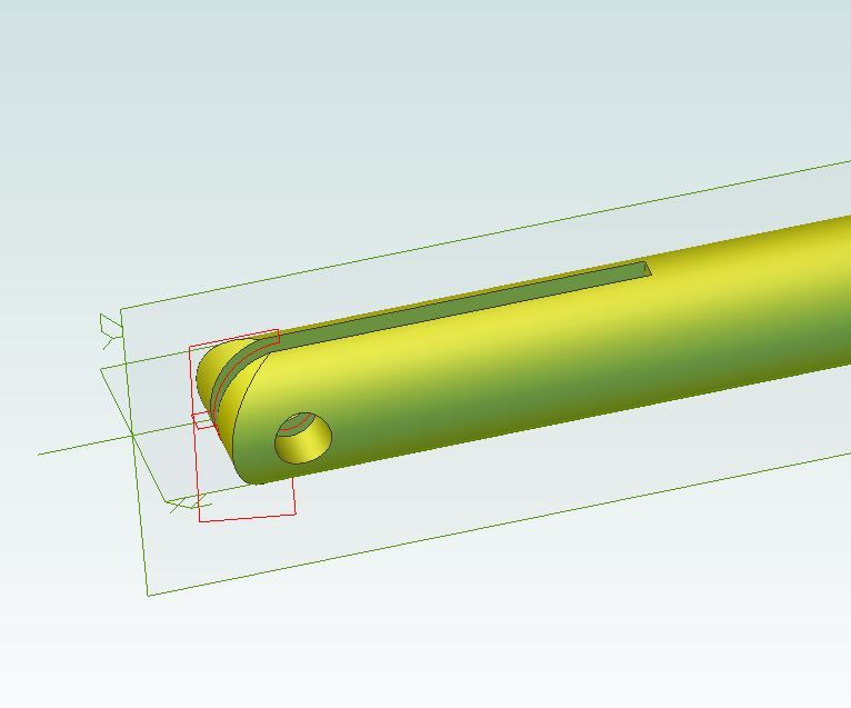

      Chris Gill
        @chrisgill22114
        I may be missing a trick, but …

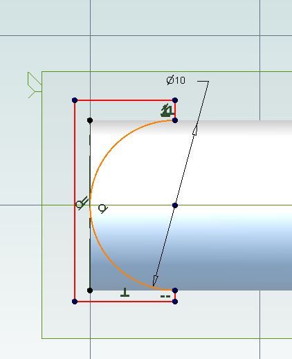

        I'm trying to model the top end of a piston rod. It consists of a cylinder with a slot cut most of the way along its axis. Then it has a hole drilled (extruded) through near the top. All OK so far.
        Finally I want the top to have a half-round profile when viewed from the cross-hole side but square when viewed from the slot side. I've tried chamfer and fillet but, of course, they apply all the way round the edge. Is there a straightforward way to do this? Or do I need to create the top using separate sketches and extrusions?
        Thanks
        #389900
          Chris if you draw a circle on the plane you want and then draw a "box" as below which can be any shape and then trim half the circle away you get this shape
          You can now cut-extrude that through all which will result in this
          #389906
          Chris Gill
            @chrisgill22114
            Thanks Jason
            I was trying to think of a way to do that and kept getting it muddled up. That solution looks perfect

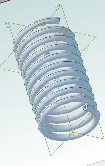

              You can do some really neat things with the helical functions once you figure out how they work. This a coil of 0.125"OD x 0.063"ID tubing centered on a 0.5" radius….

                    It is not a right angled pipe that Chris needs, he wanted to round over the end of a piston rod from something like a small oscillation engine so it would look like I showed above, complete thing below which is just a cylinder and then two cuts as the rounding can be done in the same sketch as the hole.

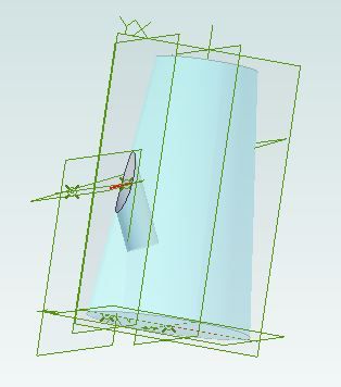

                                      Tomk
                                        @tomk39956

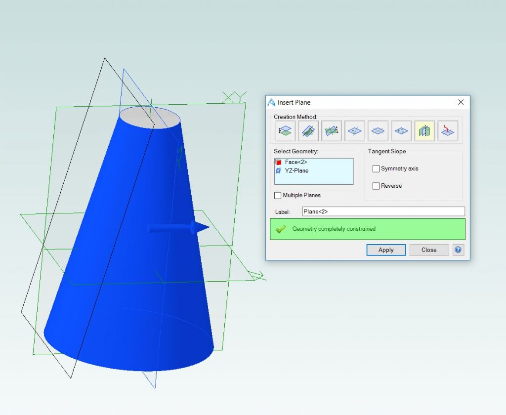

                                        Hello Been learning Alibre Atom3D. have run into a problem with creating a hole in a cylinder at an angle.
                                        Can anyone show me how to put a hole half way along a tapered cylinder at an angle of 25 degrees to the axis of the cylinder to a depth of half the cylinder diameter..
                                        Cylinder is 0.5" dia at larger end an 0.25 " dia at small end.
                                        Thanks
                                        Tom

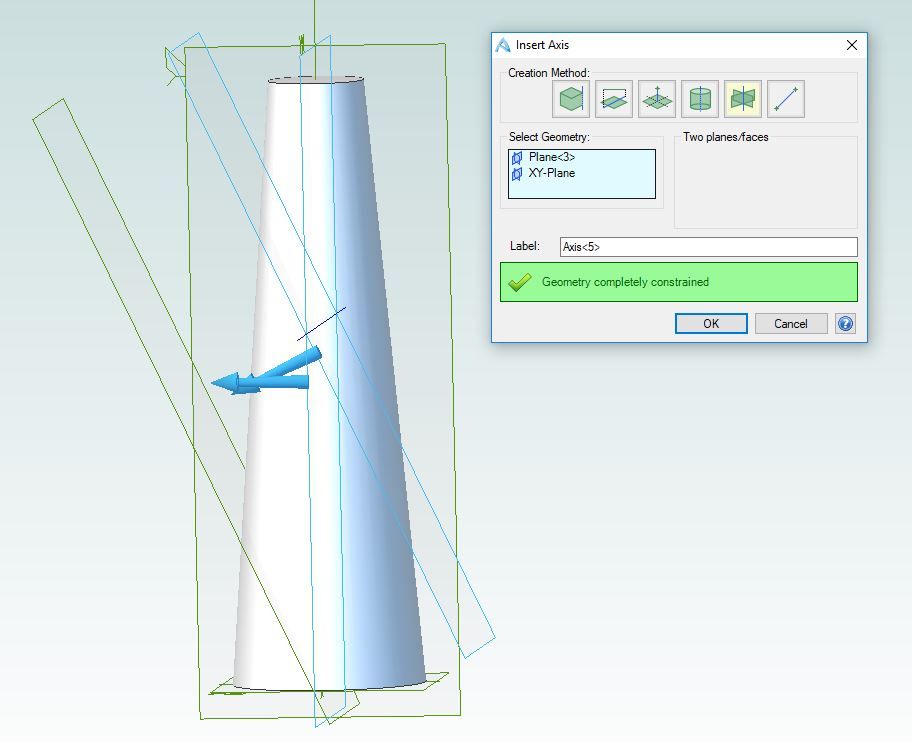

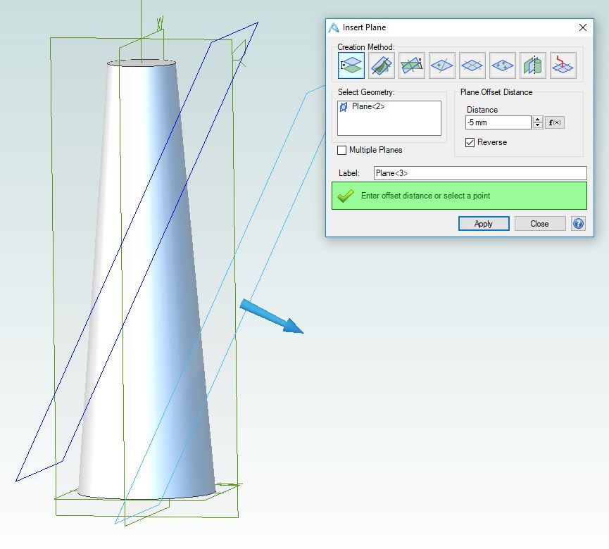

                                          #390462
                                          David Jupp
                                            @davidjupp51506
                                            Tom, you'll need a plane to place the sketch for the hole on, so first task is to insert a new plane, at the correct angles to give required hole direction (there are other options to set the cut direction). There are several options for relating new planes to existing geometry (in the insert Plane tool). Sometimes it can be easier to insert a new axis first, then use that to help define the new plane.
                                            I don't follow exactly what you want to achieve – in terms of hole depth, you might find the 'to geometry' option useful in the extrude cut for the hole.
                                            #390463
                                            Tim Taylor 2
                                              @timtaylor2
                                              My bad – the above will create the hole at an angle relative to the tapered surface. Creating relative to the cylinder centerline is easier. If you draw the center around the origin, then the first step is to create a plane parallel to and offset from the vertical axis that passes through where the center of the whole will be….then follow steps thru 6…..
                                              Tim
                                              #390465
                                              Tim Taylor 2
                                                @timtaylor2
                                                2 thru 6…….can't type tonight….
                                                #390466
                                                David Jupp
                                                  @davidjupp51506

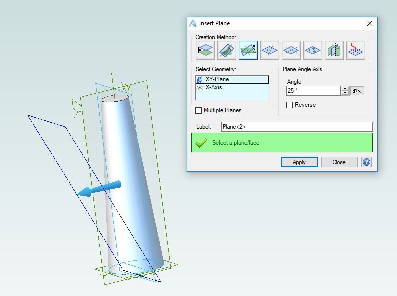

                                                  Tim, what I assume to be the first plane in your description can perhaps be created more easily – see image.
                                                  Apologies in advance if I mis-interpreted your method.

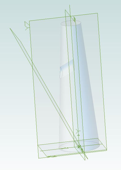

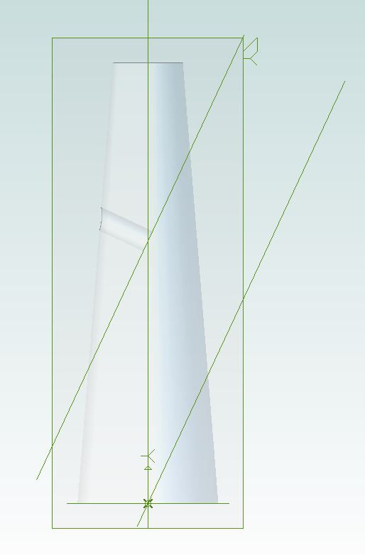

                                                  #390468

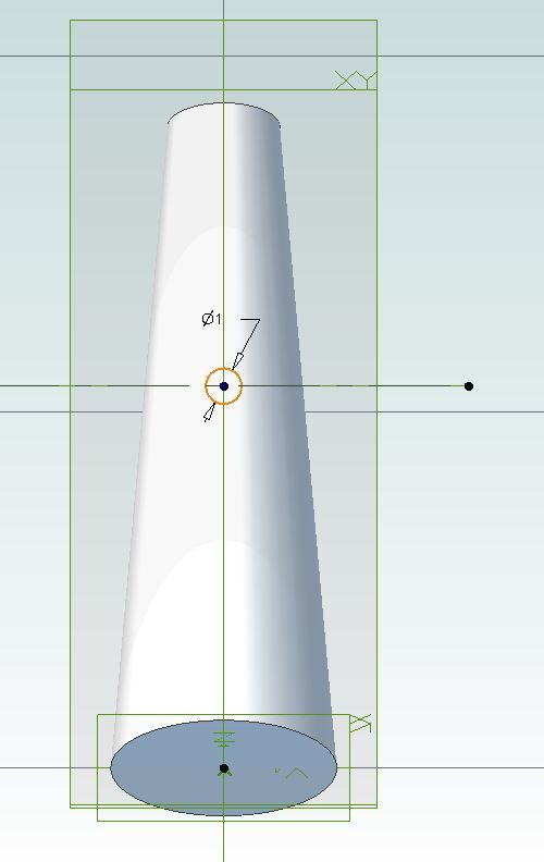

                                                    A lot will depend on how you want the hole to end , for a flat end I did this and Iassumed your hole angle of 25degrees is not the same angle as the slope.
                                                    Create a plane at 25degrees to the vertical
                                                    create 2nd plane where you want the hole to end parallel to the one you just created
                                                    To make it easier placing the circle create an axis where the two planes cross
                                                    Draw circle on 2nd plane using axis to locate

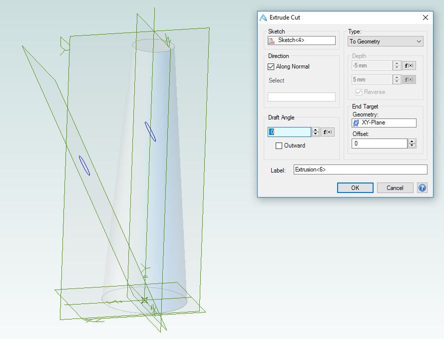

                                                    Cut extrude to beyond the outside of your cone. I have made the part transparent so you can see extent of hole
                                                    If you don't mind how the hole ends then just create the first plane and draw the circle on that and cut to vertical plane
                                                    result
                                                    Edited By JasonB on 11/01/2019 08:26:49
                                                    #390471
                                                    Tim Taylor 2
                                                      @timtaylor2
                                                      David,
                                                      I think what Tom is after is something like this pic (transparency set so hole is visible)
