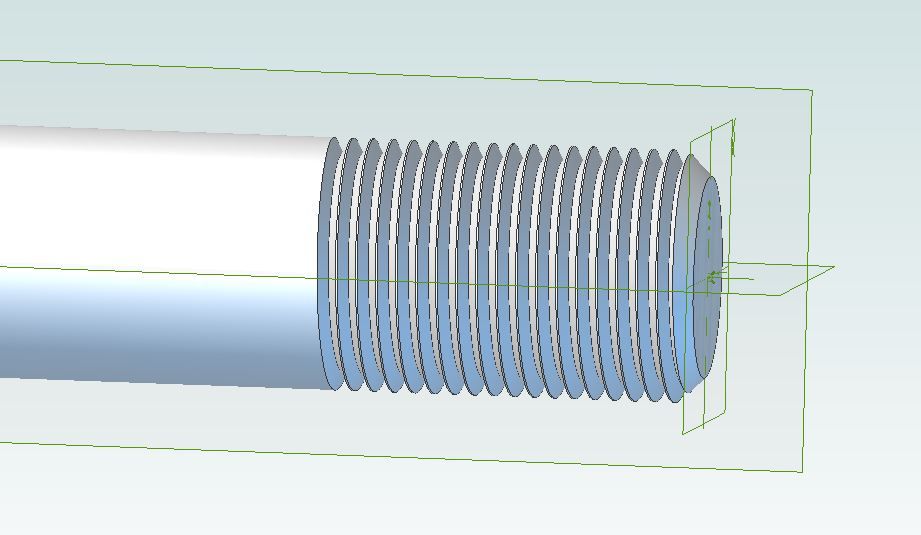

                                      #389787
                                        Easy way to get a neat entry and exit is to simply chamfer the hole or end of the cylinder first. Just like real machining where you would clean up the hole with a CSK bit and cut a chamfer or use the file to clean uo the end of a screw.
                                        I would be very wary of altering the pitch to get a "nice looking" thread particularly if you later want to 3D print the part as your thread won't be correct..
                                        Edited By JasonB on 07/01/2019 07:08:08
                                        Edited By JasonB on 07/01/2019 07:11:19
                                        #389788
                                        Tim Taylor 2
                                          @timtaylor2
                                          Yep, that would work as well……….need to set the chamfer equal to or greater than the depth of cut, correct?
                                          #389789
                                            Yes as you would when doing it with metal.
                                            #389791

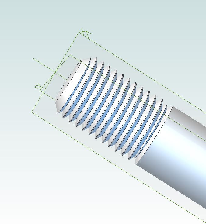

                                              #389792
                                                You can also get a visually pleasing end to a male thread by drawing your profile part way along the shaft where you want the thread to stop. You then use that sketch to do a circular cut all the way around the cylinder which is in effect a run out groove just like if screwcutting the thread. Copy and paste the profile sketch and past it as a new sketch or use "project to sketch" then use that for the helical cut.
                                                #389864
